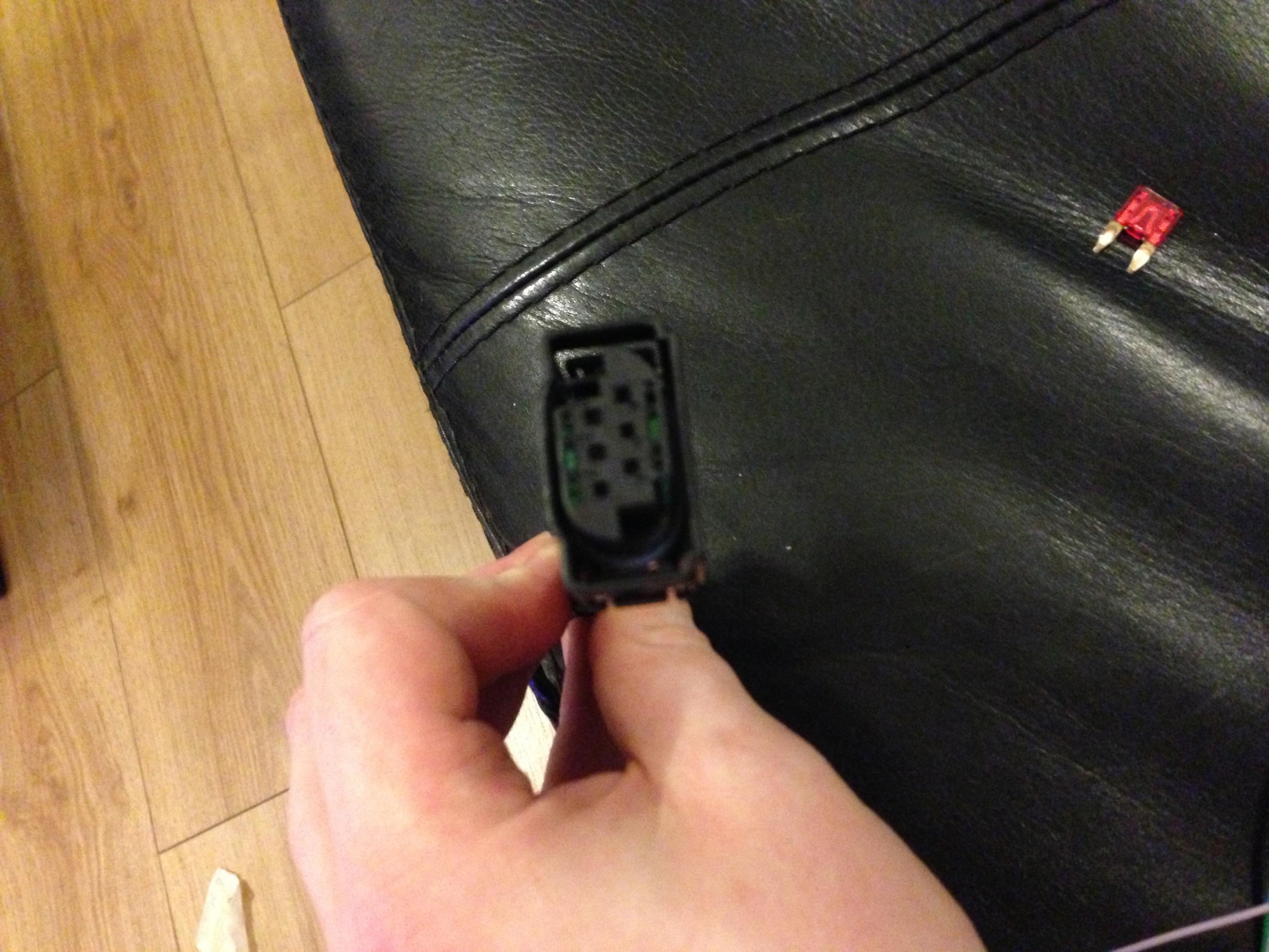

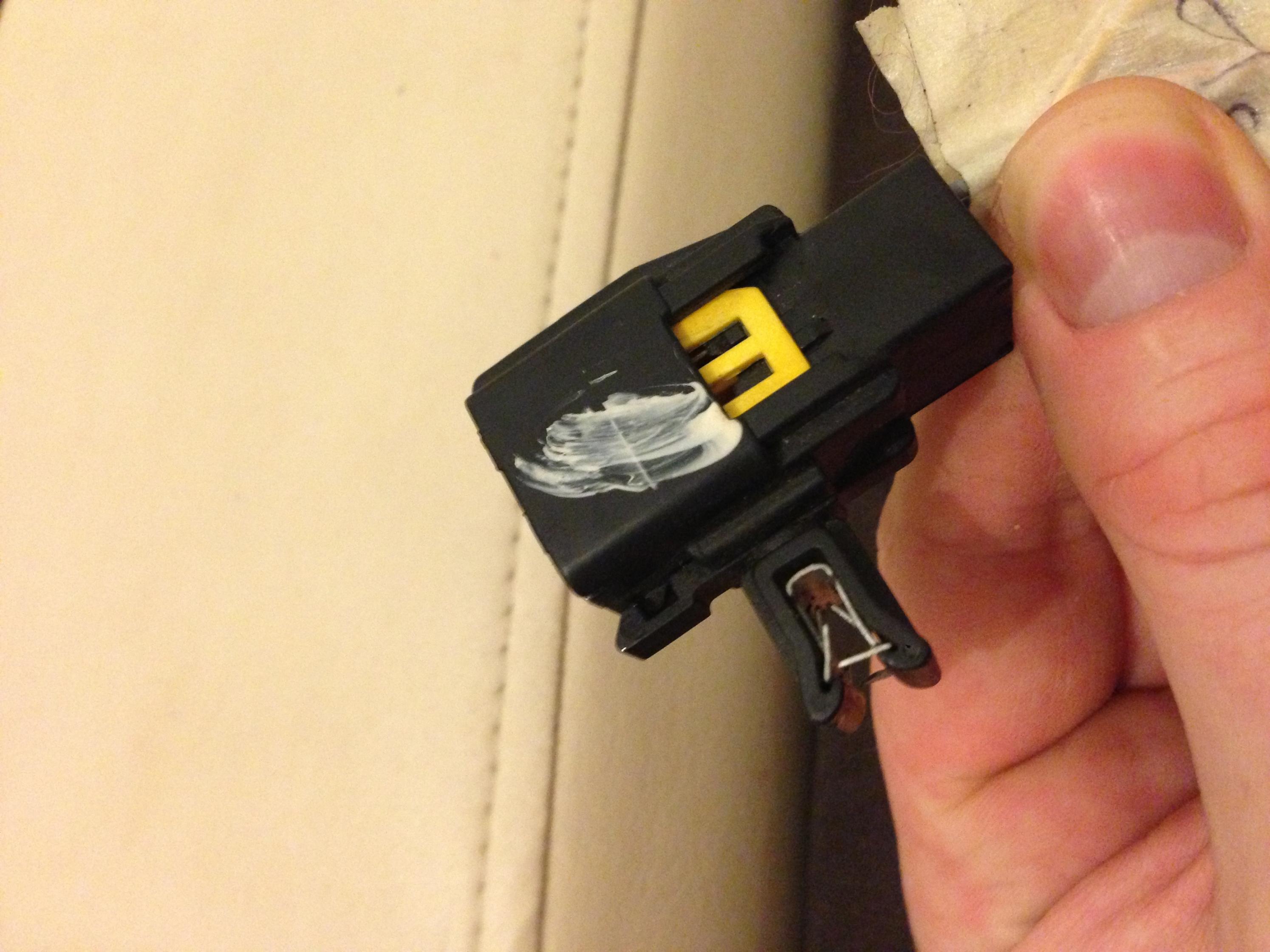

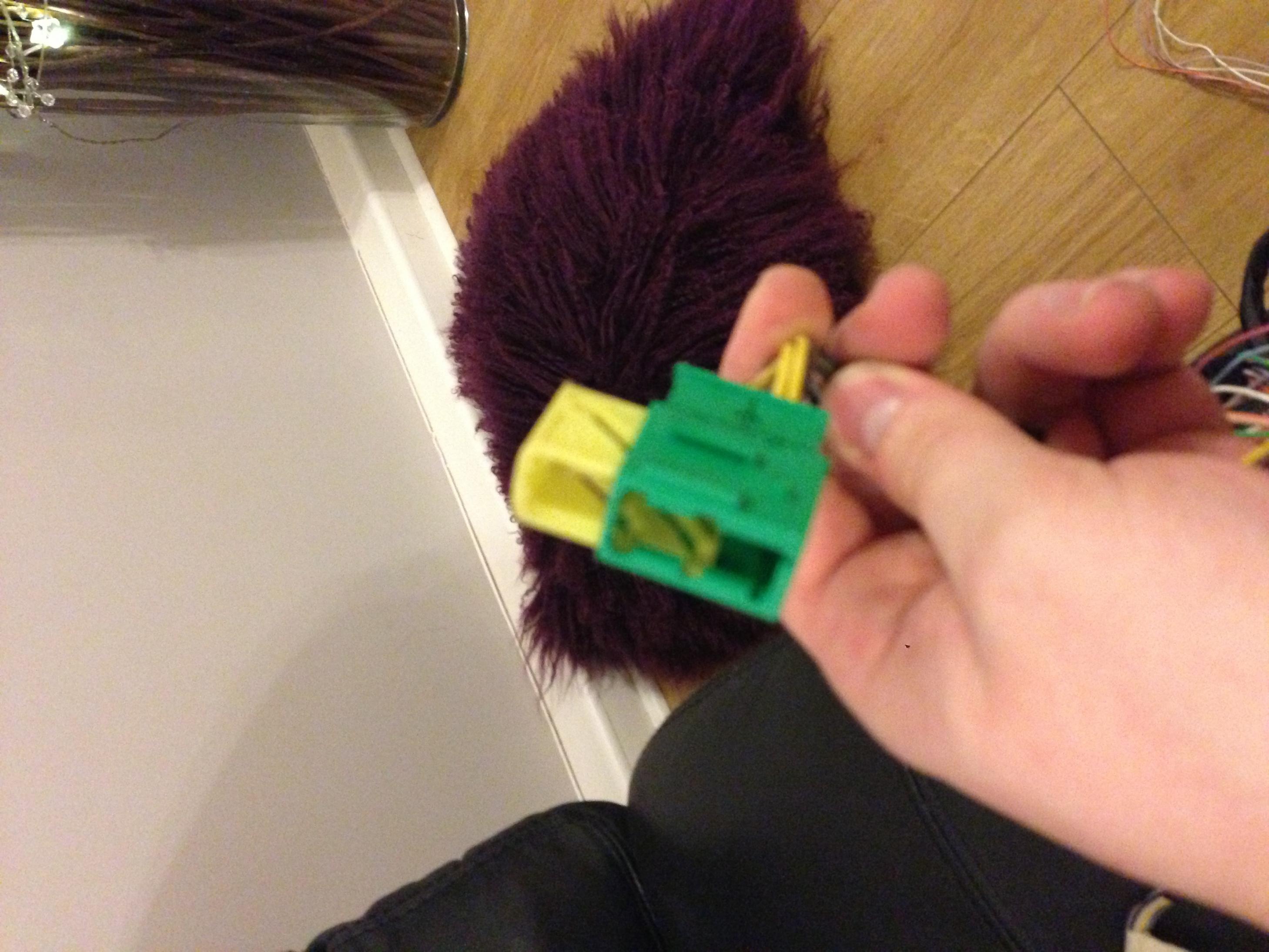

I've removed my interior loom to fit my roll cage and I have a few plugs which weren't marked as I think they were unused.
The first is from somewhere near the seats/centre console.
The second is the top left of the dash, I think it's the connector for the front roof loom.
The third is around the glovebox area and I think is the cd changer plug.

Donny_Dog
  Jim's rejects
Would agree, No.2 airbag.
The steering wheel one has a similar clip system.

Having traced some wires back, could number 3 be for factory fit Satnav?
Number one is the ABS/TCS module.
Usually bolts onto a bracket between the handbrake lever and the gear surround.
Part number is 8200074266 if you want to google it for some pictures.
len_beach
  E92 M3,172 track car
Thanks Adam.
I dont have TCS so that would explain why it was unused?
