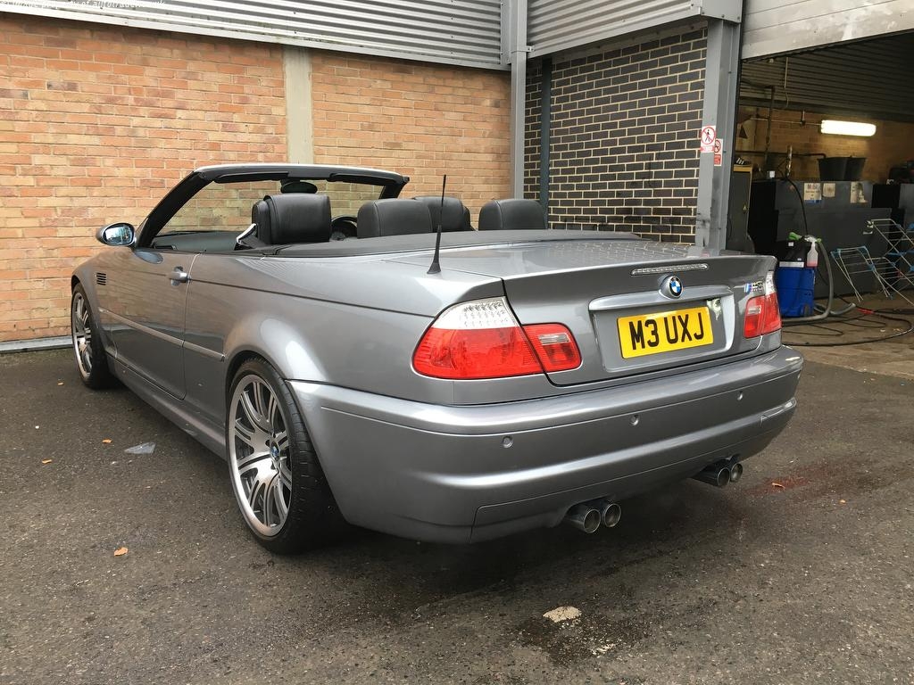

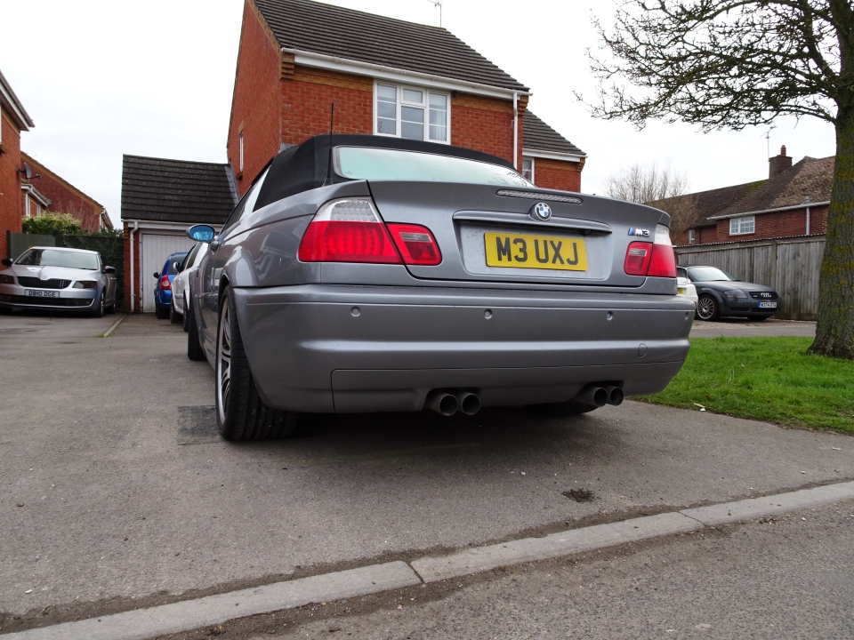

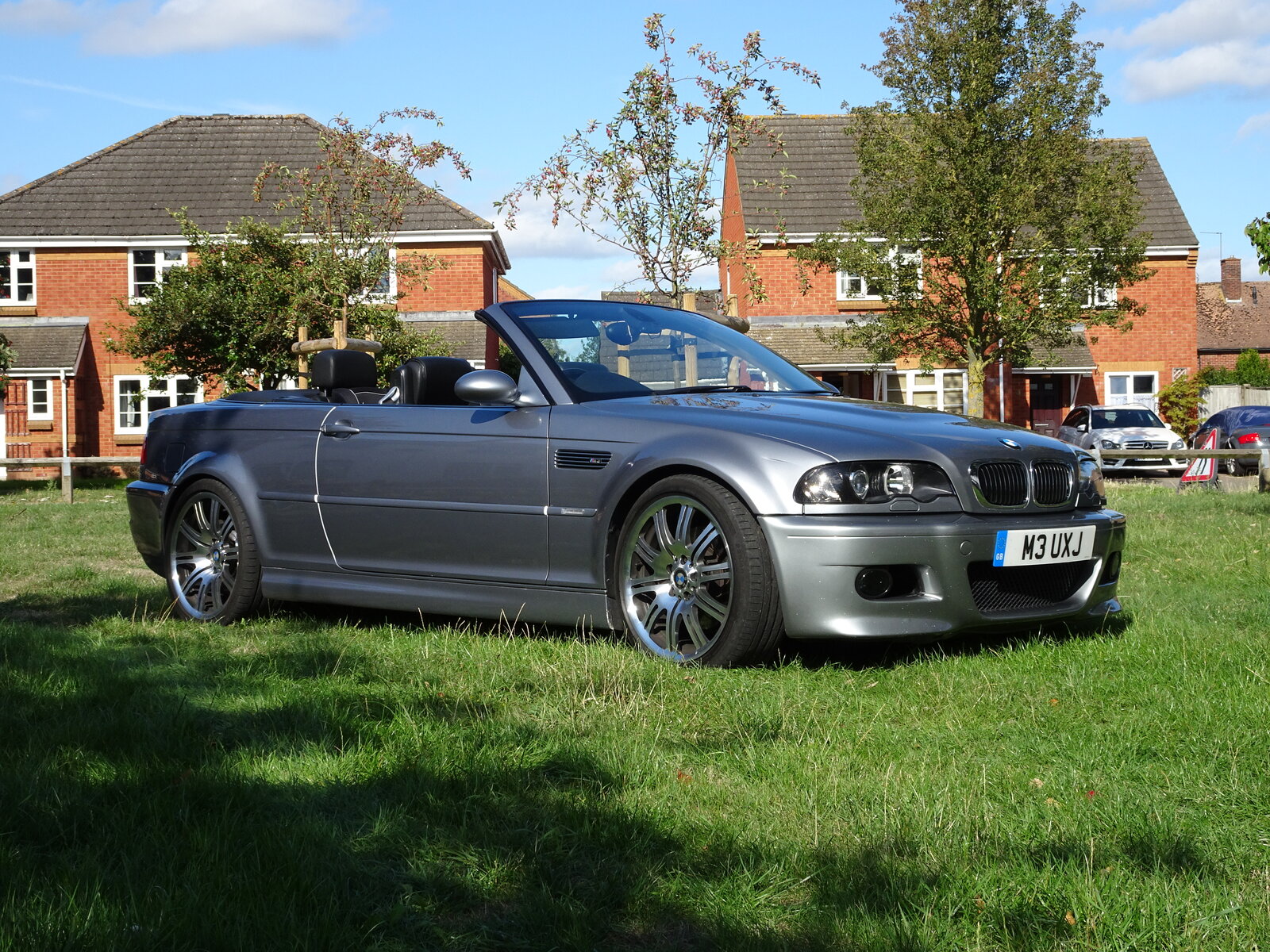

I have had spacers on my Clio and on my M3. The M3 has 20mm spacers on the front, vand it had 20 on rear but I widened the tyres so removed them as the extra 20mm of tyre filled the gap nicely. So if its just looks there are other ways than spacers.
20mm spacers with standard tyres
20mm spacers with wider tyres (Scrubbed like a b**ch)
No rear spacers and wider tyres.
