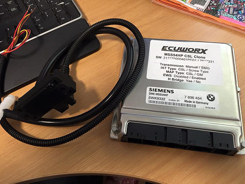

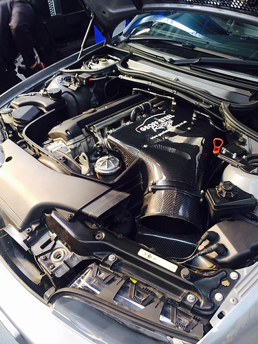

Full CSL cloned ECU, along with all the wiring and map sensor required. It was time to ditch the Alpha-N :smile:
Time to sort through all this...

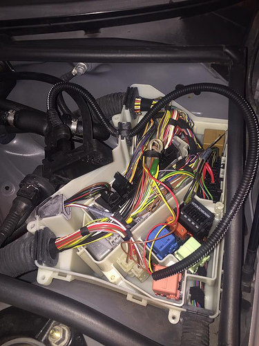

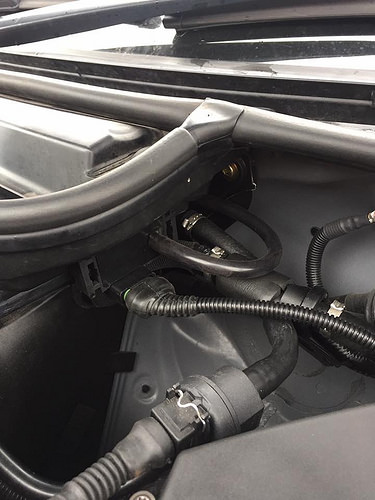

Then position and mount the new map sensor:
Initial feelings were good. I already had the car mapped with CSL rev-matching so didn't feel too much of a difference, but it seemed very strong all the same.
Over the next few days I started having issues with the car cutting out approaching junctions. This was down to the map sensor wiring and one of the guys on Cutters was a massive help and a rewire sorted it all out.
That niggles didn't end there, though. Cold mornings the car was idle hunting, was seemingly starting to struggle with power (I noticed, no one else could) and was a bit "pop and bang" friendly causing rattles through the exhaust system on the underside of the car. To passers by, it sounded very unlike an M3, in all honesty. More like a noisy mess - at least until the car had warmed up.

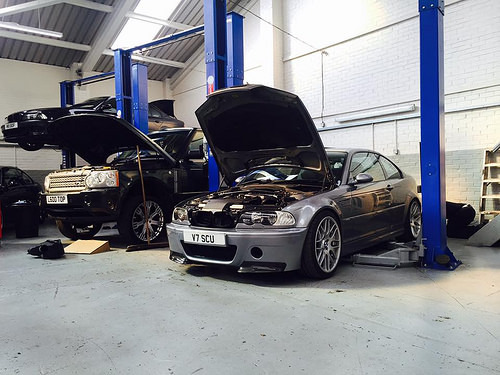

It was that far out I was out of the tolerance range to even have reset the adaptations. Although, in fairness, as it was running the CSL firmware now I was only actually .7degrees out of tolerance. Still, that was enough to make me want to stop driving the car and book it in for timing adjustment. As the car required an Inspection 1 service in 1.4k miles, I decided to ring around and get it booked in early for this and the timing. Got a mixed selection of quotes but Steve @ Mr.Vanos was by far the best, and as he was the expert on Vanos rebuilds, I actually booked the car in with him for the Inspection AND a rebuild of the Vanos - purely for my own sanity. I also had a set of NGK plugs and Bosch coilpacks to go on the car, as well as a headlight leveling bracket I'd had since I bought the car along with an air-con belt and new drive belt. So I left the car a week and then travelled up/across from Cumbria to Darlington on Friday just gone.
Steve was out collecting his new F10 M5, so I was in the company of his mechanic, who was very chatty and certainly knew his BMW's and engines. Very, very refreshing. I said I didn't even know if the Vanos was an issue as I just wanted the Inspection and timing done, but when he started the car he said immediately, "Yeah, that's the noise." so I was quite relieved and frustrated at the same time, as the "rattling" noise wasn't even that bad, to me.

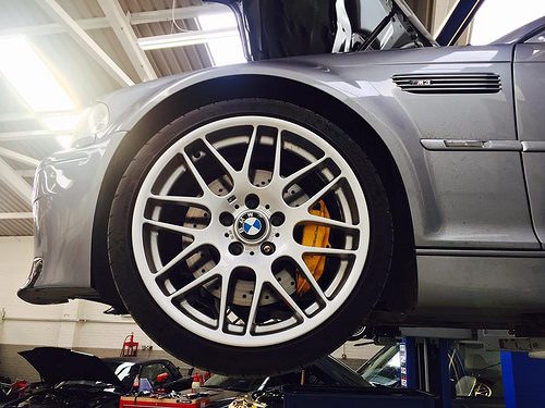

So in the car went and he set to work on it straight away, draining the oil and looking the car over.

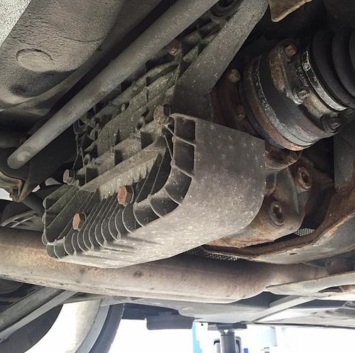

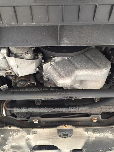

He called me over and told me to look at the diff. I asked what was wrong with it and he said, "Nothing. It's bone dry. That is a very rare sight."

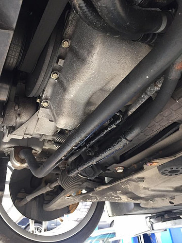

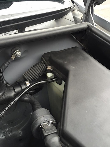

He then commented on the overall condition of the underside, stating the hoses were dry, no marks at all all the way to the front of the car with the engine tray off. The ONLY fluid leak from anywhere was the power steering hose, which I've known about for a while. Shown here:
Just need to find a place that can make me another piece up, as I'm not ready to pay £230+ for a replacement OEM part just yet.

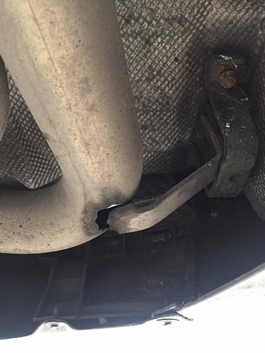

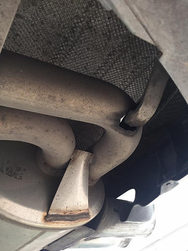

One thing that was picked up, and he knew straight away, was this:
That's a hole in my Supersprint Race 304 Stainless backbox! Coincidentally I'd been in touch with Supersprint over the last month or so about the length of the tailpipes on one side of the box compared to the other side, and negotiated for them to send me out a brand new box from their manufacturer in Italy, free of charge. Apparently one of their jigs was damaged and as such "faulty" backboxes were sent out. These faults included tailpipes being different lengths and also hanger discrepancies. The latter contributing to the lovely hole there which would then explain the noise and clatter I was getting from the car, especially in the mornings! So my new backbox should be here in the middle of April, and I then have to send my old one back to them, carriage paid for :smile:

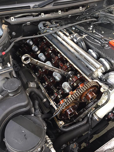

Next up, engine strip:

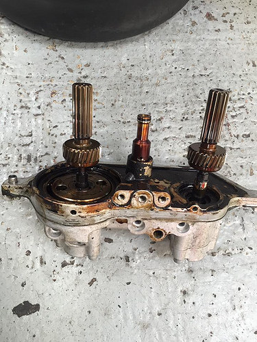

The mechanic noticed a little bit of play in the timing chain. Not a lot, but more than there should have been, so the Vanos system wasn't working 100% as it should.
Vanos removed:
That was the work for the day, as Steve hadn't returned and the Inspection 1 couldn't be completed until the engine was completely cold. So I stayed at a Travelodge for the evening and returned on the Saturday at 12pm and everything was back together:
The car was started up and the first thing I noticed was how quiet the engine bay was. No rattles or noise at all other than the belts spinning. Incredible. What I believed wasn't an issue in the first place I couldn't even hear any more! :smiley: Few blips of the throttle and the airbox did its job at sucking in huge amounts of air. I certainly heard that!

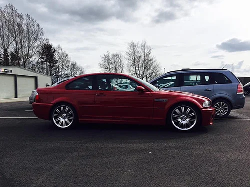

This car was so clean and tidy. Only done 60k miles and going up for sale next week:
Nom nom nom:
Gally
Ultimate M3 stuff Neil. The CSl thing just makes it the cool modified M3.
How rare is that Red M3?
  UR R26R.5, VW Golf R
It's a 2002 but has all the vital stuff done. Only 60k miles, rare colour combo and they reckon they'll easily get £12k for it.
