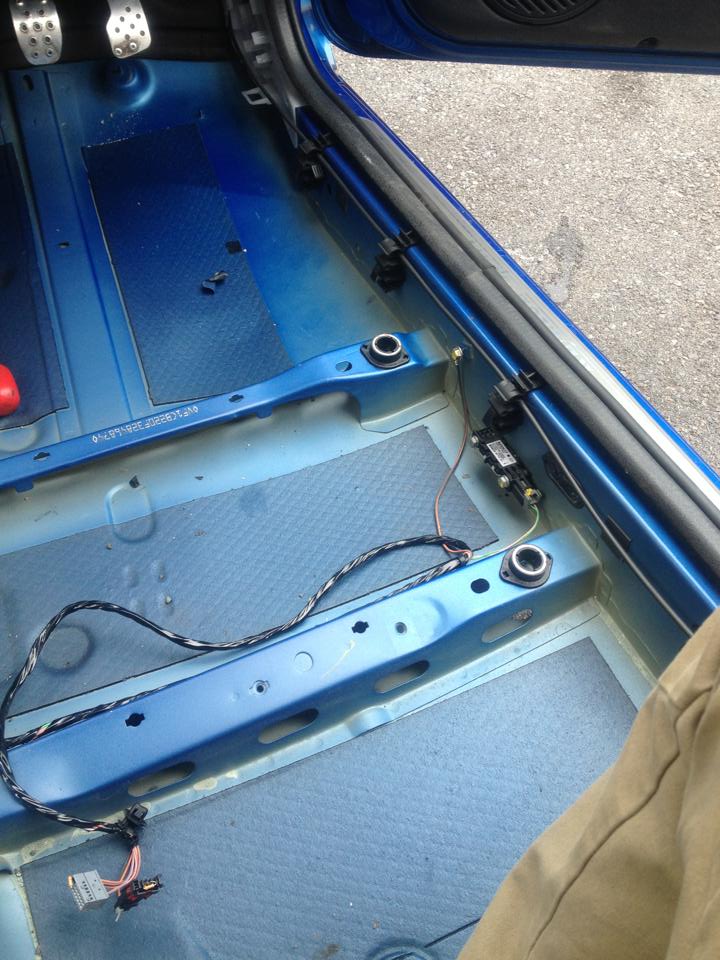

stripping my car and trying to get the wight down as much as possible, wich leads to the question ''what can i get rid of''
wiring that is obvious to me is the speaker cables and radio cables, as well as the Aeriel
so what else can i remove without getting really technical as im by no means an auto electrician far from it
can i remove this?
also can i remove the door closed switches or will i constantly get the beeping saying the door is open ?
thanks in advance

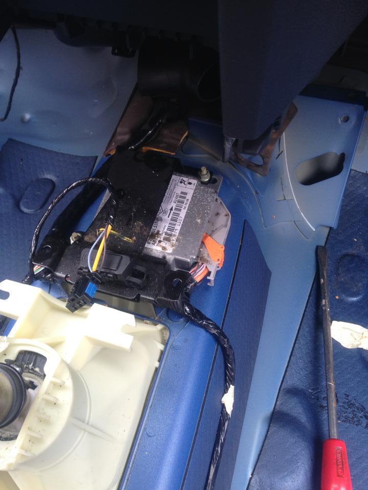

the items you have pictured, you can unplug and remove the sensors and brain.
all I did was then coil it all up under the main dash and secure it where the passenger side airbag used to sit, then for peace of mind re-attached the main earth points to a new earth behind the dash aswell.
