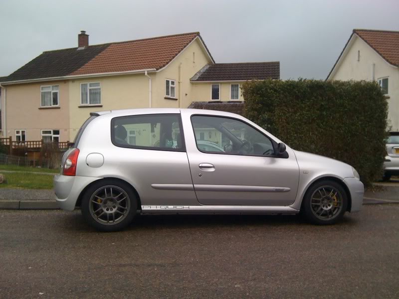

hi, ive just purchased myself a phase 1 clio 172 and was wondering what expert opinions on choice of coilovers to buy. personally i would like to be able to drop further than 40mm. what coilovers are most people buying for there phase 1's and how much do they cost.
also would it be possible to see pics of 172's with coilovers so i can get some idea how i would like mine to sit.

Konigsports are about £700 from Venom Motorsport. They've done very well on track. They have a lot of height adjustability and the dampening is very vast too from very soft to very hard! They do the job without spending an extra £3-500
