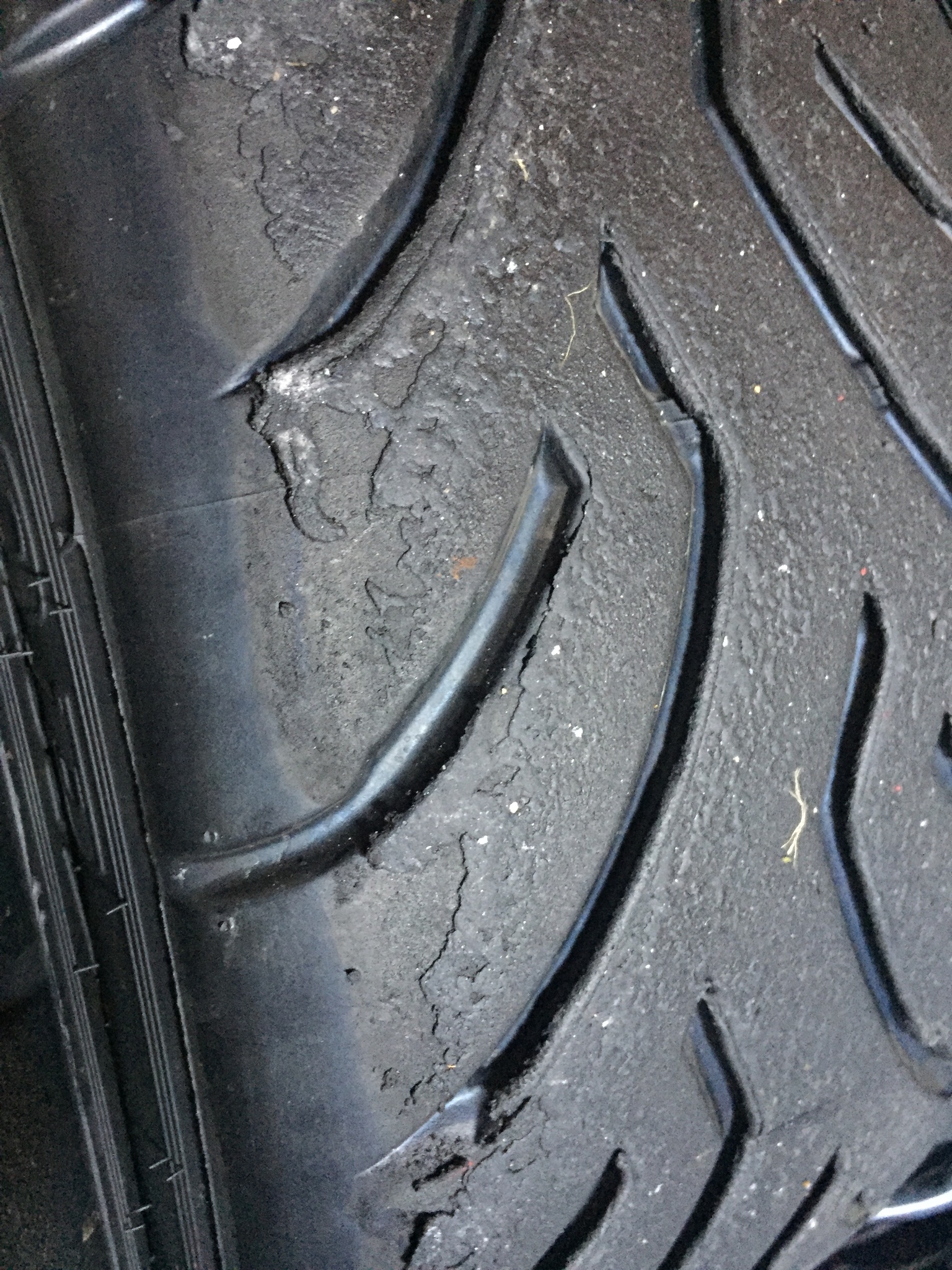

Inside edge of one of my rears, the other is very similar, notice the lack of use!

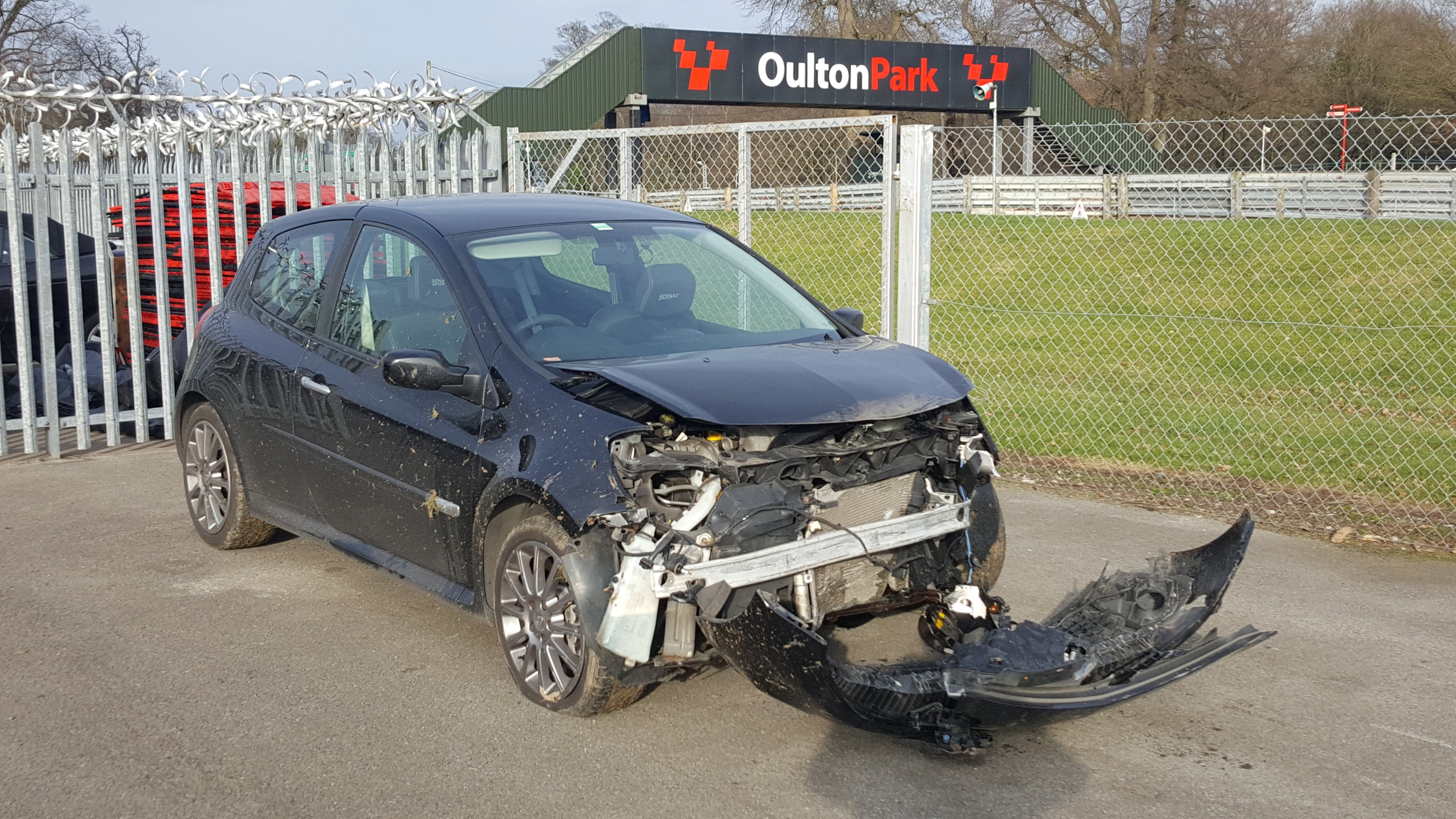

Could be worse, this was my 197 last year. Lift off over steer at Oulton Park, Island bend. Armco 1 - Clio 0.
