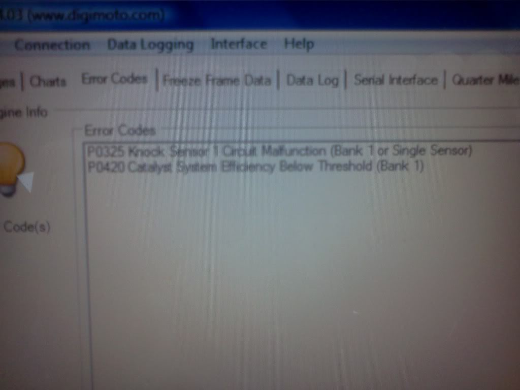

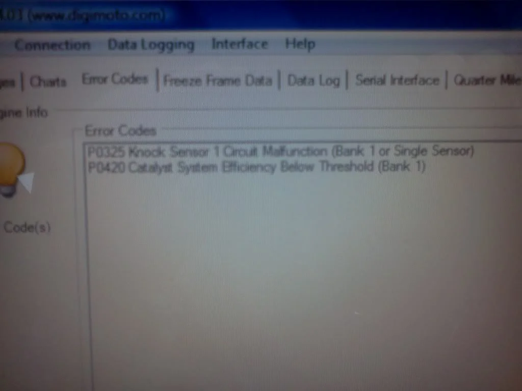

nice one cheers, will that explain the diagnostic check i did with my laptop 4 months ago? I had the orange engine light come on boxing day 2010, will this switch off now after a few miles
Ok I'll try clearing the code tomorrow. Its not decatted no (afaik anyway), it passed the MOT on thursday although it did fail the first emissions test but passed the second two after a 2 minute warmup according to the testing guy
I've just hooked it up to my laptop and the knock sensor code had cleared itself. Also managed to manually clear the p0420 code and switch off the orange EML which i couldnt do before so hopefully all problems are now sorted. Not that there was any running problems anyway, just worrying seeing the light on the dash all the time.
