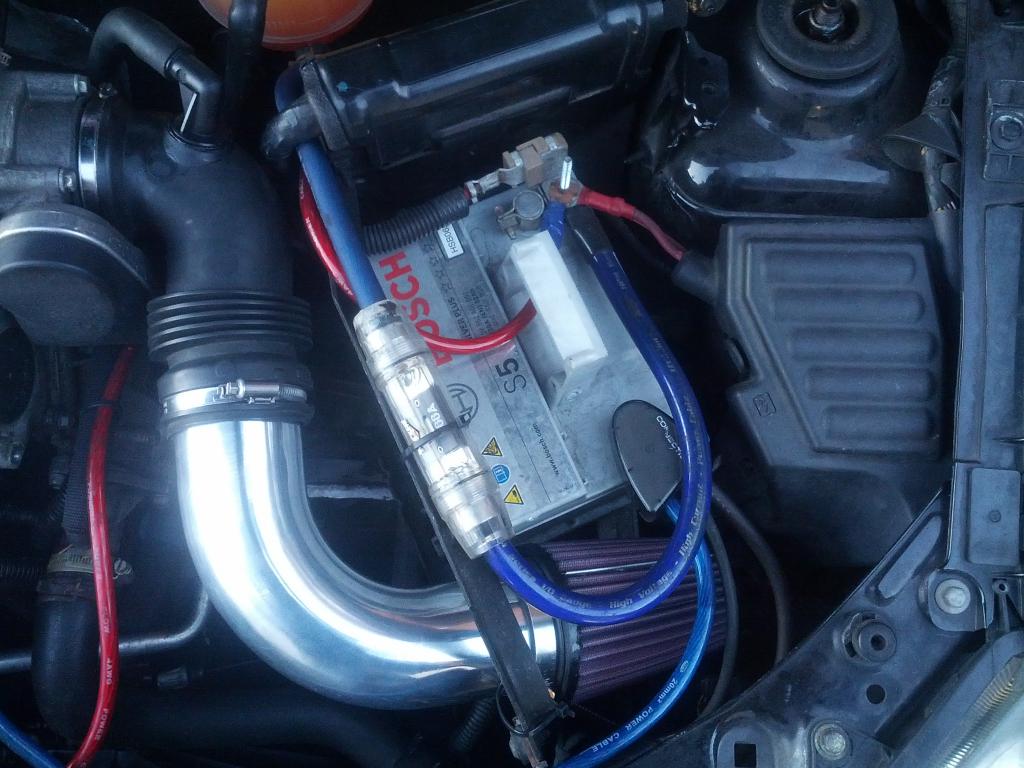

right so got it all on and together. Will that cone filter be a bit restrictive, it looks a tad smaller than the "twin cone filter" people use.
also, has anybody got any ideas as the what would be the best way of securing it in place as because the standard elbow is flexable the cone is bouncing all over the place, ive currently got a tie wrap stopping it moving but i want something a bit more permanent

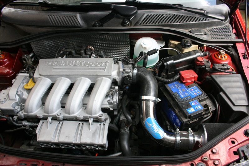

This is what i had on my ph1.
Need- 70mm id 90' silicone bend, 70mm od 90' metal bend, 70mm joiner/coupler, 4 x jubilee clips and 70mm ITG Ram Filter.
Cost under £80.
