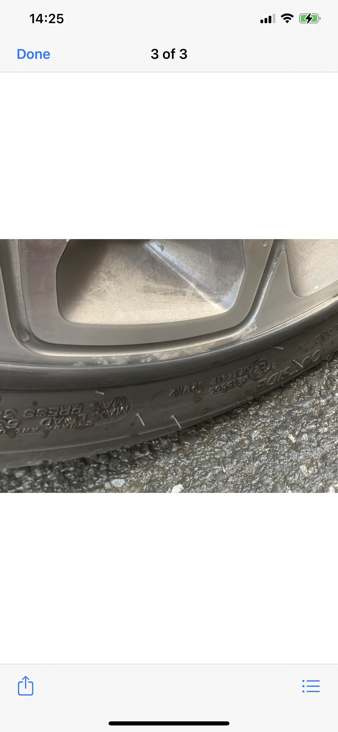

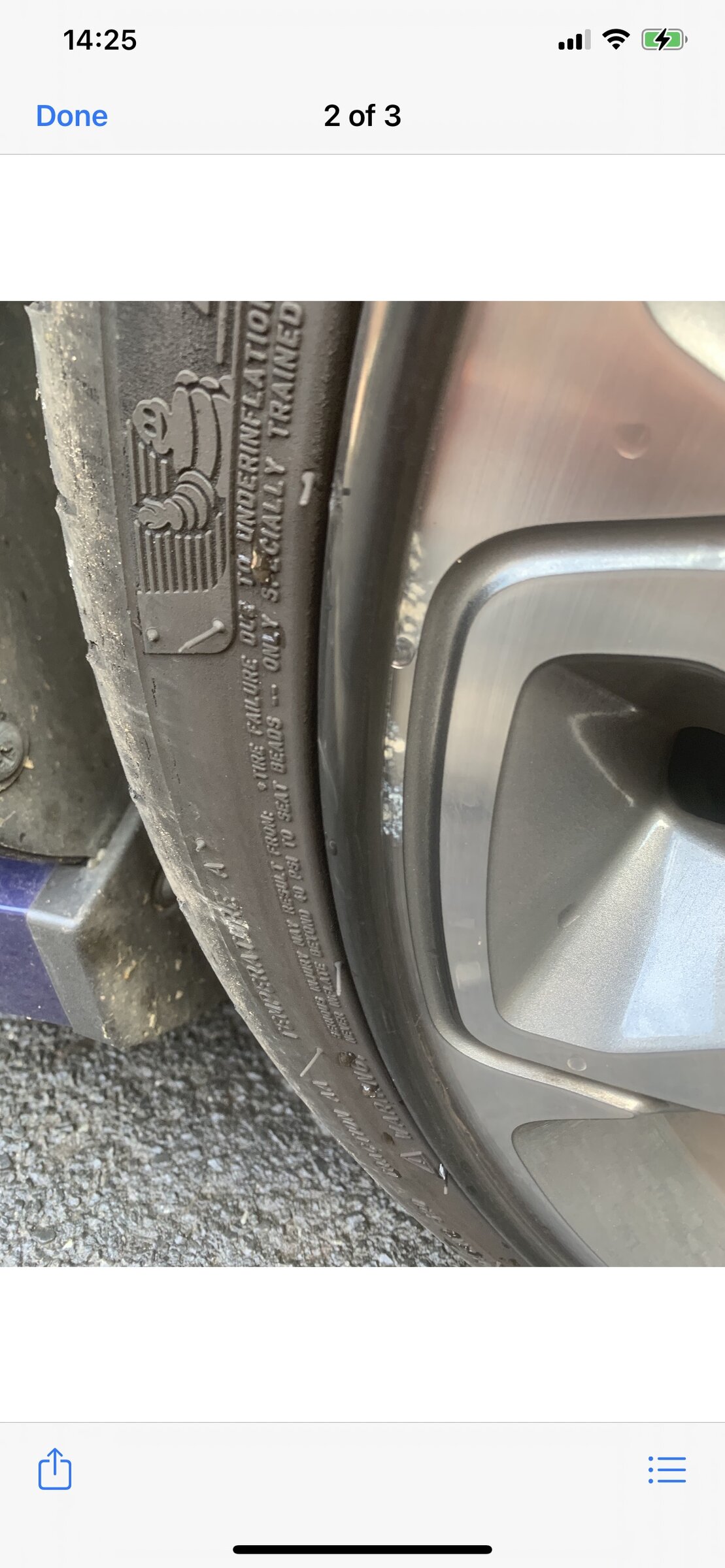

Hi, my nephew has got in touch and asked me what this is on the alloy wheel. It’s just on 1 of the rims. He also has the Alloy Gators on all 4 of the rims, he says he only noticed the issue past couple days and doesn’t think it was damaged when the gators were put on.
here’s a couple of pictures he sent me.
frayz
Those wheels are finished with whats known as a "diamond cut face, where the finish is cut back on a lathe to bare aluminium that is then lacquered. Thus giving you the high lustre finish on the face.
The clear coat has been punctured and moisture has gotten in to the bare alloy causing it to go white and furry under the lacquer. This is very common if you get a stone chip on diamond cut alloys . Likely the rim "protection" has either broken the surface of the clearcoat or road salt/grit has gotten between the gaiter and rim and abraded the clearcoat through and allowed moisture in.
edit - No way would i ever fit those wheel gaiters and certainly not on a diamond cut rim. This was unfortunately a certainty and just a matter of time before the wheel corroded.

Diamond cut wheels always do this. Their doesn't even have to be damage to the clearcoat for corrosion to start. Have it refurbished but make sure it's a good place who have a lathe to skim the face properly.

Plus, the other chap might have fitted the protectors to cover up a few kerb marks - which is even worse for corrosion like this. Maybe alright if they were fitted from brand new.
Utterly zero chance you'll get any money from anyone for that. It was the previous owners decision to have them fitted and your decision to buy the car with them fitted... you could try to get some money out of your self by sending them to be refurbished I guess :)
If you do get them done don't let anyone talk you into having them re-cut, its expensive and not required if you catch it early like yours, could likely have them re clear coated...
