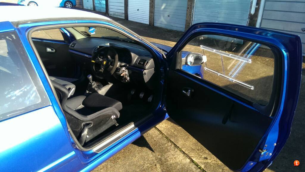

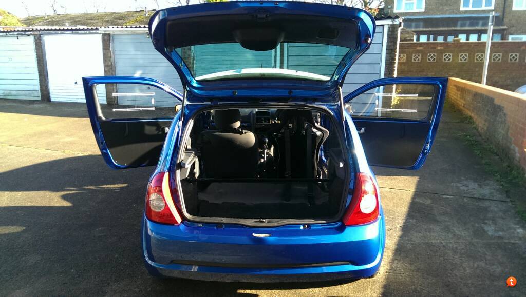

mattcreed barnesautos Removed the windows with proper cheese wire thatbsreen fitters use. To a minute or two a side to do. Fitting the rears was a bit of a pain as the Clio glass actually sits on a ledge towards the front of the quarter meaning there is a need for slightly larger build up of sealer. Once I noticed that it was pretty easy.
Also a little note... Remove all interior trims before doing the Windows. I am actually going to trim all the interior panels slightly as my Windows fit lovelly and flush in the holes and the interior parts would touch them.
The fronts were just slid in place there but where the channel is at the top of the door where the weather strip goes on the inside you can easily drill through there straight into the Windows and that will fix them very well. Also it will leave no signs of damage if at anytime you wanted to put the original glass back in.

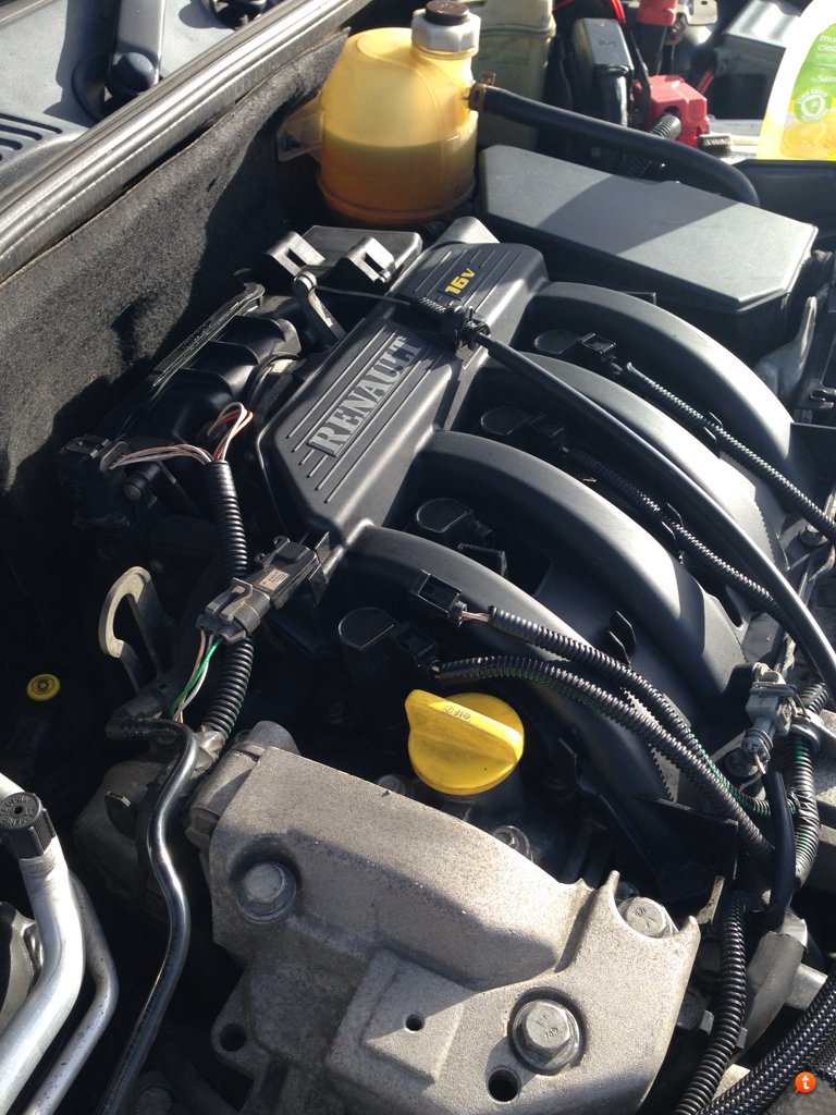

have the engine a scrub :)

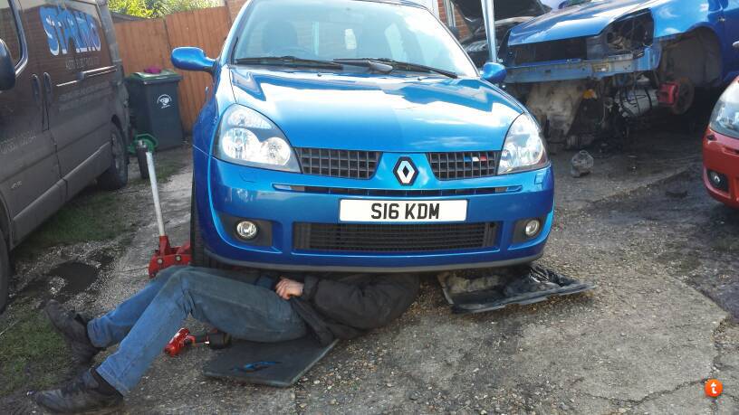

Clutch on the driveway. Started it on Saturday, weather put a stop to it. Wanted to finish Sunday, weather put a stop to it. Done bits on it a few nights this week but it's been a pain in the arse. Finally put it all back together on Wednesday night, wouldn't start, traced it back to a bad earth on the starter last night and finally got it running again.
Won't be doing that on the drive in winter again.
You poor sod - clutch outside in this weather . Nutter !!!

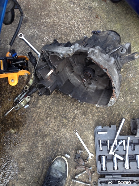

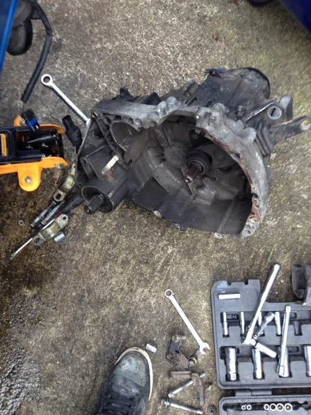

Gearbox out, time to order a new clutch then fit my other box back on. Nightmare of a job
