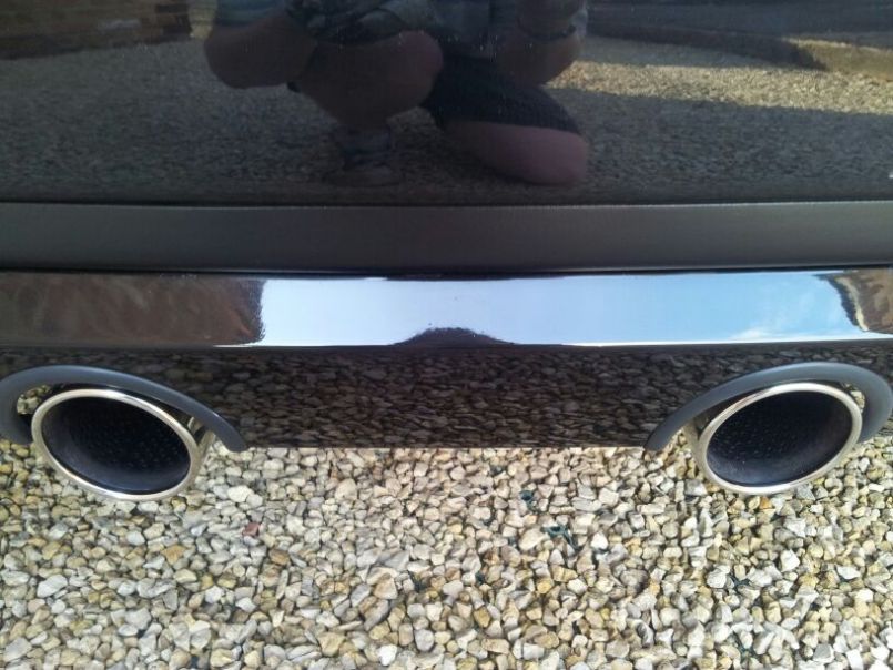

This... Again!

^^^ how hard was the trim to remove? Did it need much prep before painting?
Easy to remove mate. Screwdriver wrapped in a rag and I worked my way from the left to right popping 1 clip out then right to left popping a clip out till it was off.
To prep it I degreased it, rubbed it down with a bit of 2000 wet and dry (didn't have any 1500) then degreased it again and painted it. Put a light coat on first from about 30/40cm, then when it was dry put another coat on from about 20/30 cm, then waited for it to dry then put another 2 coats on waiting till each was dry.
Is that an easy enough job? mines need replaced badly also where's the best place too get them? Found them on fleabay but wasn't sure if would be better going too Renault too get genuine ones thanks
That's where I got mine from an they look decent enough! We'll soon see!
10 min job tbh though mate not too hard :)
