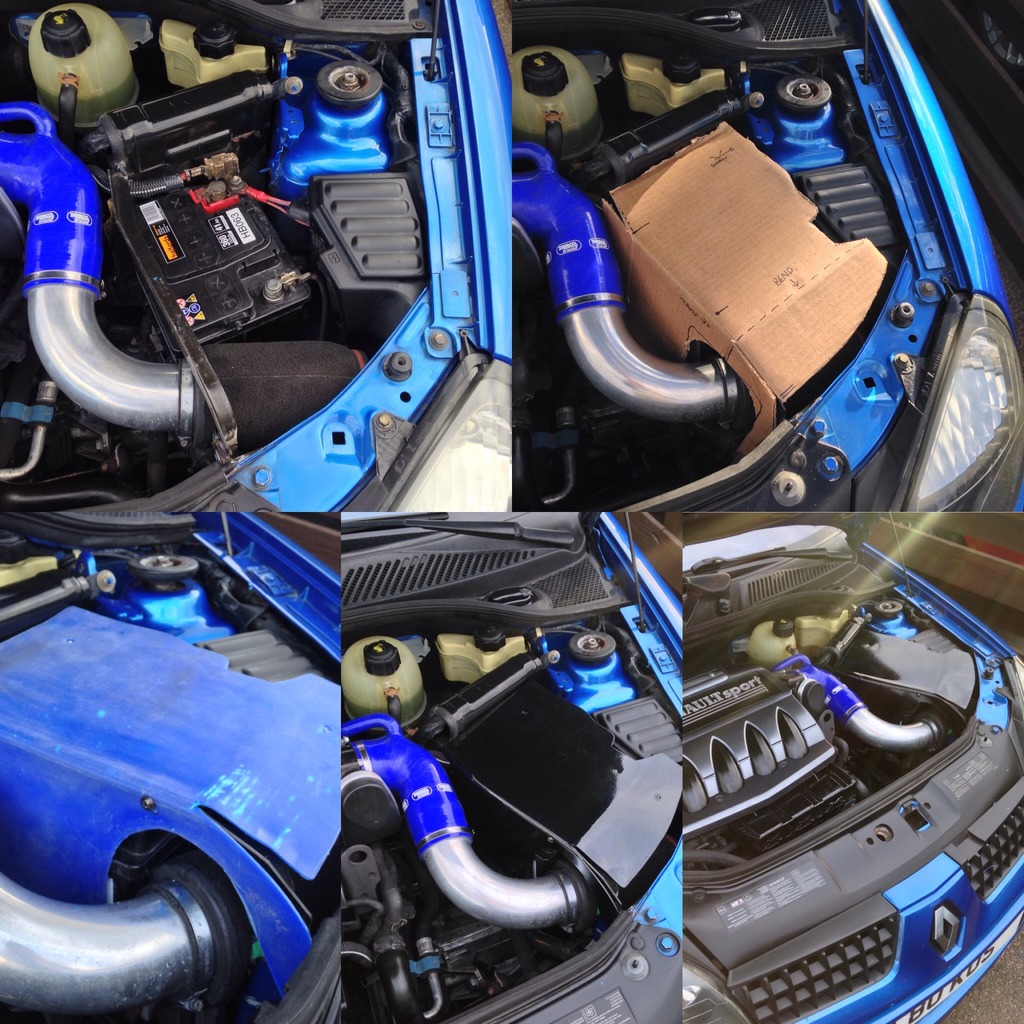

Moved battery to boot, moved the ecu not exactly where i want it but it will do for now gave her a wash and wax and got a few bits polished for my new engine build

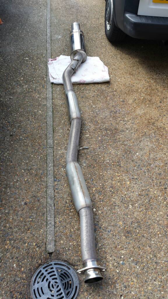

The car failed the mot due to emissions so I removed the decat and fitted the standard cat along with new gaskets and bolts etc.

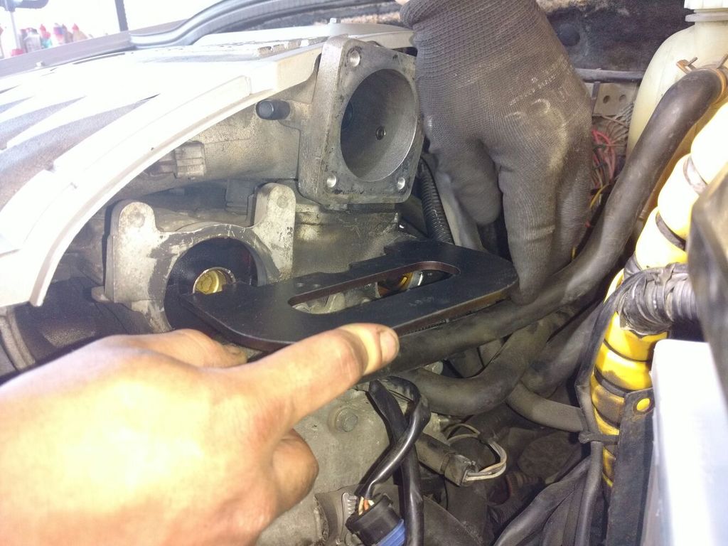

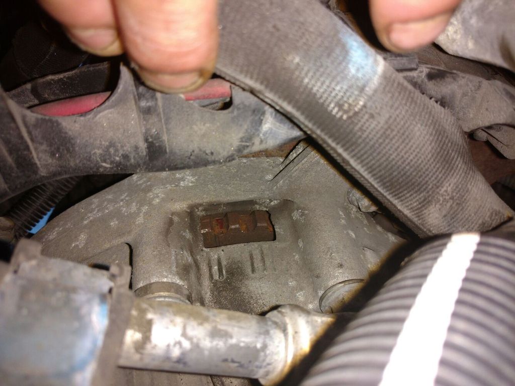

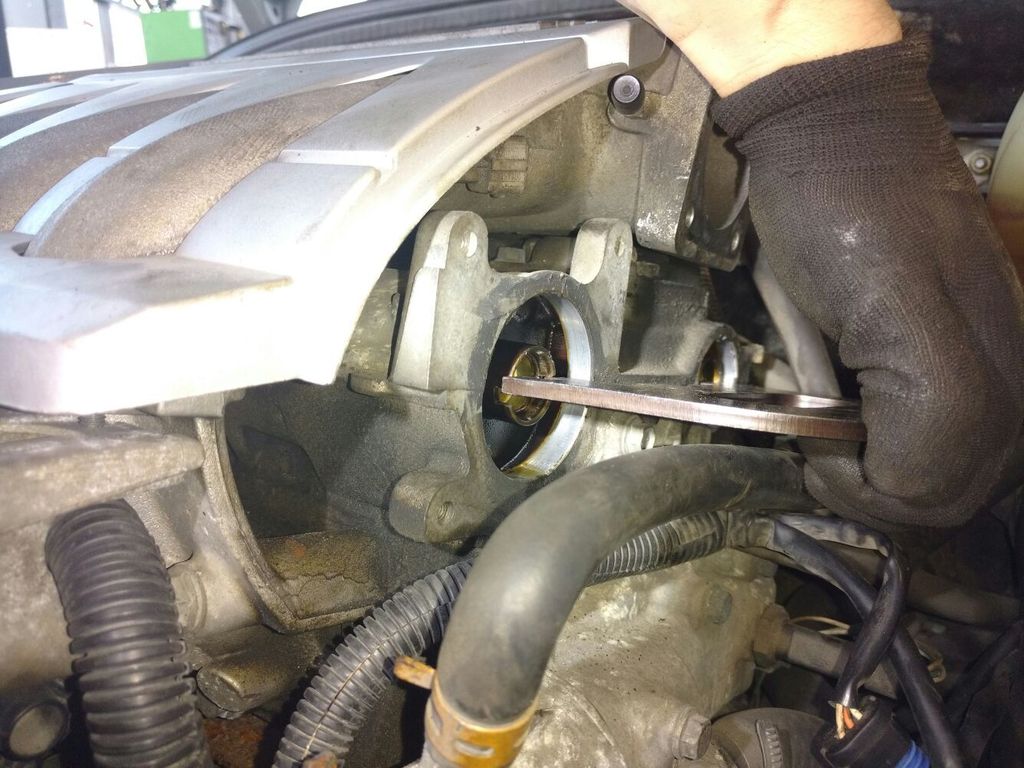

f**king hell just found out that my cam timing is out. Crank pin slots into the crank when the line in the flywheel is aligned with the 0-mark on the gearbox but the horseshoe doesn't fit in the cam slots. Its so badly out ouf alignment so even a blind man can see it without the horseshoe! GOD f**king DAMMIT way to go Finnish bosch car service...... Seems like everything has to be done by yourself......
I always had that feeling that something is not right......
Cam belt kit has been on the car since 15th of April this year. I guess you can't get away by just retiming the engine, i have to replace everything..........
On the other hand i'm happy because now i know there is going to be much more fun driving experience in the future......

Yes you can just re time the engine. [emoji2]
  Ph.1 Clio 172
Thanks Phase1sr!
Doesn't that require slackening the tensioner? I assumed that it's not recommended to tension belt that has been already tensioned?
Or is just a simple cam covers off, cam pulleys loosened then alignment with horseshoe and retightening everything. I have access to Vividworkshopdata on my workplace and timing belt replacement guide and all the tightening torques. And also aware of using the pulley immobiliser
It's late i'm tired and stressed, and angry.
But thanks again.
Mr R.
  A special one.
It should just be a case of loosing off the exhaust pulley (after locking the crank with the pin)
And then moving the cam into the correct position.
You may need to undo the dephaser as well, you WILL need the correct Renault cam pulley locking tool don't try and use the cam aligning tool.
  Ph.1 Clio 172
Yes. I don't know how to thank you enough you have been very helpful. What a relieve.
Don't worry. I am aware of everything that can go wrong with mis-using/un-using the crank/cam/pulley tools. I have access to tool set made by Gates via our garages part supplier, Finlands largest supplier ,AD Finland Oy.

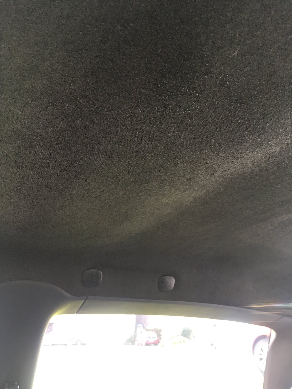

Stripped the interior of everything, prepared it an primered it
Was getting fed up of it looking grubby an the patches where the sound deadening was removed being a different colour. Just need to pick up the paint from being mixed tomorrow an i shall get it sprayed up

Trying to figure out whats wrong with cam belt timing which seem to (sounds crazy) change everytime it is checked. :eek:penmouth:
Day 1 as i posted pictures of the cam slots being incorrect by very much.
Day 2 timing was inspected, cam tool almost slots in to the cams
Day 3 crank/cam tools slot in PERFECTLY. :neutral:
All of these 3 times the flywheel mark was spot on!
This doesn't make any sense. Would it be an issue with the dephaser pulley not locking in correctly? Timing should be equally the same no matter how many times you spin the engine around. Dephaser does have a slight rattle when warm.

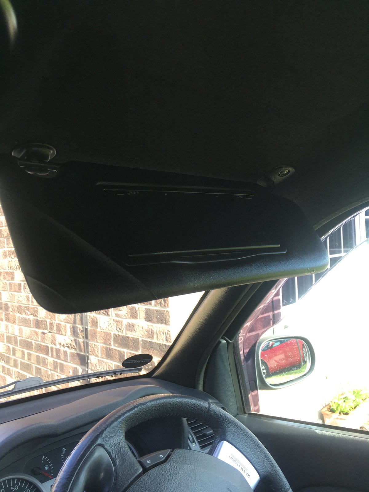

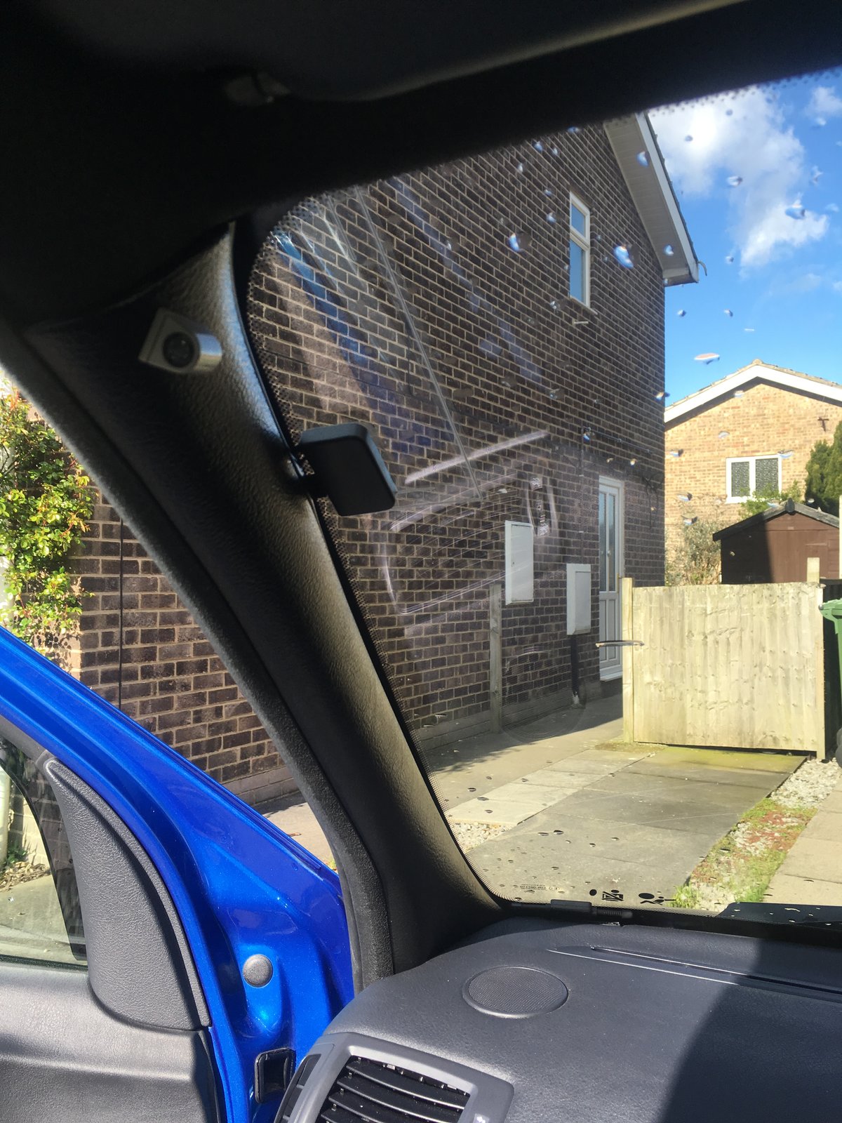

Fitted a sun strip - couldn't get it right so removed it. In hindsight the fitting instructions were bad and would have done it a different way
