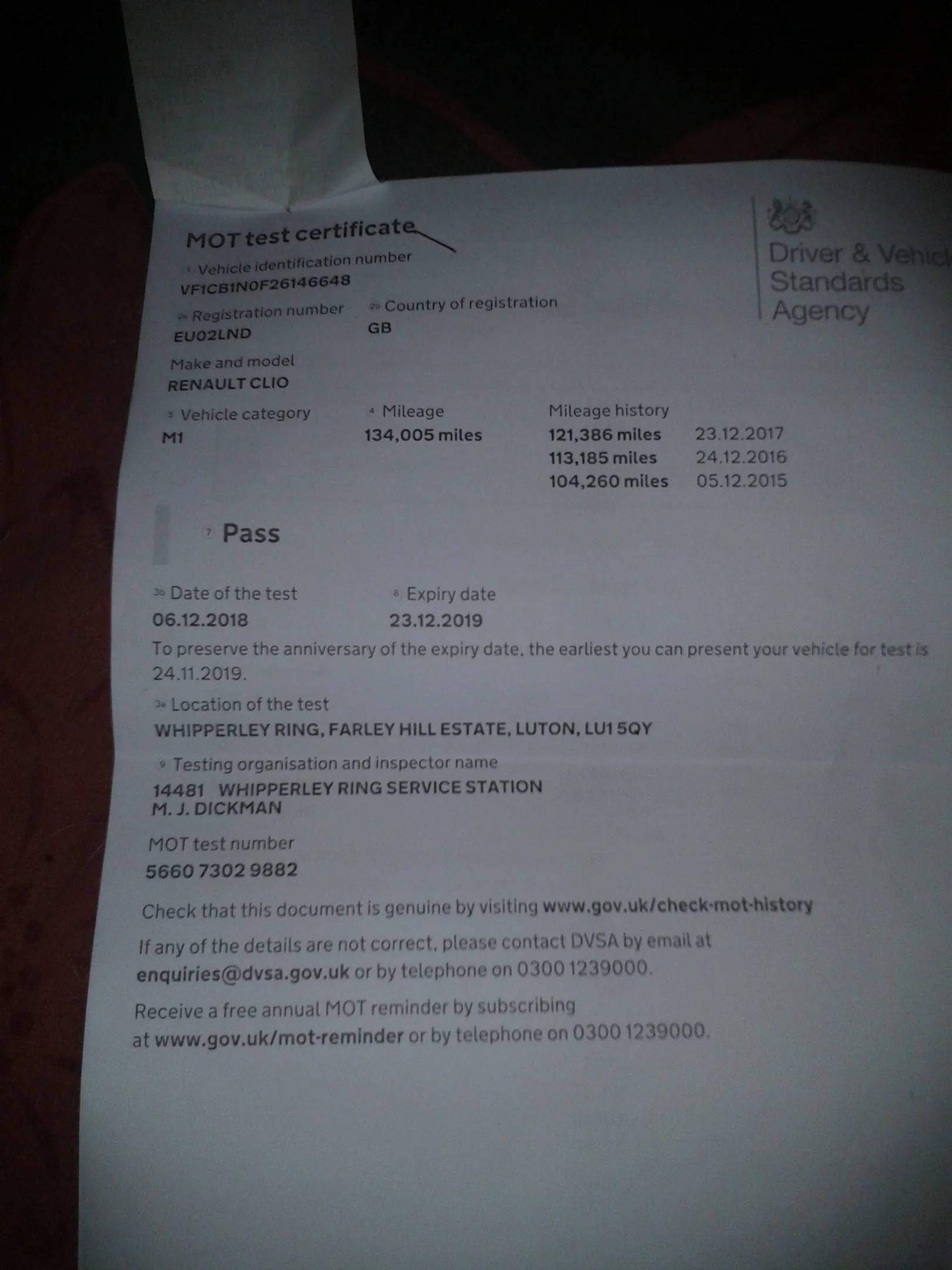

Fitted stronger 400 front & 300lb rear springs to the Gaz GHA`s.
Removed the exhaust from the manifold back, had a blowing crack in the cat welded up, and refitted with new fitting kit, gaskets, clamps, nuts & bolts &
hangers.
Flew through the MOT with no advisories.
Full Geo booked for tomorrow.

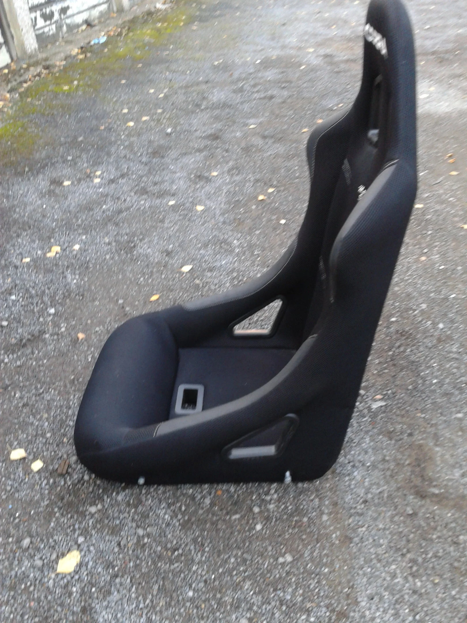

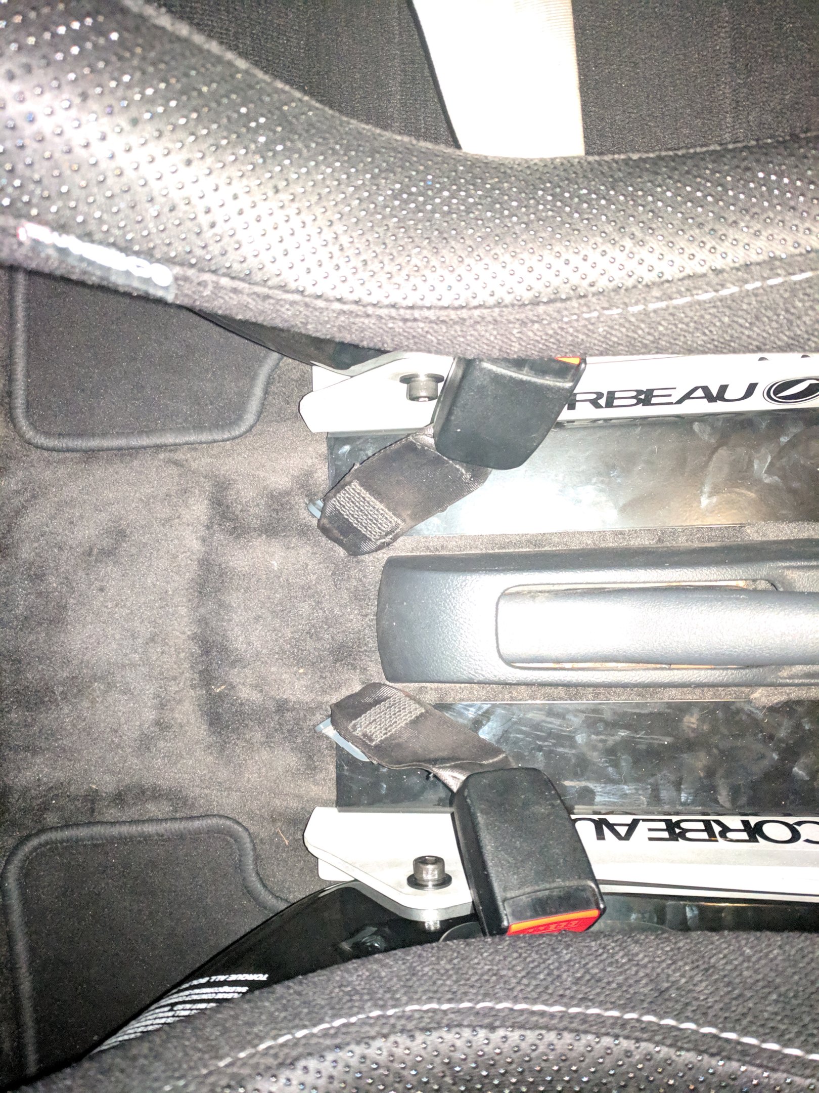

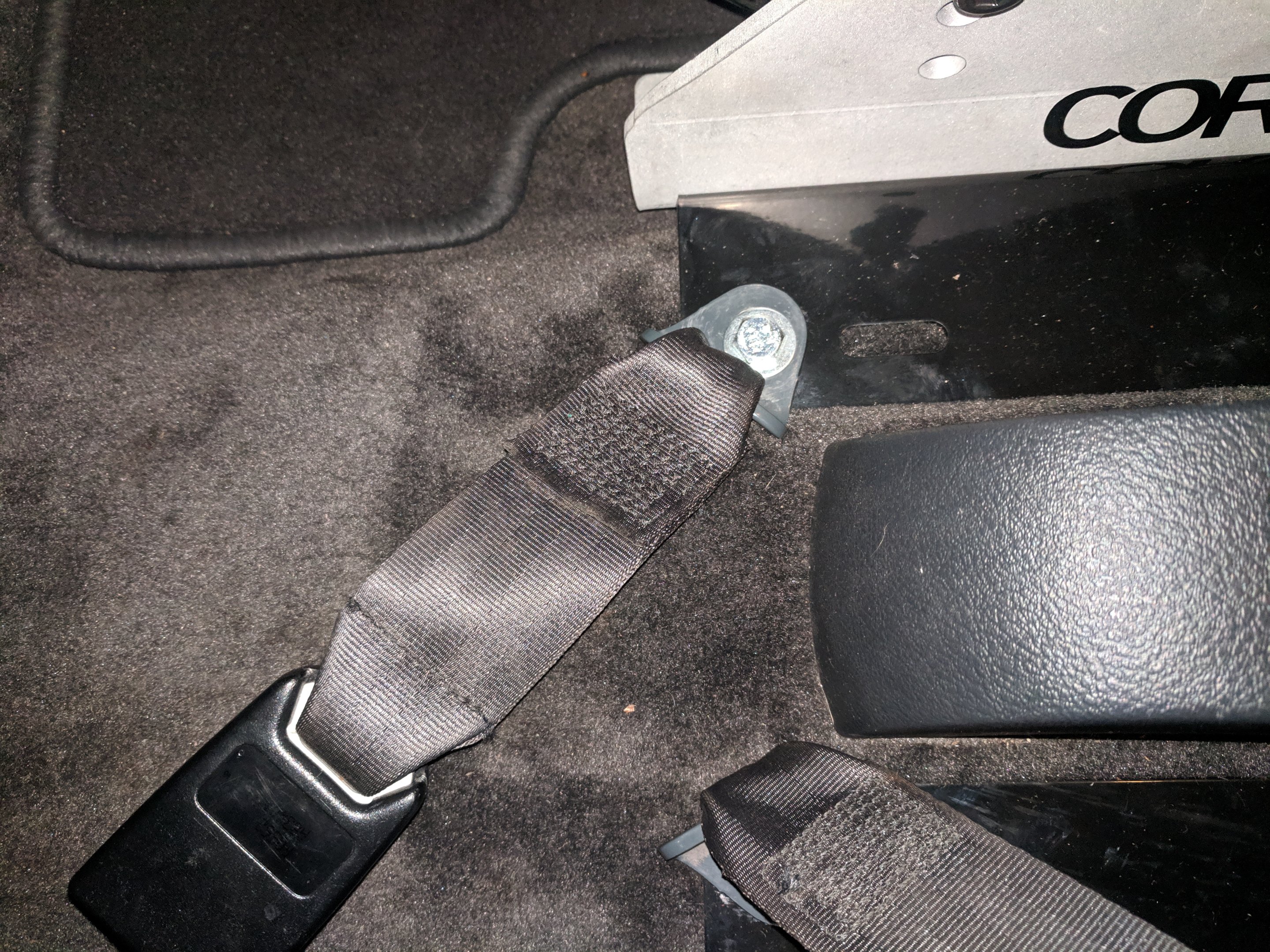

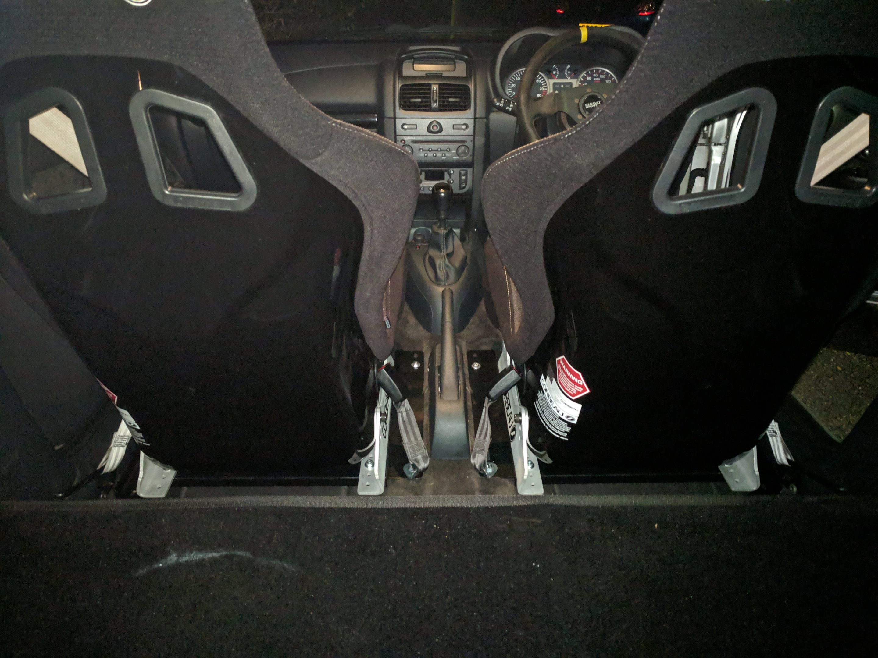

Thanks for that.

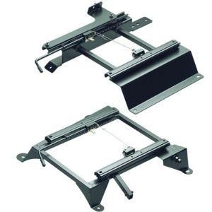

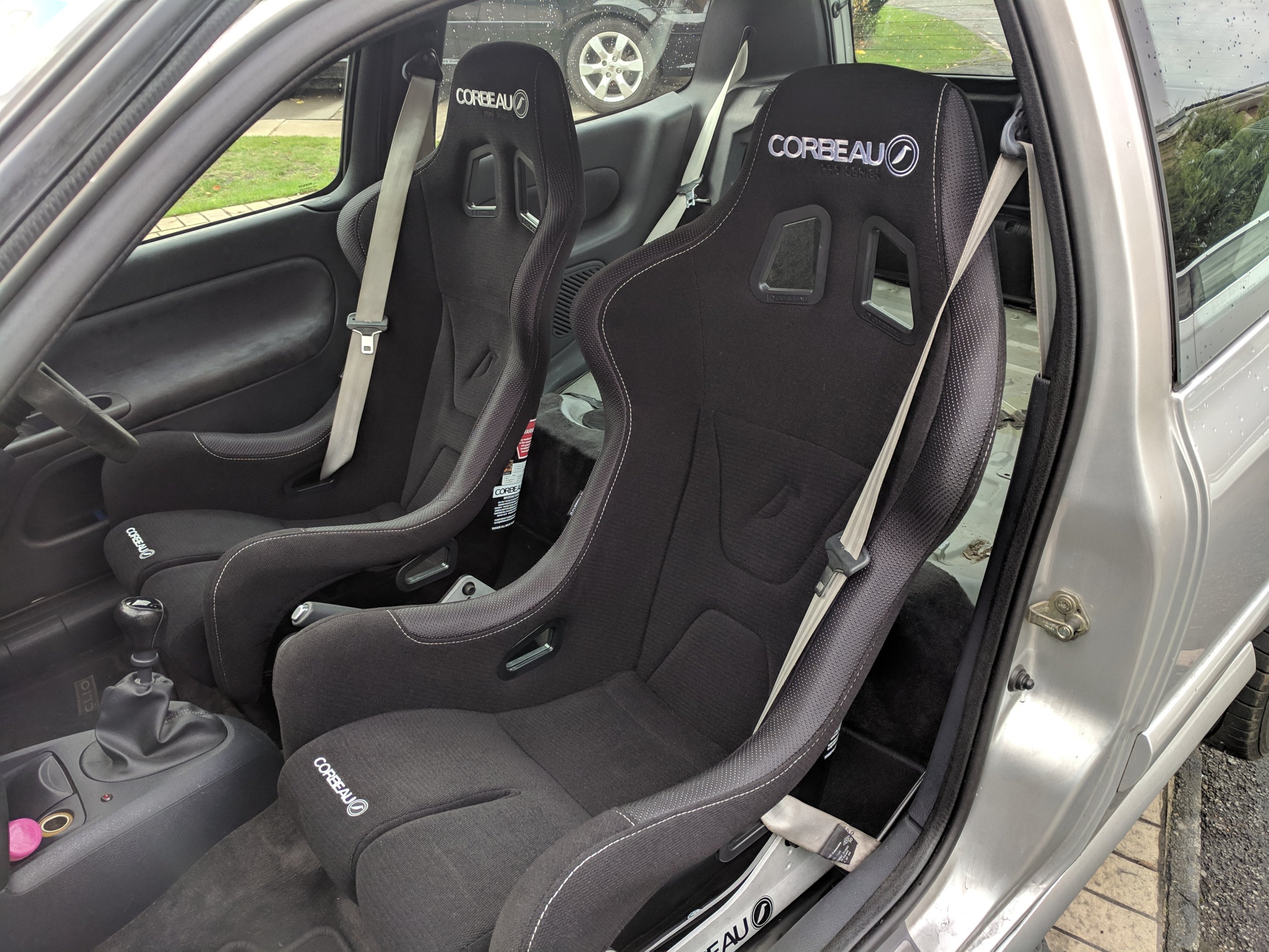

I have a mounting point on the slider, so will use that.
I`ll do the passenger side 1st, now I`ve got the MOT done, and see where it sits height wise, as I suspect I will need side mounts or I will look like a 10 year old
that`s stolen a car.

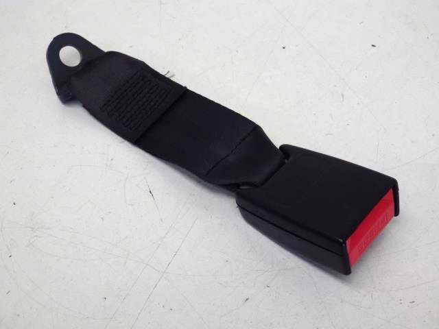

Yeah if you're using sliders it'd be best to fix the buckles so that they move with the whole seat when it's moved forward and backward.

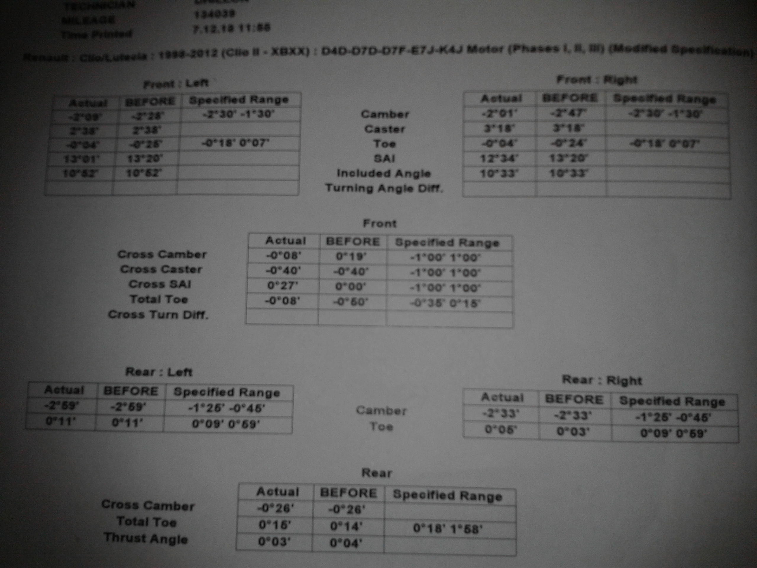

Geo done at STS in Bedford.
Could even up the rear camber with a 20` shim, and the front caster is a bit out due to taking a stab in the dark where to drill a new hole when I had original
Ph2 wishbones welded & redrilled. to a supposed Cup spec.
The steering feels so right, perfectly weighted with the steering wheel horizontal in a straight line, I cannot be bothered to piss about with it.

Of the few alignment places I have tried, STS seem to be the only place that get it driving straight first time.

I take it you have camber shims on the rear already? Looks to be more than standard.

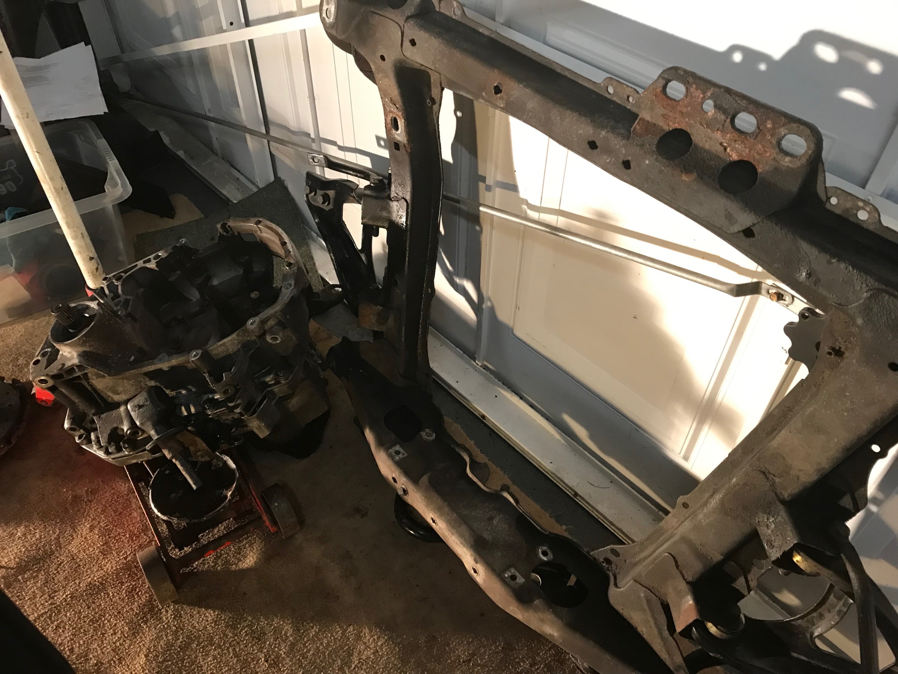

Well spent the last couple of days excl Xmas day removing gearbox + subframe. First time so proved 'interesting'. Subframe bolts to 3 hours to get out due to being seized.
I take my hat off to you guys who do this outside in poor weather?
Subframe off to be powder coated and gearbox off to NorthloopCup for Gripper diff to be fitted....... roll on on Harewood Hillclimb 2019 season!
Now just need to source a nw clutch (while it's out) and drivers side drive shaft due to split gaiter...grr
