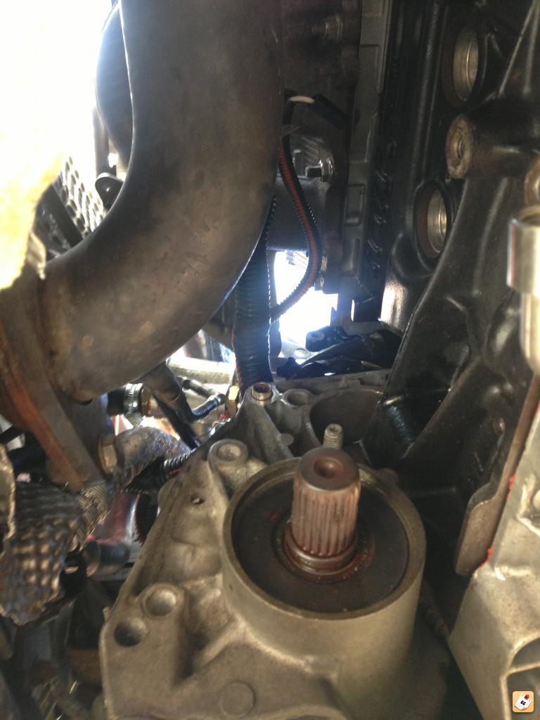

Pull the car a part to get my starter motor out as its sticking
Had to remove the drivers side driver shaft oil return pipe from the turbo then the starter, but also found my low pressure power steering pipe to be burst due to rubbing of the heat bracket so that'll have to come out too

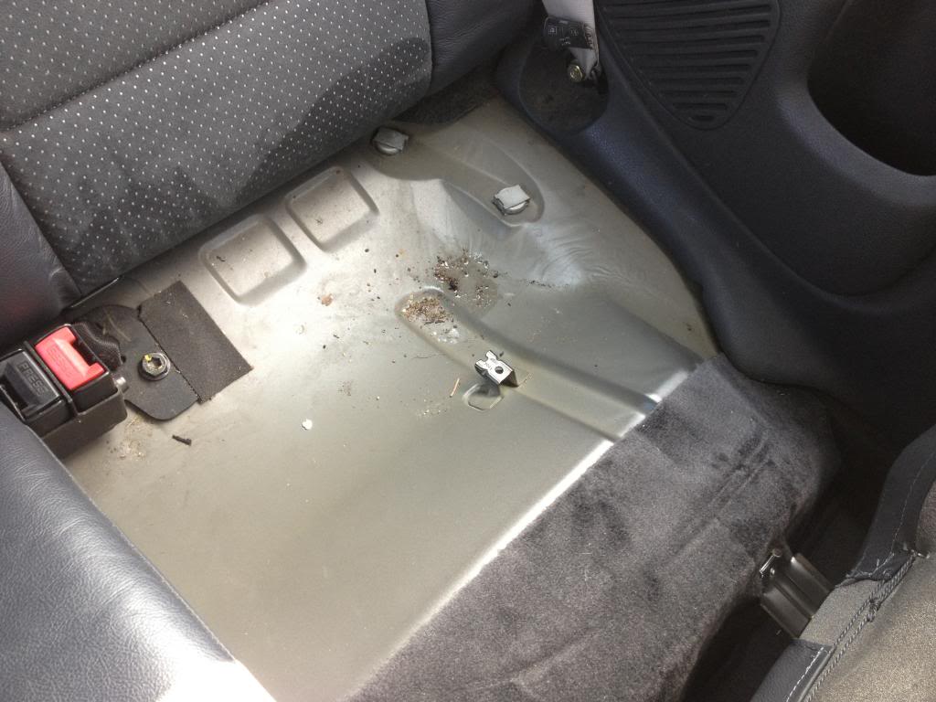

Where would this water have come from under the rear seat?
Check the rubber grommets next to the rear light clusters when to tailgate is open. Mine were letting in a little water that found its way under the rear seats thanks to the flat boot floor. They are peanuts from the $tealers so worth relpacing.

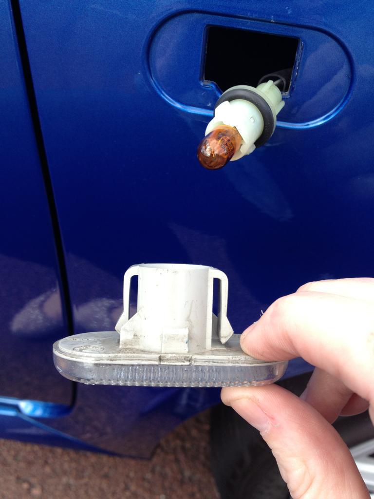

Changed these over as they was waterlogged

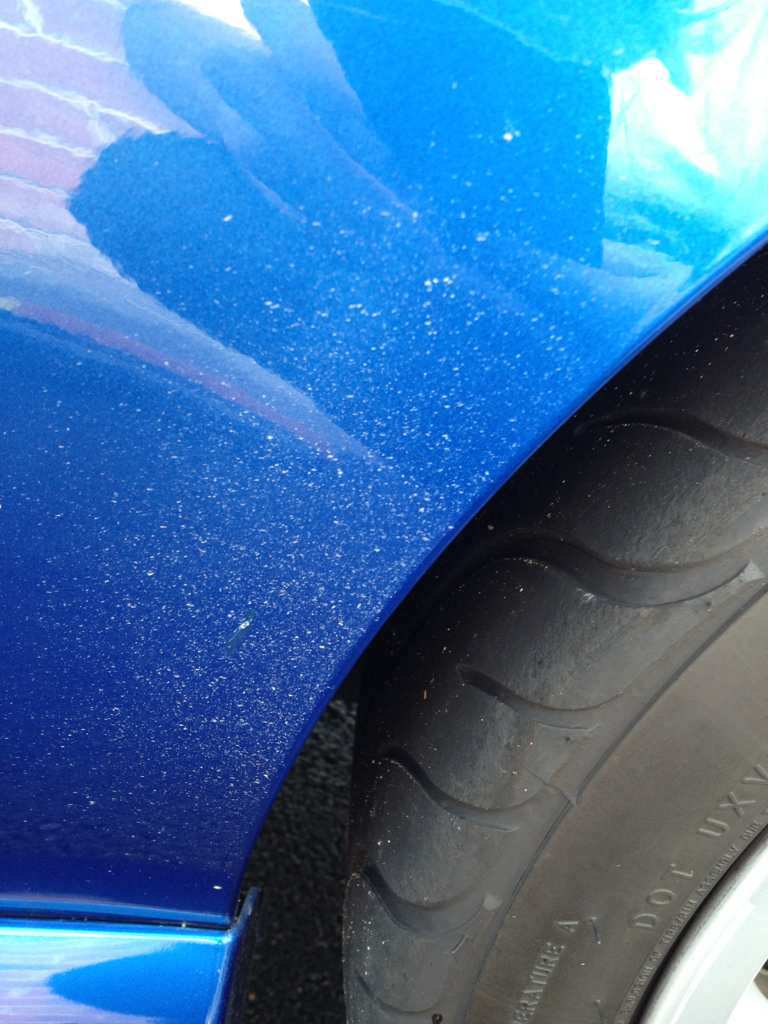

Gave it a wash and found this near the back arches that I can't get off (small white speckles)

those specials are on mine too. Looks like some sort of gravel rash. Been on track?

It'll be small chips from tiny bits of grit and stones being flicked into the paint, mine has a few, no way near as bad as above though thank god.
