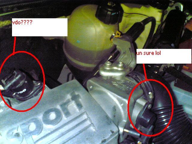

ok which of these two would controll the idle, and the fact that my engine wont drop between 3k on idle?
probably "unsure" one mate as this is the air intake which is what the Idle Valve relates to.
mmmm i ythought so, but the flap is shut when this is idleing do high the vdo, has a feed of the inlet elbow
VDO is the manufacturer you see, it's an electronics company. What about a number on the "Unsure"?
my breather on the inlet elbow goes to the bottom of the VDO, what does the throttle body position sensor do, does this run the idle?

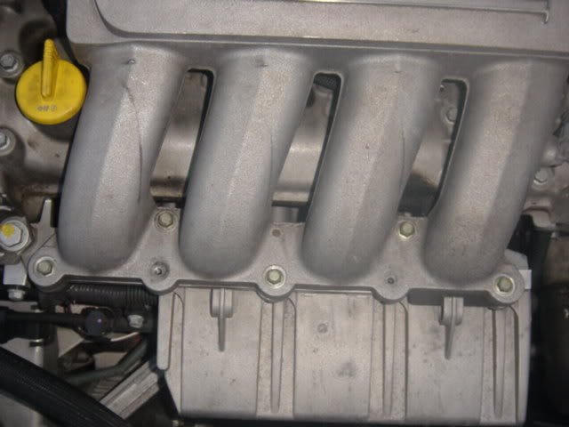

I removed the inlet manifold whist doing this, to remove the inlet, you have 2 bolts either side of the Coilpack, Not on the coil, next to the metal housing of the coil:
And 5 on the front.
The gasket doesnt have to be replaced for this part of the manifold.
When you refit it make sure its all inline:
