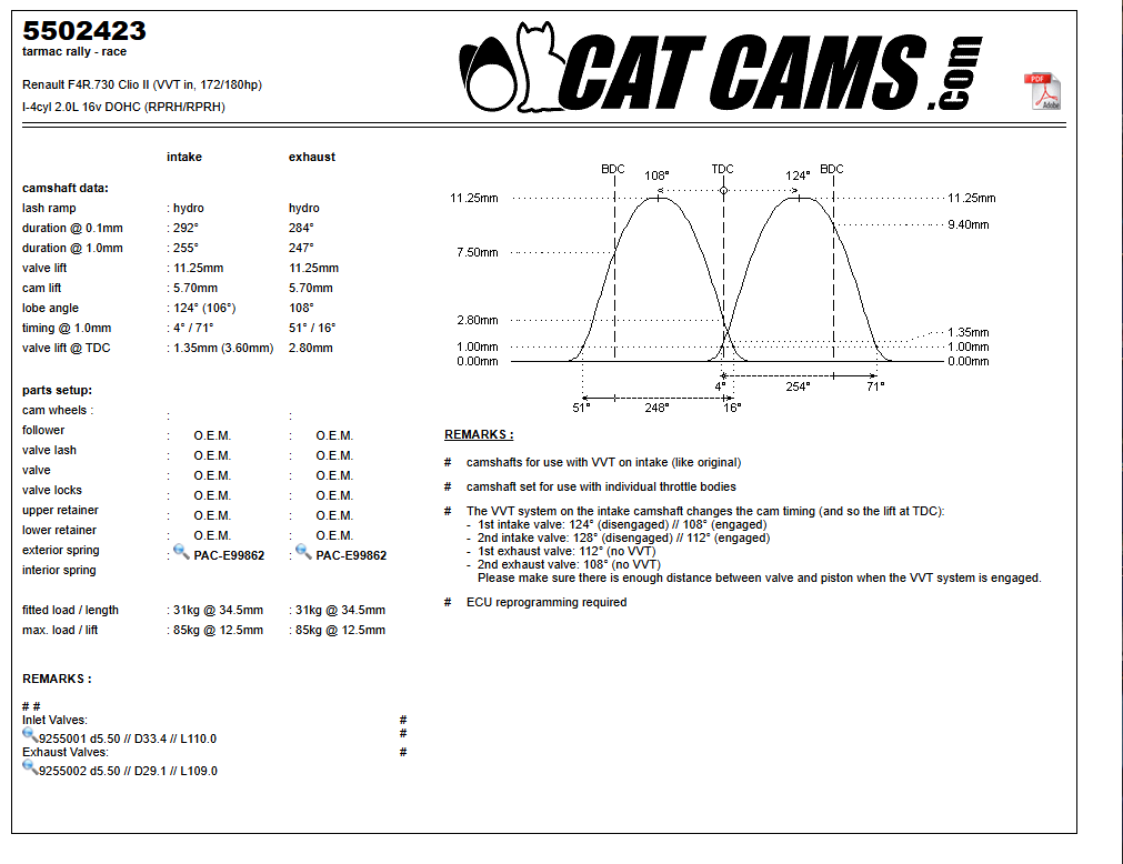

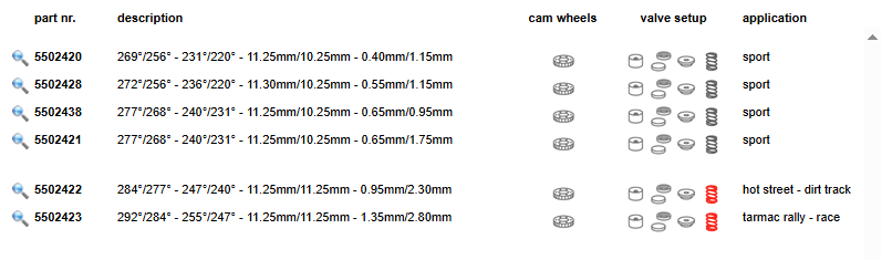

Catcam 423’s do they work on a “standard” 172 block?
alexapps
  172 RaceCar, VW-T5
Question as per the title really,
Consensus seems to be that I’d run into valve clearance issues with standard pistons?
That said I can see some people have posted saying they were planning to fit them to non built engines..
Does anyone have first hand experience?
TheBandit
  Monaco172, Green1.2
No experience, but my understanding is only the valve springs need replacing
