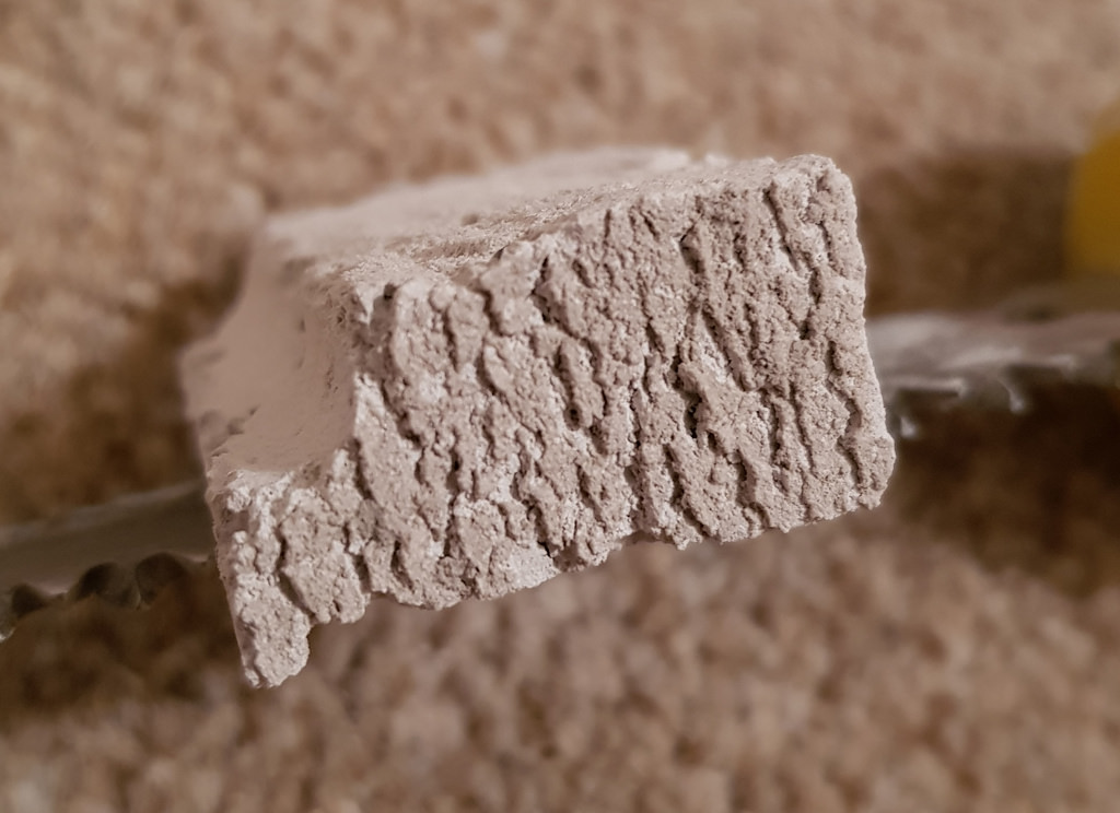

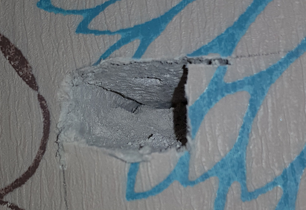

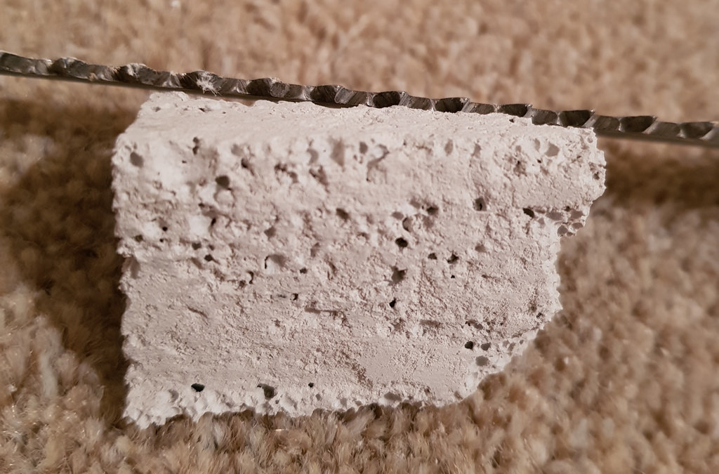

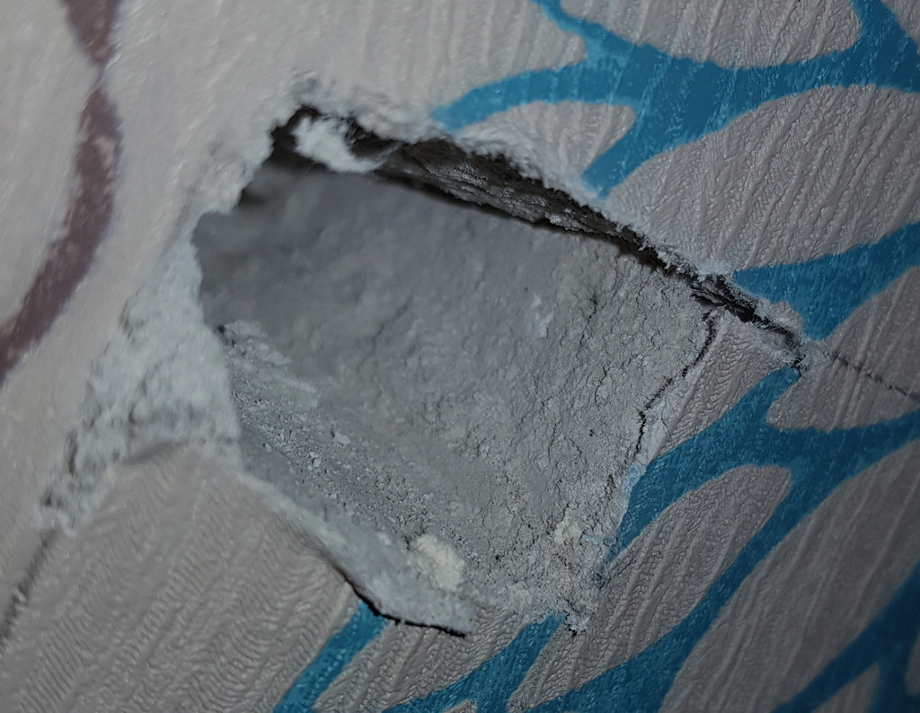

I'm trying to install a tv wall bracket on an exterior wall. I was planning to run the cables behind the wall. I thought it was plasterboard framed on a brick wall but it definitely isn't! It is soft like plasterboard but I can push my padsaw in 90mm. Is it breeze block? The house is about 1980's

Are they not thermalite blocks ? If so you’ll be able to fix to that easy enuff with the correct fixing I’d be more worried that it looks like they’ve just papered over a block wall lol is there any plasterboard then plaster in front of the block ?

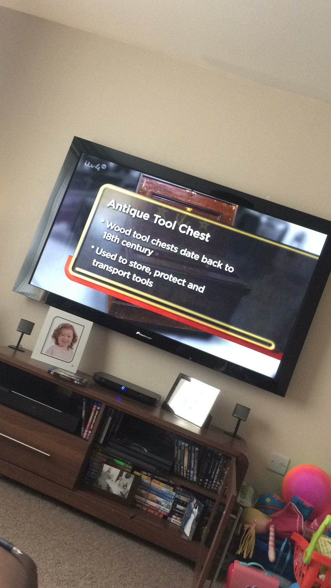

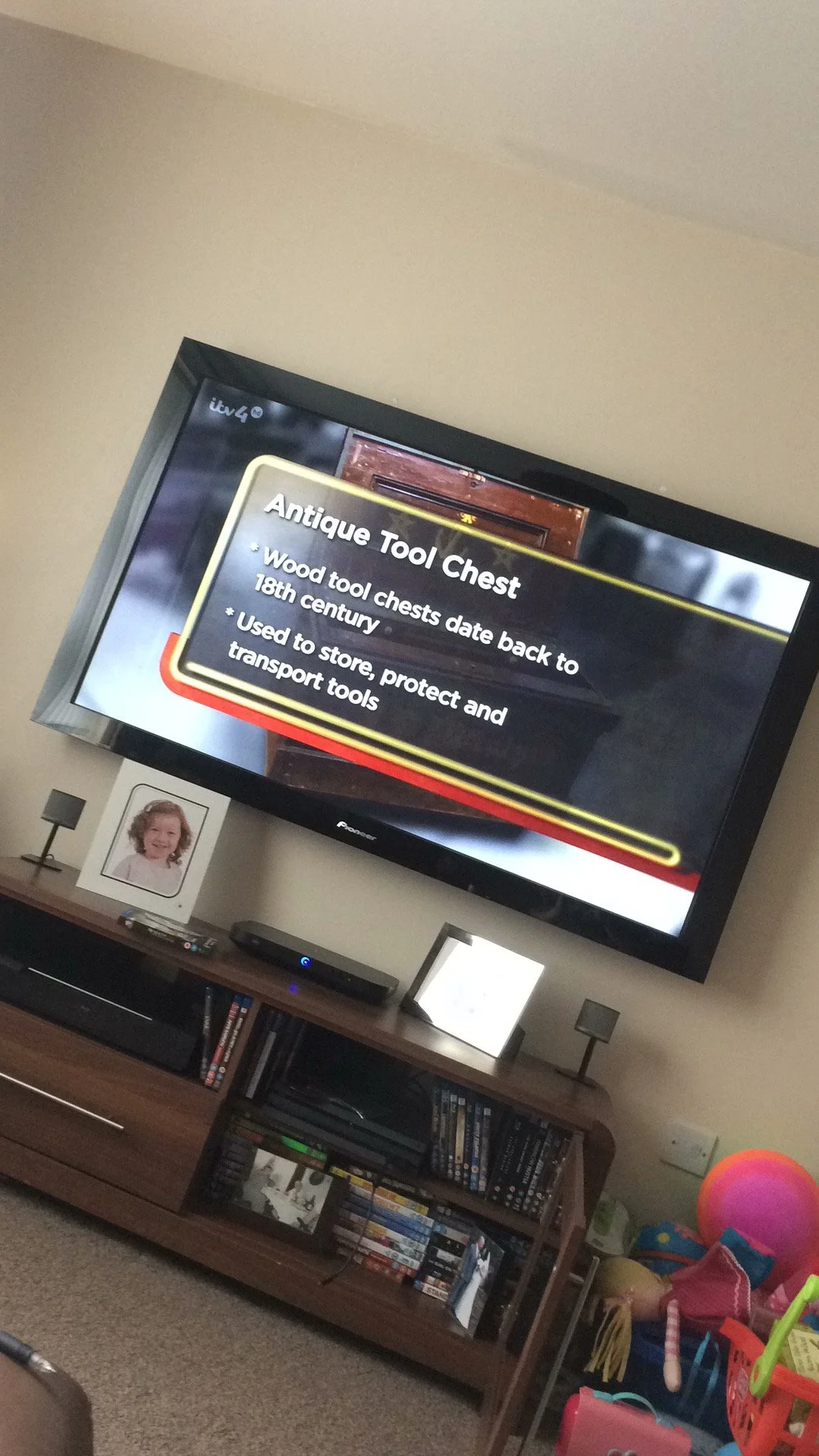

My TV is 50kg and fitted to an exterior wall via 4x M10 studs set in chemical resin. The wall is dot n dab onto breeze block.

50kg? Christ that must be huge!

I would fix a piece of ply to the wall with plenty of fixings then mount the telly bracket to that. I've not dealt with thermalite a lot, but know you can get special fixings for it. I've used resin a lot and it's good stuff. Just make sure you're prepared and have the holes drilled and cleaned out before you start using it. It sets hard in the nozzle after a few minutes of not using it.

I Remember these breeze blocks from the 80s
When working on building sites
They were that soft you could virtually drill them with your finger
Made from compressed ash from the leftover s**t of a coal fired power station
They mixed the ash with water then compressed and dried them
f**king rubbish I’m still amazed a lot of these houses are standing
