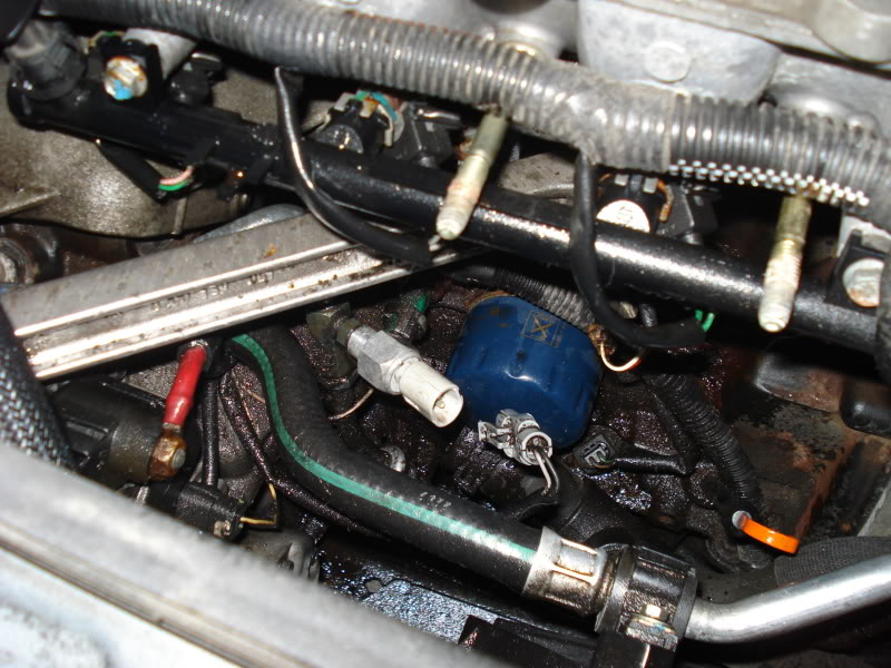

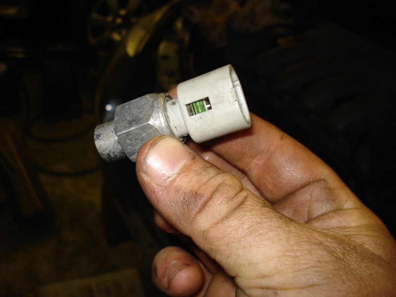

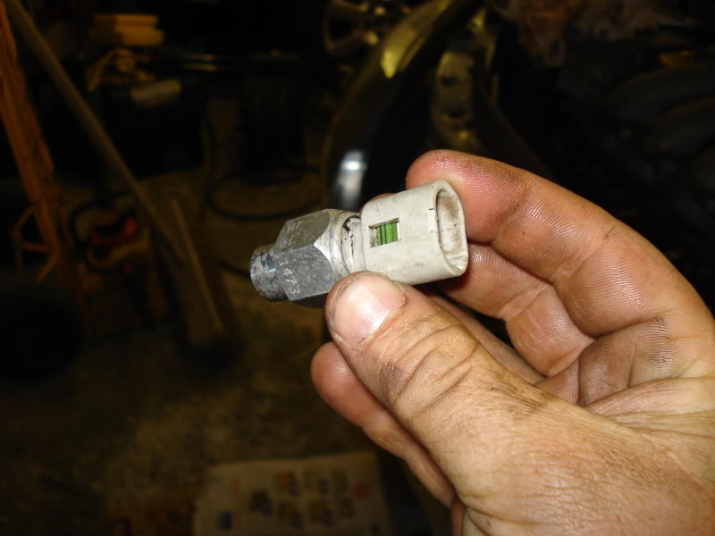

What is this called? its some sort of pressure sensor for the power steering. i have the major problem of a hairline crack in the silver nut. i need to order a new one but dont know what to ask for?
a part number would be great but think that might be asking to much.
cheers:D
Its a P.A.S sensor just like you said,
The part number on my Dialogys is 77 00 413 763
Hope that helps m8 :)
On my system is showing as £54.96 but it could of gone down in price, tried contacting wests renault? sure he can get you discount on one?
well my brother works for renault so he will be able to get it at trade price. its just hard explaining on the phone to him what it is lol. will update tomorrow and let you know what it cost. thanks for your help though, much appreciated :star:
