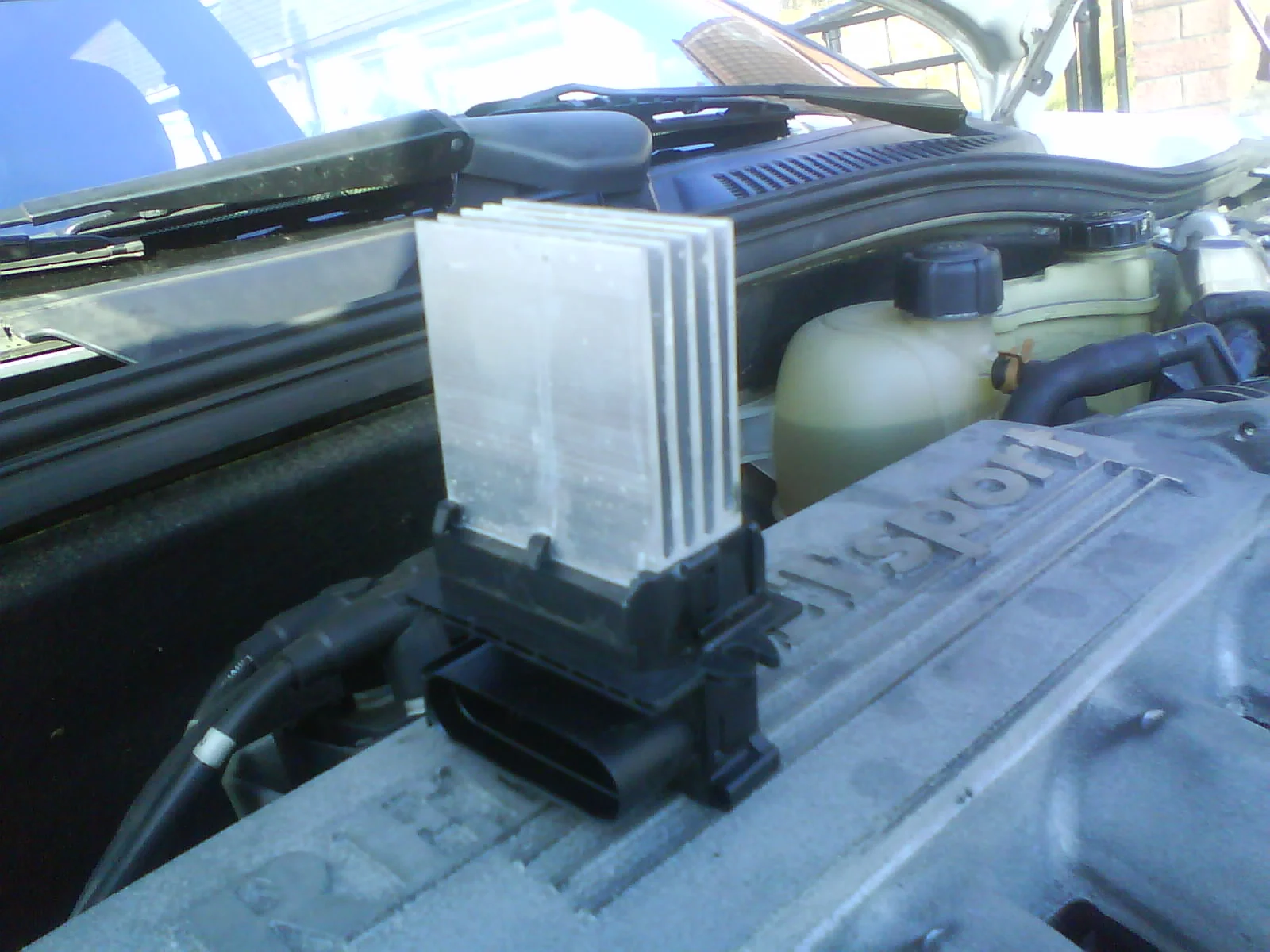

any ideas what this is? im trying to resolve a problem with my climate control and i think this may be the problem.
Its neither of these, its the PWM module for the fan speed regulation. If its running full speed or not at all it'll be that, common thing. £100 from renault unfortuantely.
