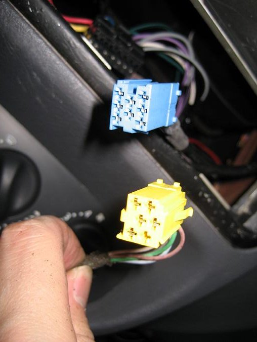

Just change the audio unit on my Mk2 Ph1 172 yesterday and found 2 plugs behide the unit. One are blue and the other are yellow. What are they belongs to ?? For the CD charger ?? Or any other unit?? THX

IIRC
Blue one is for the Cd changer.
Yellow is for the stalk/dash display.
There certainly is!
Some allow stalk use, some just the display and some allow both stalk and screen.
Best looking into Halfords and see if they can order them for your specific Head Unit.
Also look at Car Audio Retailers online (many about) to use the databases etc they have. Probably find the parts cheaper there also.
