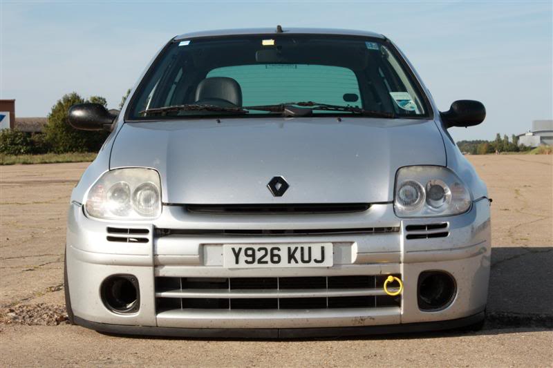

I'm not sure if its relevant, but The guy I do track days with has a 172 with 25mm spacers and has FK coilovers wound a long way down.
Its f**king amazing to drive. (On track, no idea on road)

Oh, find out what setup he has, would be a lot of people interested on here :)

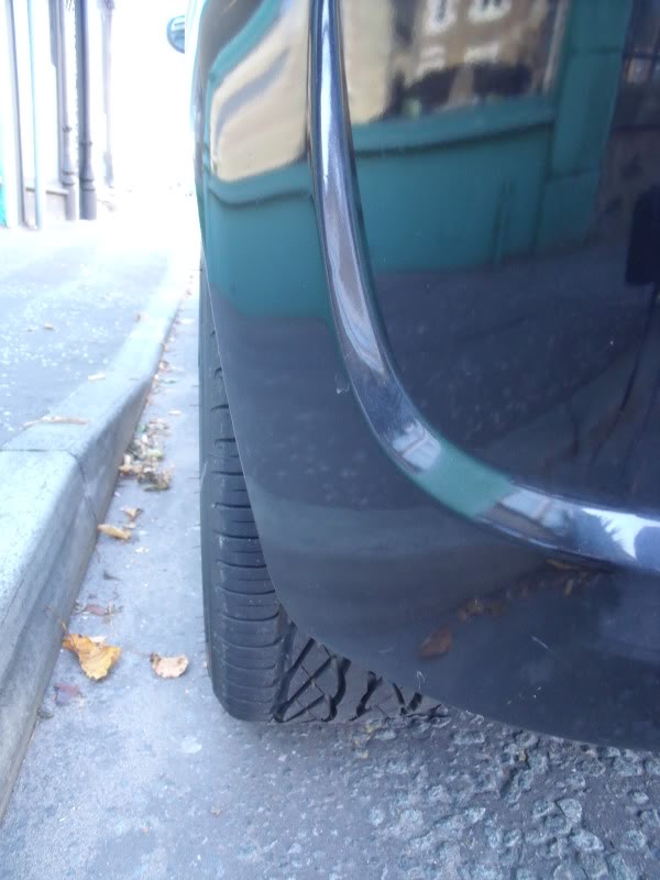

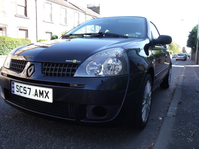

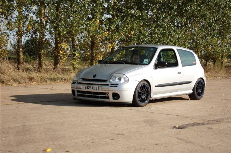

As requested.
30mm a side front, 13mm a side rear. ;)
(Still to put my coils on)

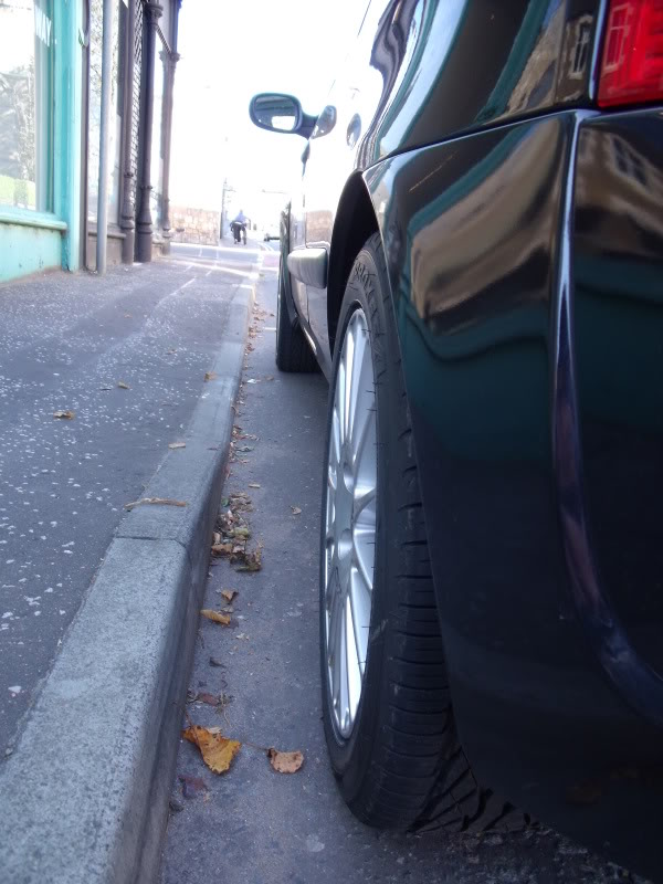

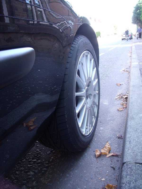

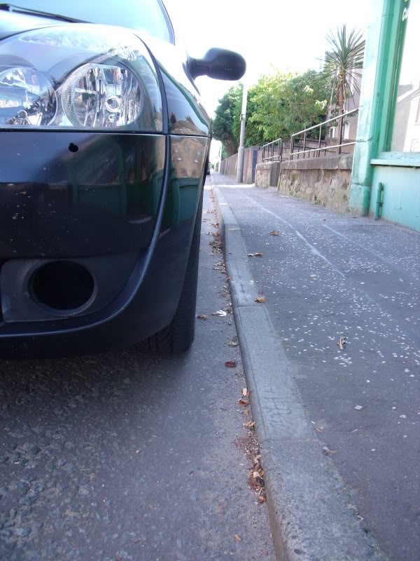

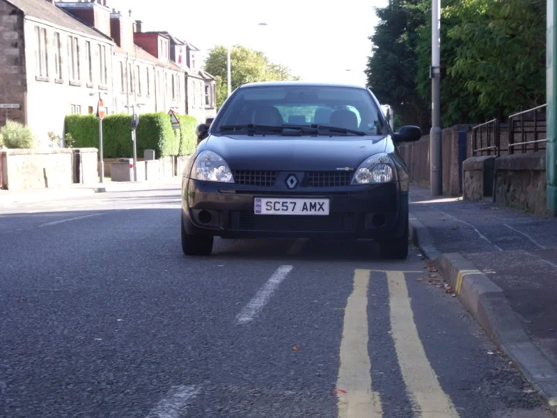

I have this exact same setup! Handling wise its awesome, you need to have the dampening on nearly the hardest setting though as if it was on soft the bounce of the wheel inside the arch can clip.
I do have them wound down so the top of the arch is virtually on top of the tyre. Also runing the camber at -1.5 helps put the top of the wheels in the arch :)

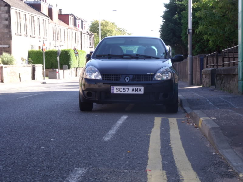

EDIT: Just to verify the lowness ;)
This is in a little rut though, its about an inch higher :D
