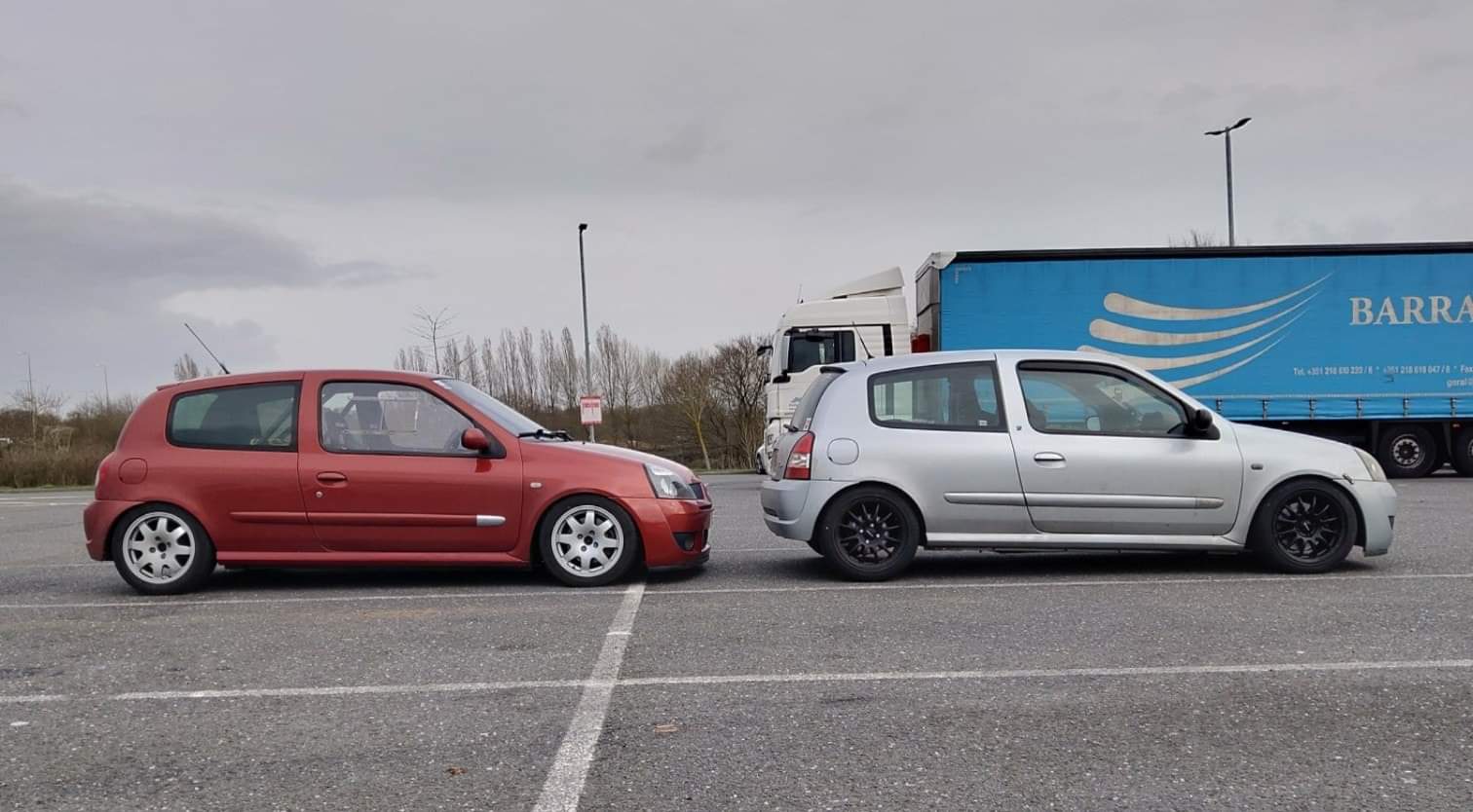

The white clio is going to be for mainly sunday blast as i have my red clio for trackdays fitted with Kw v2's which i need to sort stiffer springs for and get mesurements for.

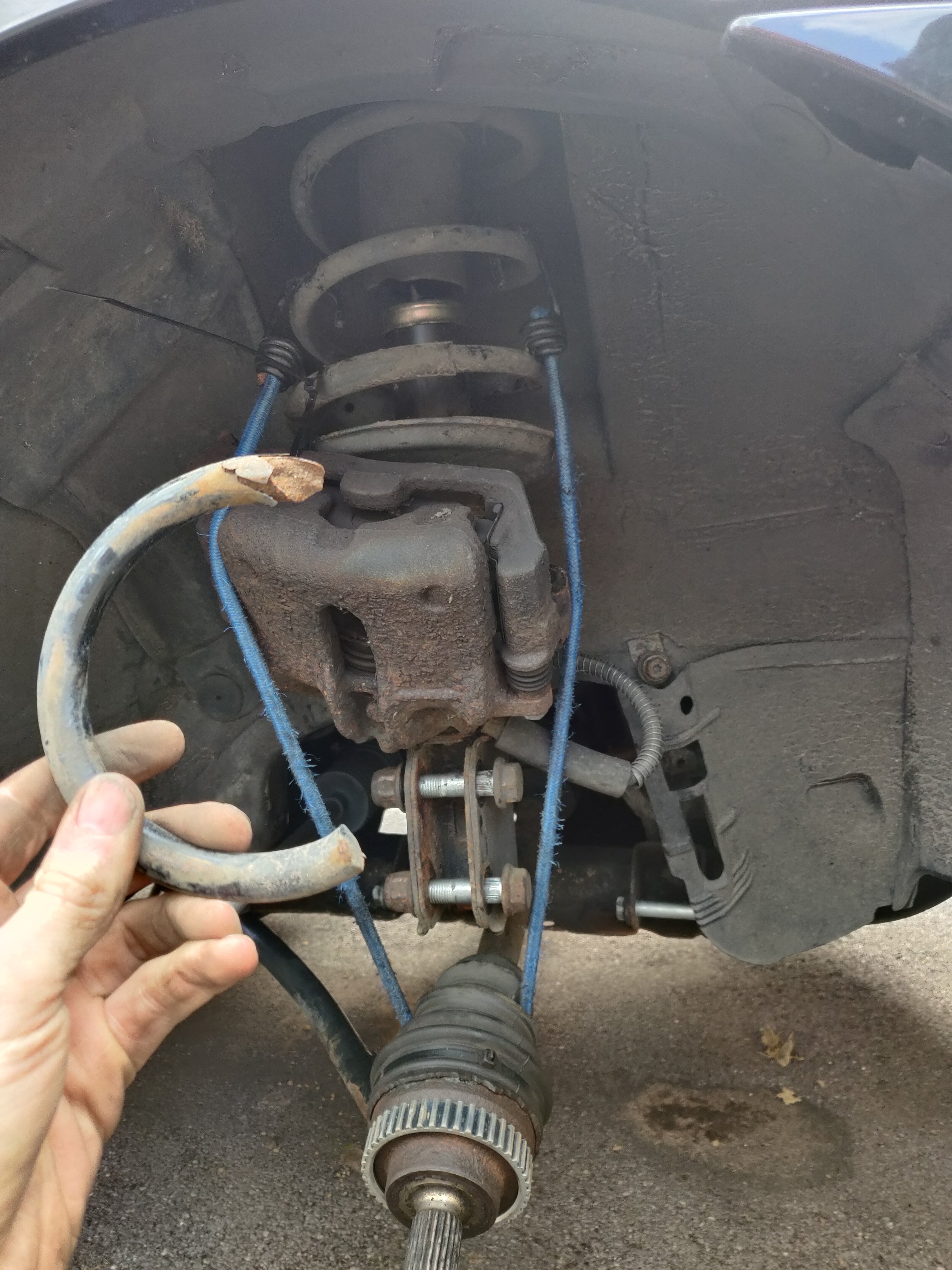

TBH 15 year old stock springs have probably sagged by 5-10mm anyway.
I was driving around on a spring for over a year with the last turn snapped off without noticing.... that must have been a good 10-15mm lower and I was totally ignorant.
Really Rob?I think I'd defo notice a spring that much lower.
I even notice when tyres are a couple of psi lower!lol!.
I do ride & have raced bikes though & I think that makes you very sensitive to handling , feel etc.
Flob
I bought the car like it having never driven one so I guess didn't have a good comparison. It drove just fine with it broken and I didn't notice one side was especially lower visually, think it was the drivers side and often on old cars the drivers side seems to usually be a little lower than the passenger so just blanked it... but generally drove fine if not a little tired!
When the rear beam bushes became worn the rear steer became un-ignorable though!
I'm much more fussy with bikes!
NBG182
  BG 182FF
Mine was exactly the same when I bought it! Even passed an MOT like that - wasn't particularly lower on that side, and the fracture was at the top of the spring, pretty much impossible to spot without having the wheel off.
Fair to say it drives nicer after refreshing all the suspension, but it was surprisingly alright before, all things considered.
