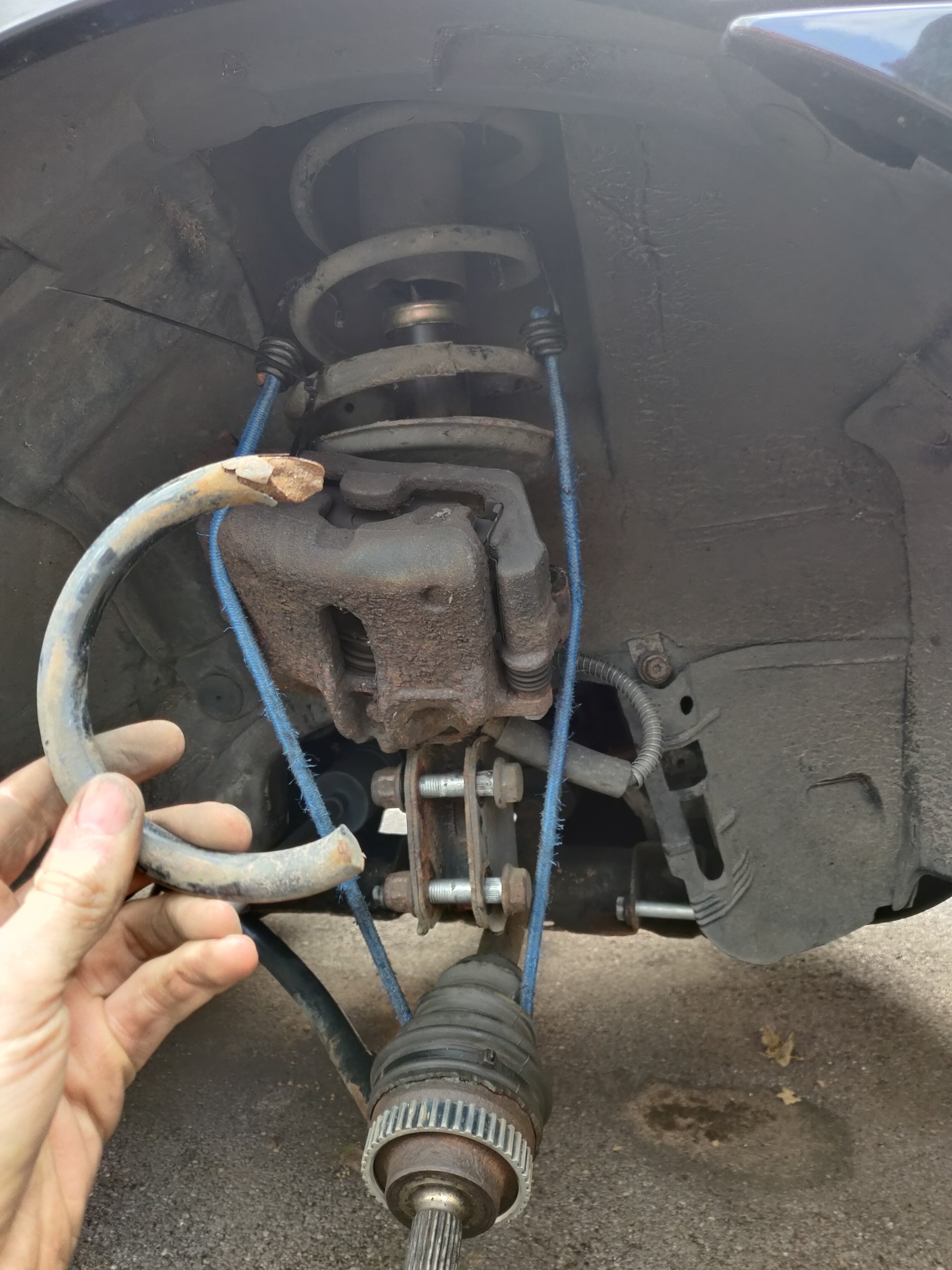

Mine was exactly the same when I bought it! Even passed an MOT like that - wasn't particularly lower on that side, and the fracture was at the top of the spring, pretty much impossible to spot without having the wheel off.
Fair to say it drives nicer after refreshing all the suspension, but it was surprisingly alright before, all things considered.
Genius idea with the bungee - I normally end up holding the shaft up awkwardly on an axle stand or some shonky lump of wood - this looks much better (y)
TBH 15 year old stock springs have probably sagged by 5-10mm anyway.
I was driving around on a spring for over a year with the last turn snapped off without noticing.... that must have been a good 10-15mm lower and I was totally ignorant.
Ive had 2 broken front springs on my 182 and never noticed. Both were just a couple of inches on the end.
Mick at Diamond motors spotted the first one when he was servicing it and second one a couple of years later was picked up when I took it for an MOT.
I really doubt anybody would feel the difference when driving it. I've had it since new and I couldn't feel any difference.
