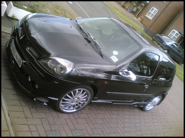

Car  clio 1.2 16v expression
planning on giving my car a good wash n wax polish etc, atm i wash with turtle wax shampoo and then try with chamois n then use turtle wax over car.
whats the best products to get and what order to use, full names etc please is i read a few threads and just want to know what to put together
pm dave? i see "Rich" knows alot as he seems to know what he 's talking about, mite just pm hom or see if he replies here
sweet looking motor mate i have the same side skirts lol i wash with turtle wax zip wax dry polish we autoglym s/r polish then use the autoglym extra gloss bring it up a treat
