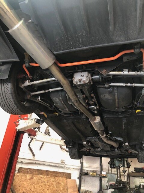

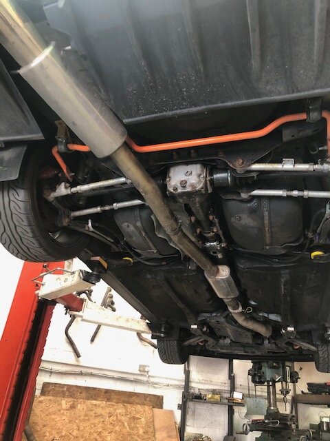

I had this issue with my impreza. I had a custom resonator made. Has made no difference to the power but had taken the edge off of the noise, especially on the motorway. cost me £200 which was much cheap than replacing it.
Mcaff
I had this issue with my impreza. I had a custom resonator made. Has made no difference to the power but had taken the edge off of the noise, especially on the motorway. cost me £200 which was much cheap than replacing it. View attachment 1455612
Excellent thank you, this is definitely the route im going to go down... now just need to raid down the back of the sofa for money
