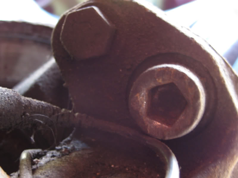

Have tried metric allen keys but no luck, is it an imperial fit or a renault tool of some sort?
Allen key FAIL, its got 5 freaking sides!

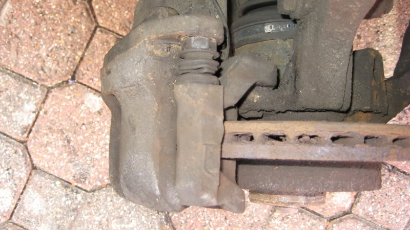

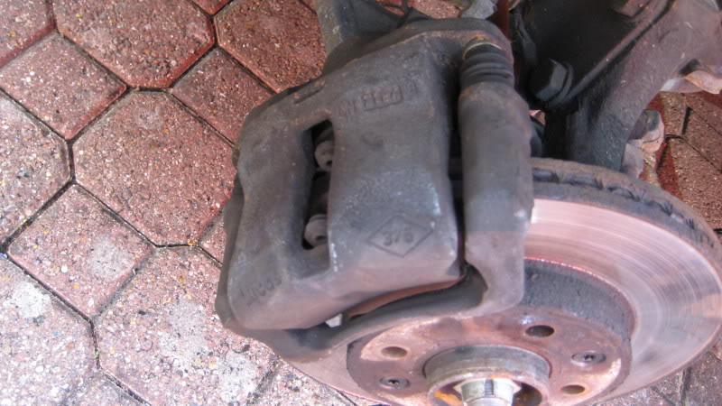

They are fronts, the shot it taken from inside the wheel arch looking outwards, you can see the top half of the caliper, bottom half is the same.
The bolt at the top came off easily (was 14mm) but doesn't seem to have changed anything, seems like its the big ''allen key'' style bits that need to come off? Can't see any 17mm bolts?

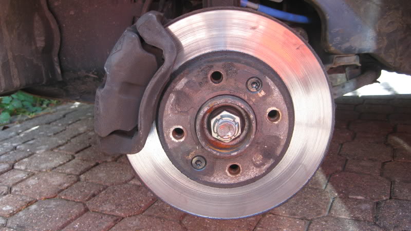

Edit with pictures:
No sign of any 17mm bolts?
From the side:
From above, the bolt was removed where you can see the ribbed plastic:

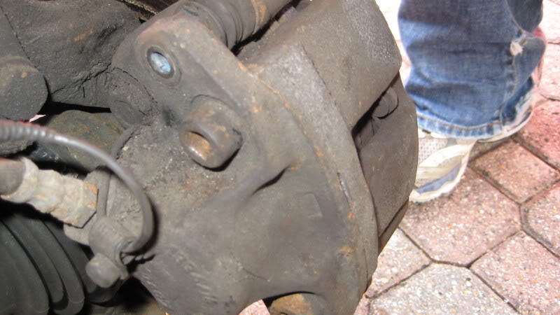

From the inside, you can see where the bolt was that I removed:

The allen key type bolts are just the sliders, Theres just two bolts on the caliper which need undo-ing, think when I did it I undid the two 18mm caliper to hub bolts
You don't need to touch the pentagon shapped thing. The nuts near the rubber boot top and bottom should be the ones you need. If you are just changing the pads, loosens the top, and take out the second. Pivot it upwards.
how is the carrier attached to the hub? is just two 18mm nuts on the 182. Not sure on yours, but calipers don't look too different.
