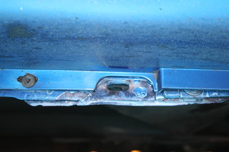

What type of metal is the front and rear jacking points made from on the 182? Will it rust like my Mk1 did after bending from being jacked up? Or is it galvanised now?

Ok thanks. I do jack the rear from the rear beam already, and I would like to jack the front form the point mentioned, but the car is too low to get the jack under? Is this a common problem or do I need a new jack? I'm still worried that the front sill jacking points are now going to rust as they are all bent and the layers of metal are separated, what's the best way to mitigate this?

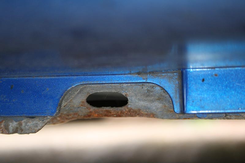

They will rust.....
Used a trolley jack on its side against a wall and a wooden prop to push against the bend from the opposite side.
It worked and it is a bit more controllable than a big hammer, surprisingly hard to bend them back into position though despite being so easy to distort.
You'll need to remove the side skirts to do it properly.
Treated with Loctite rust-eater, primed and painted.

thanks obcuz, very informative. I will clamp them in a vice (with rubber protectors) to bring them back to true, then paint as you have suggested.
obcuz
I thought about the vice method, but despite being made of cheese as suggested, there are 3 laminates of M/S and take some budging even with hydraulics, let us know how you get on though.
Yes, agreed, only the thoughtless (perhaps kinder word) would use these jack points, the fronts were bent on mine but rears are fine, the extra weight on the front make the difference I guess.
PS. wasn't me did that damage and for sure they won't be used again.
