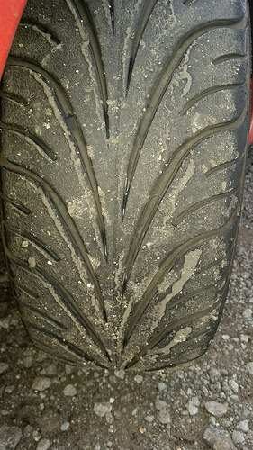

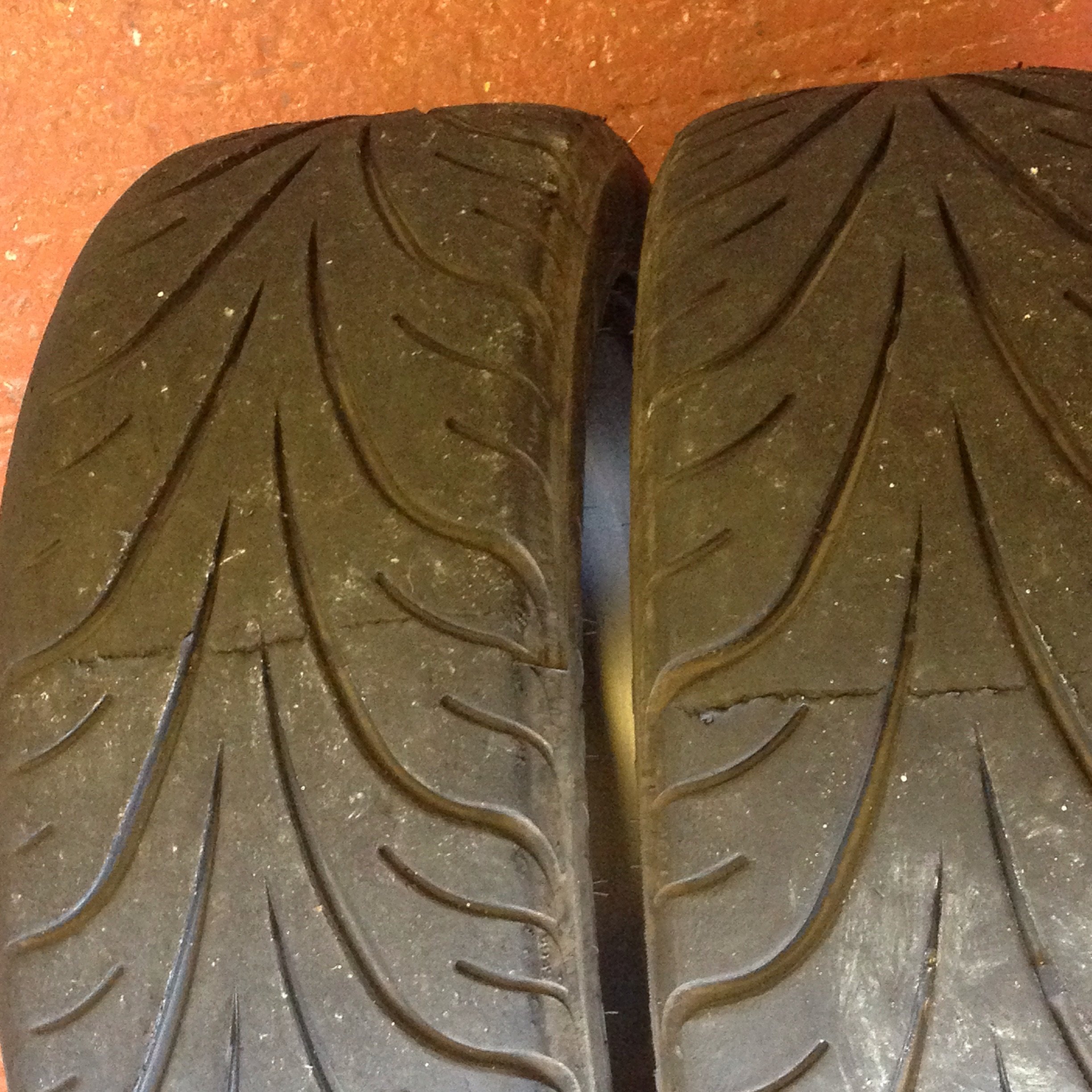

My Federal rsr after one track day.
Would you really buy these?

I've used both, Federals last longer than 120 compound Nankangs, both about the same grip, would go Feds for a track car. The dude above who posted the photo, either your driving or car setup (or both) need some work. Sorry if that sounds harsh bit we run Federals (on an MX5) for a full season of racing and the outside edge doesn't end up much worse than that. The 'slice' is nothing to worry about BTW.

Google the federals splitting.
I'm far from alone on this.

Has been covered on the forum before and they seem to split but the tread doesn't come away from the tyre. Considering the state some people can make of road tyres after a few laps it's not that bad really for the grip you get.

Yeah, both of my sets have done the same. Never manifests into anything sinister.

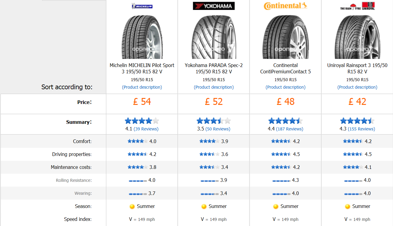

Think I have narrowed it down to these to replace the Yoko Neova AD08 that are on at the minute but are flush with the wear markers so not ideal on the road. (how low would you run your tyres on track? weather permitting I assume) Only decided not to replace the AD08's because they're £20 each more than any I have narrowed it down too, and I'm going to hopefully put more track bias tyres on my spare set of Speedline 2118's when they have been refurbed and the weather picks up a little better. These tyres will be mainly for my first few track days in January/Feb and the odd blast on the road.

For what you have said. Get a decent set of road tyres for everyday. The hankook v12's are good, or were when I had them, used on one trackday too. Get a spare set of more track focused tyres as spares, for trackday only on the spare set of wheels, that's what I will do eventually when the weather picks up a tad.
