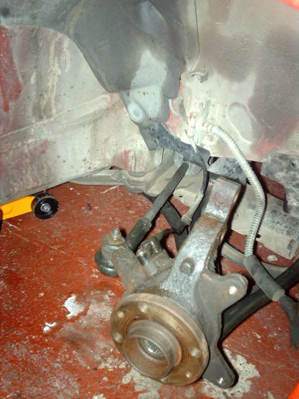

Had a flat tyre and my ex put the spare (standard rs wheel) on for me, then I took it to the garage, and when the guy took the spare off, the arrowed 'steel ring' in the centre came away with the spare...
Anyone know anything about this...the guy in the garage was useless!!

100% Its the ring thats attached to the disc...they showed me before they put the wheel back on
Thats a standard clio front hub, your saying that round metal piece that the wheel sits over has gone?

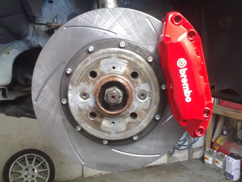

them calipers look a hell of a lot like xkr/db7 rears... i hope thats the case as i have one of those

I cant see how that came off, its part of the hub. Heres a pic of my hub. Are you sure it wasnt a spigot ring or even a spacer??
hmm.
which pic?!
the one you posted the brembos.
they look exactly like standard fitment xkr/db7 calipers be a touch if they are.
are they yours mate? is the caliper direct fit to the hub or is the a seperate bracket on it as db7 ones bolt straight to the hub
sorry to go off topic
Its ok, lilblondie wont mind........, They came from Godspeed mate! were a kit made up for the clio, but i think the caliper itself is used elsewhere! At the min it has some jag pads in it!:clown:
yes thats it!
jaguar xkr rear pads!!

If it is definately that thing, you need a new hub flange, but if you just get that it will need to be pressed in as above, with a new bearing, so best to try and get a complete secondhand hub!

Ex put it on....the bolts took forever to tighten apparantly....but seemed to be on ok! How can it be a spigot thing? I saw the disc...it had a big ring missing from it and the ring was in my hand LOL!

Trust me...its that thing that I said was rusty!
:quiet: ok ok, you need a hub!!! But your wheel aint going to fall off because thats missing, your wheel will just not be sat 100% right, may give you wobbling issues!
You need to source a new bit sharpish! Any reno specialists near you?!

Hmm bolts took ages to tighten up seems strange unless that was him thrashing the spigot ring flat, mine are only made of nylon so they'd crush with enough force.

Have to agree with the common suggestion that it's a spigot ring and certainly not part of the hub. Not all Spigot rings are plastic/nylon some are metal although it's fairly unusual.
