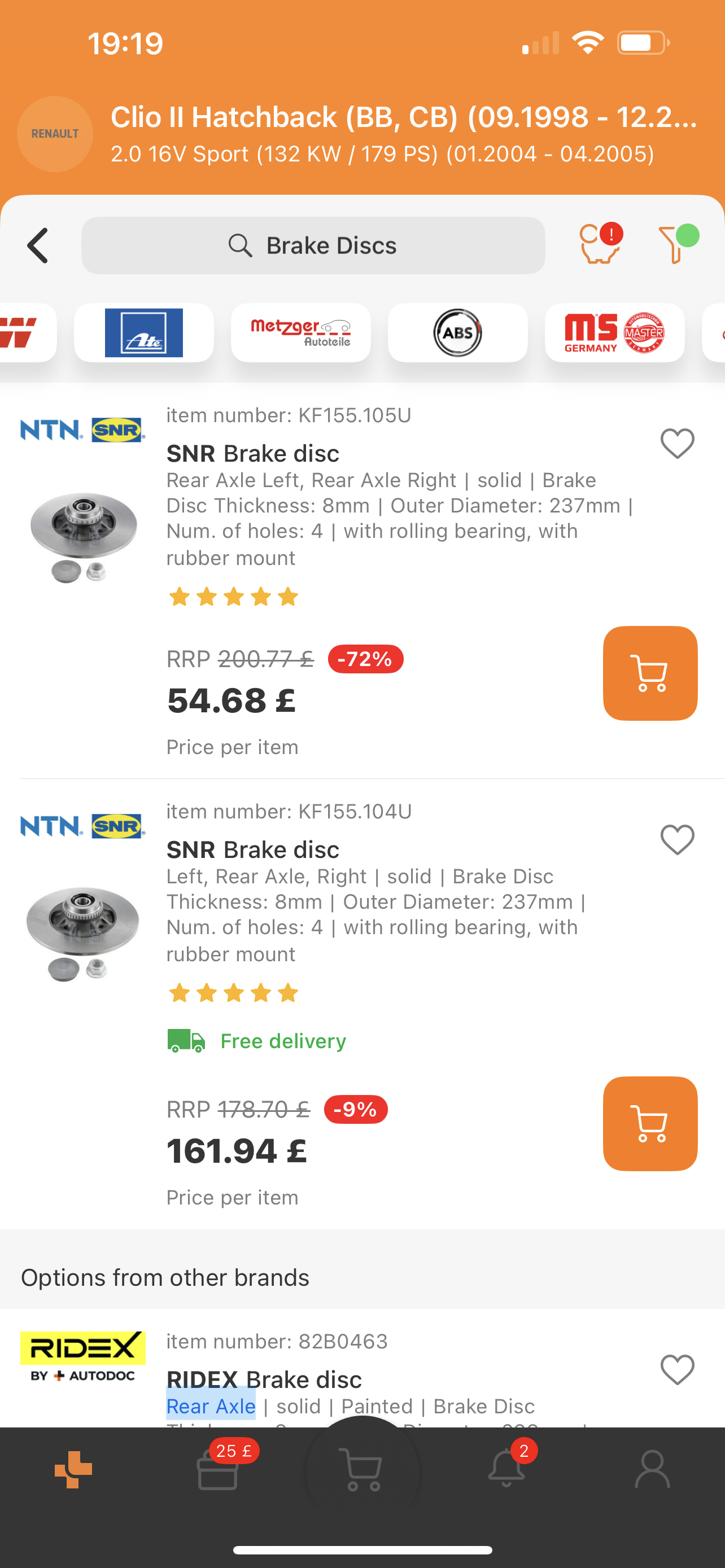

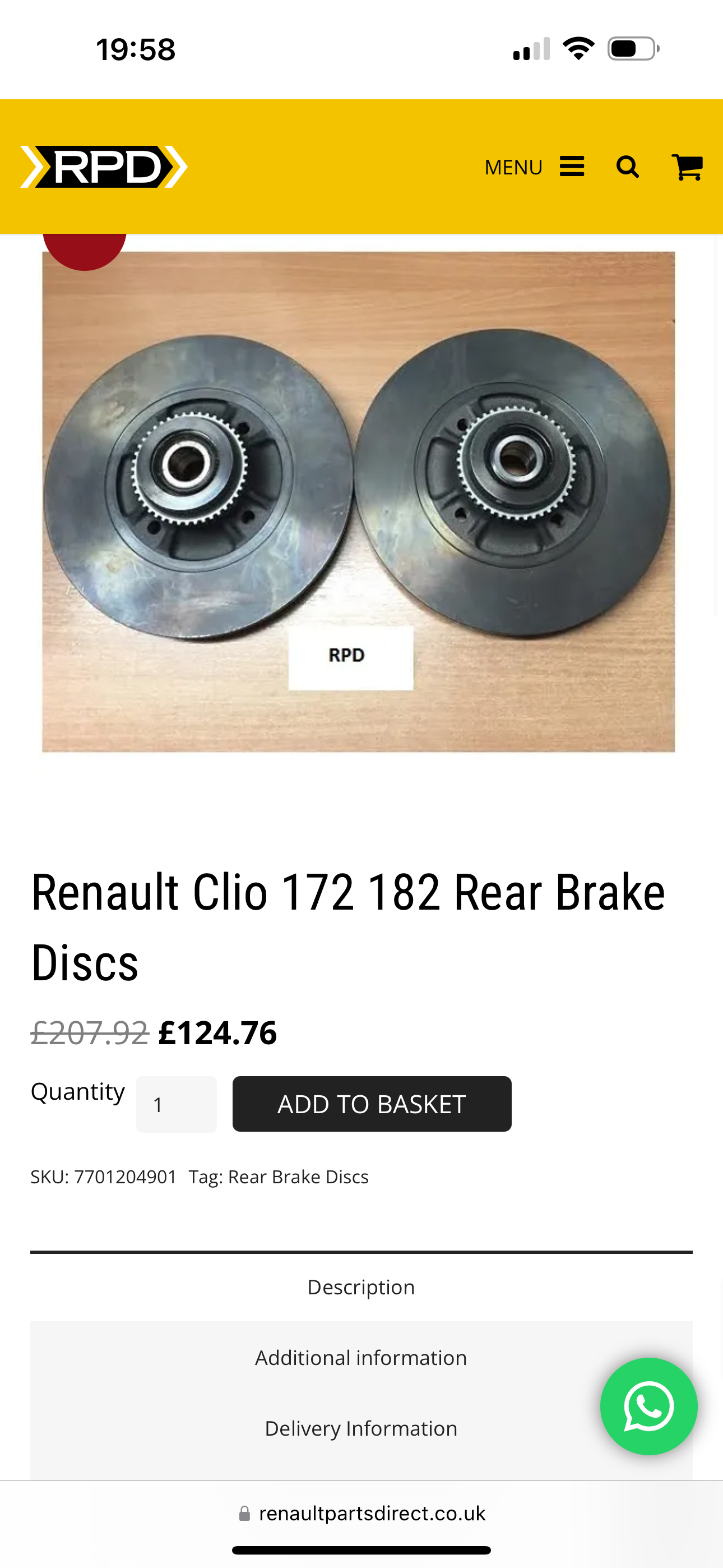

I think the noise is coming from the n/s/r so if so maybe it’s time to do the discs on both sides (I was thinking of this last week coincidentally) as I’ve read that the bearing come ready fitted in the disc.
You can buy the bearings as well though if discs are fine. Most garages would press it in for you for a drink I’d imagine.
Just more to go wrong. And they’re not expensive to replace the whole disc mate
No agreed. New disc is easier option but seem to remember prices have jumped recently? But then not bought any Clio parts for a while.
AUTODOC always makes my head hurt tbf
