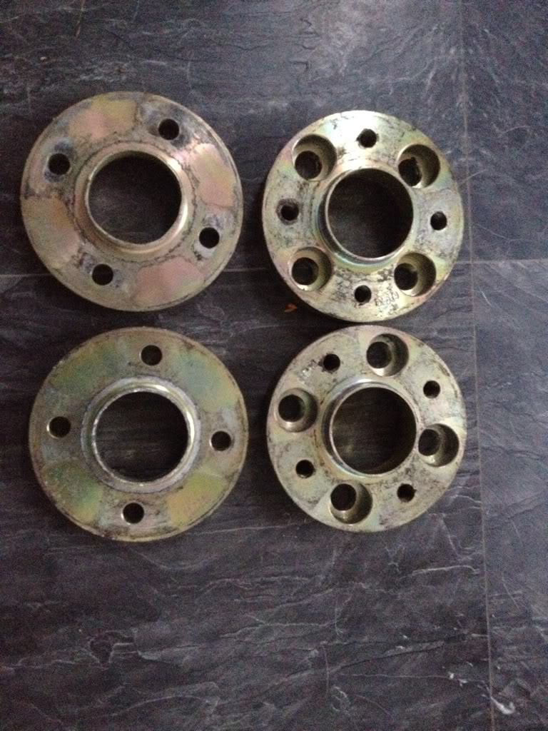

I bought some hubcentric spacers of here the other day pair of 25mm (front) and a pair of 15mm (back) all with bolts.. fitted them the other day all seemed fine few days later heard a noise coming from the wheel checked it and one of the front spacers was coming loose :/
it sits perfectly flush when fitting to the hub only thing i can think is the bolts arent the right size or are just sh*t..
also one of the rears doesnt seem to sit perfectly flush like a 2mm gap all around but the other one no problem at all
heres the spacers i bought

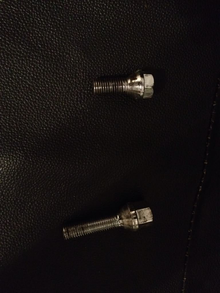

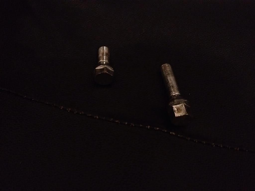

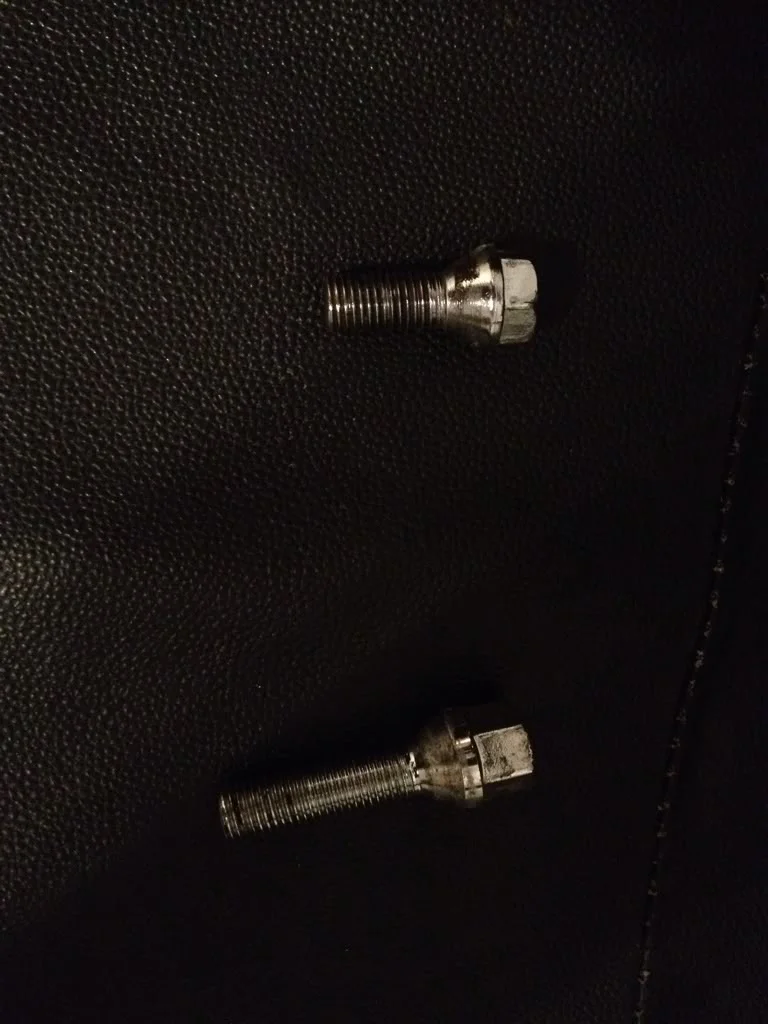

and these are the bolts that came with them 8 of both, they look cheap and shoddy to me but..
i dont really have a clue about spacers but should the 25mm fronts bolt to the hub with the smaller bolts i have then the original wheel nuts into the spacer, then the rears use the long bolts recieved to bolt through the wheel and spacer to the hub..

Don't waste your time trying to make them work. For 'fit and forget' spacers I'd invest in the FK/Eibach ones.
Delta Mics are horrendously heavy and when I fitted the ones I bought they stayed on the car less than an hour before I removed them.
I didn't trust the bolts and they caused big vibrations.
Don't waste your time trying to make them work. For 'fit and forget' spacers I'd invest in the FK/Eibach ones. Delta Mics are horrendously heavy and when I fitted the ones I bought they stayed on the car less than an hour before I removed them.
there off now and im going to order some new.. would you go for eibach or FK or isnt there any difference really
Really not any difference although you'll probably find the FK's are cheaper. I bought mine from Venom Motorsport. Im running 15mm FK's all round with a stud conversion. Are spot on.
