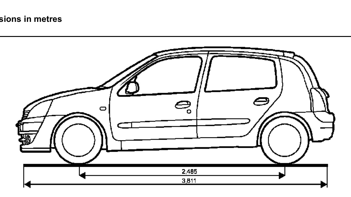

Any body know what the wheelbase is for a 172? Or able to have a measure?
I'm looking at a small trailer and my clio's at home.
Need to know the minimum width and length the trailer would need to be!
The trailer in question is 66" wide and 105" long! I could extend it slightly.
The only info I can find is the wheelbase is 2472mm which I guess is centres (length).
Thanks

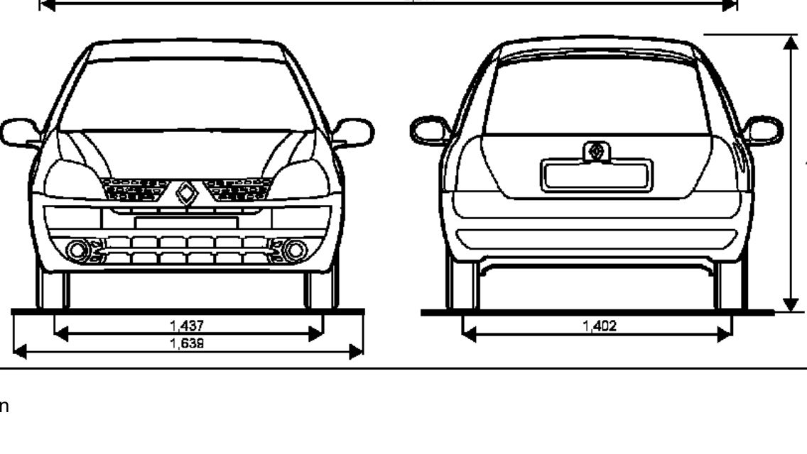

  172 Ph1
172 cup figures , so widest track
