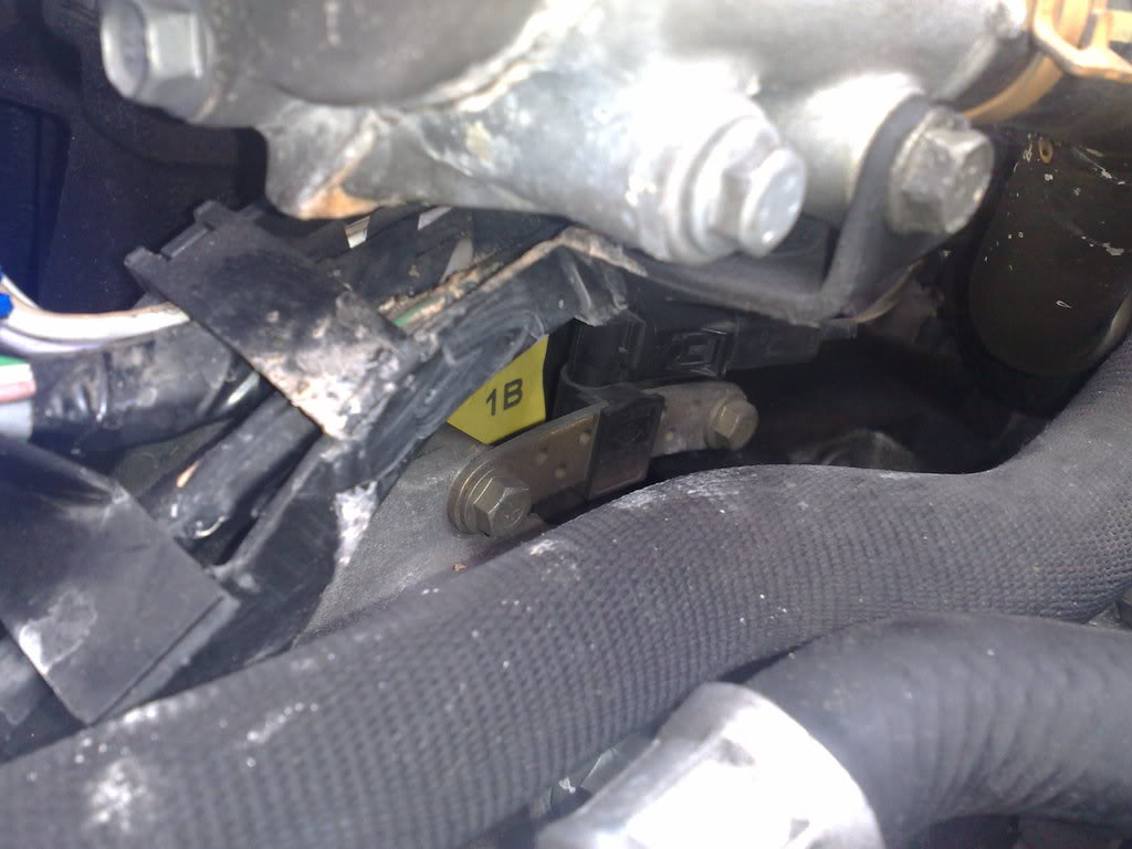

Think mine might need a change / clean but its pretty cramped in the engine and I couldn't see it.
A pic would be handy as I don't know my way around this engine yet.
Top of the gearbox bell housing.... 12 o'clock if you are looking from the end of the gearbox.
Here
