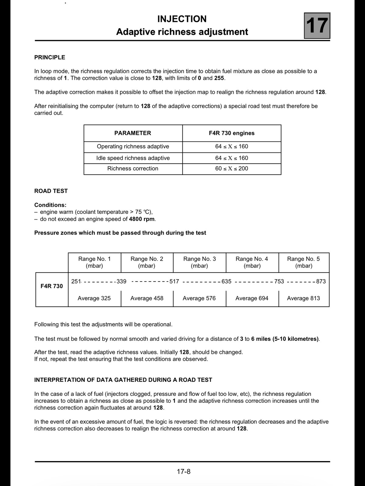

I dont have access to a 172 to put clip on at the moment, but i would bet the tech meant resetting the adaptive richness correction to reanlign it to around 128, and throttle position setting reset. In my experience, this makes quite a difference to the overall drive, as you need to do a road test running different throttle position/rpm for 6 or so miles at different load points/map sensor values.
If you have replaced throttle body, injectors etc it is worth doing. Even noticed a difference when doing it after fitting v6 airbox, as throttle seemed to be less responsive.
Not saying you cant get away with just plugging in the parts and it will be alright in most circumstances, but always best to do it, if you have access to the right gear.

Batt disconnect does not clear the adaptive settings. I had issues when replacing ecu and uch from another 172, throttle response was s**t, so had to reset it for good running.

Quick screengrab of a bit of the workshop manual. I too had people saying its not worth doing etc, but my 172 engine Kangoo idled a lot smoother than most, and mpg on cruise was always absolutely great.
