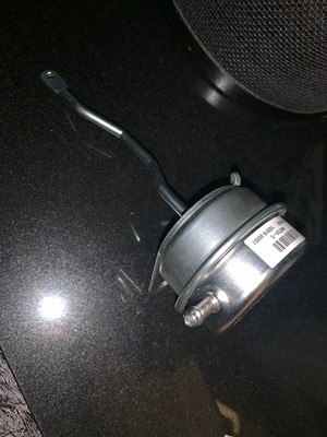

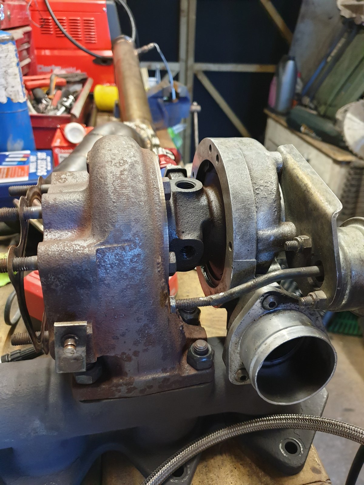

Hi I got a turbo kit last week Garrett gt2560r. Anyway I was mocking up on bench and noticed the oil feed pipe was just touching actuator arm so went to slacken adjuster just to move it round slightly to get clearance and the bas***d thing snapped so in nee of new one if any one can point me in the right direction
Thanks Dave

Thanks guys. The arm on that one in the link is a diffrent shape to the one I had. Will that one in the link fit ok?
The one you have currently isn’t the original. You have to clock the gt2560r compressor housing for the compressor outlet to clear the manifold. A t28 z style actuator should work. We are planning on flipping the last bend on the original actuator so it offsets 30mm.
