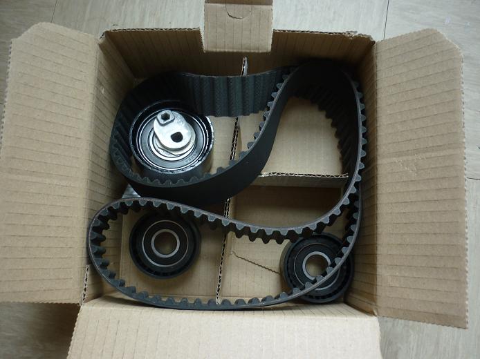

Ok so the mounts are covered, just bought a belt kit from Renault yesterday but again Im feeling like I havnt got all thats required ??

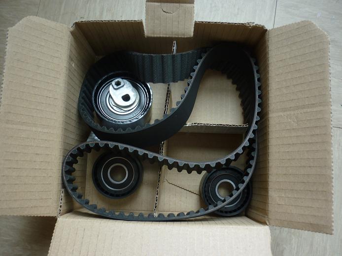

is your car the twin cam? if so your missing the cam blanking plates/plug things.
they are 2 black cap looking things one bigger then the other that go on the opposite side of the engine from the belt.

what engine do you have? is it a sport? if so its twin cam and the blanking plates are a must as they need to be removed to fit a cam locking tool for changing the belt, you can put the old ones back in but then its likely to leak oil down the side
