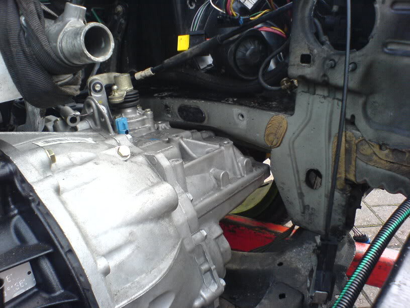

10min with a grinder and the ND0 fits in

Bloody close though, and was right it doesn't fit without mods. Plus what about mounts etc? Custom needed? JR5 stick and clutch pedal could be used for hydraulic clutch and cable shift?
