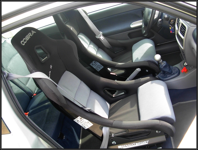

Bimarco Experts are a really nice SIMPLE bucket seat, look very similar to the Cobra Imolas, but MUCH cheaper.

I run normal seatbelts with my Bimarco without any problem.
It depends how high the seat side is - if the belt is held off you then not a good idea.
The other thing to consider is the pretensioner. If the belt lies across the two sides of bucket and the pretensioner fires it can inhibit its tightening effect or even worse snap the seat sides. We loose it completely with our frames, just fix a rear buckle through the 6mm thick plate that forms the side mount.
