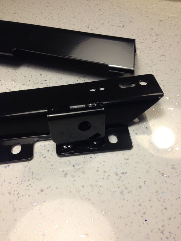

You can mount a wide range of seats onto my VBD Recaro adaptors.
These bolt straight to your existing sliders and allow aftermarket seats to be used.

As far as I know the only ones that my VBD Lowered Recaro adaptors fit are the standard CS without airbag
There isn't a way of altering the height.
You can use either my standard height or my lowered version

That seat will NOT fit.
They have all the Renault specific base on them which makes them sit super high.
My adaptors can only be used with the aftermarket Ines.
My lowered adaptors are 30mm lower than my standard.
Cheers

with this picture I have no idea how it is mounted or how it looks. I will get 2 Recaro CS and then report back. The quality of the work seems to be very good!
Can I increase the seat height with distances again when it is too low ?
