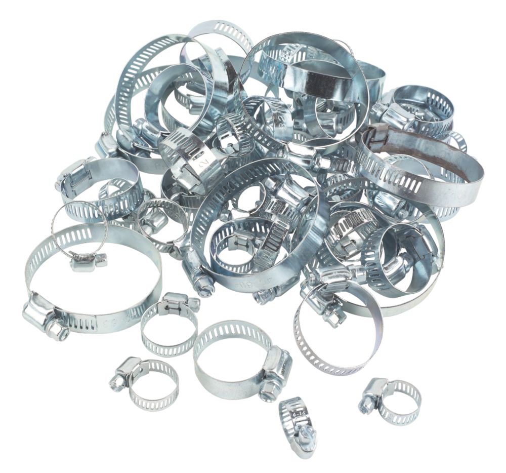

yes I used Mikalor on all hoses and did a trackday atAnglesey, one pipe started leaking when on track as they were not clamping the hose correctly messed my day up so changed all the clamps when I got back to normal jubilee clips.

These. Used them on my Clio years ago.
We used them down Portsmouth Dockyard to secure ducking round a pontoon that spends half its time under water and they are still perfect.
Not wanting anything that will dig into the pipes over time. That's why the JCS HI-GRIP are perfect as they're stamped and have a smooth inner edge.
