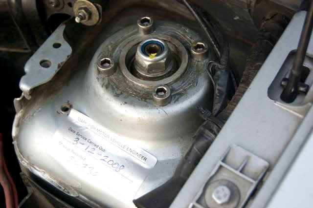

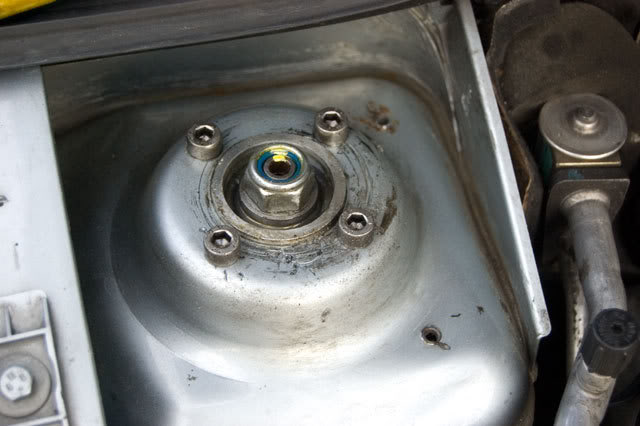

I've got a set of Mark Fish ones on mine with H&R's, not had any problems with them.
Here's a couple of pics (the damage on the top was caused while getting the seized CompBrake ones off)
