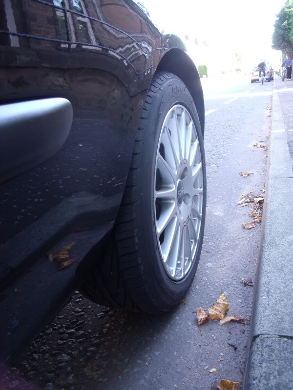

13mm rear with Eibach Sportlines:

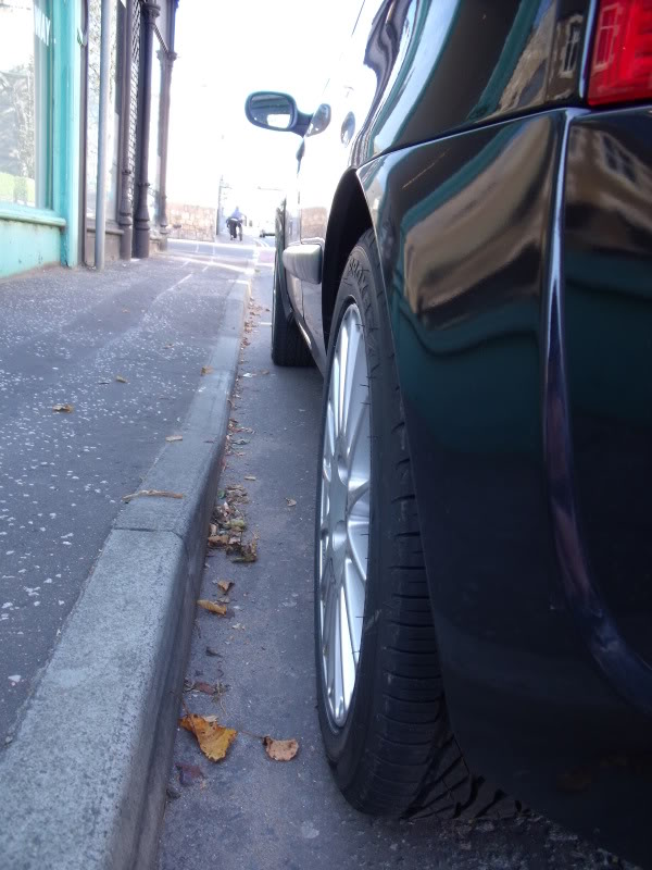

AND
8mm spacers with Vmaxx Coilovers:
Are the above wheels the same offset as the 172 alloys though? Because that'll affect how they sit out.

Yes they are. :)

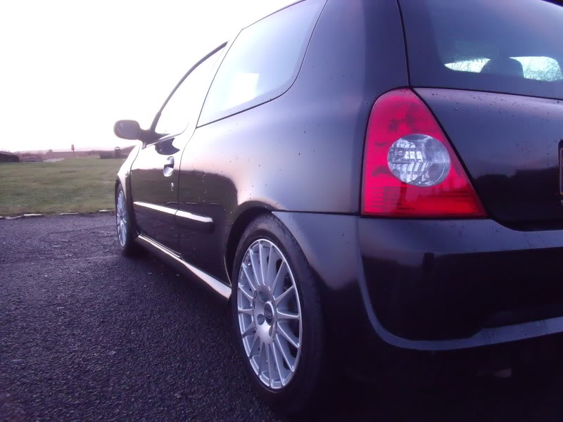

That's how mine sat. You can see the spacer in the pic, its the really shiny bit.
