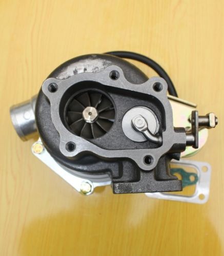

So done the usual on eBay but there’s a few to pick from and there anywhere from £115/160 or there abouts. So what I am asking is could someone give me a hand picking the best(correct one to fit the car) no doubt they will all fit and Ano there Chinese so I am not expecting a Garrett unit in any way just want the best Chinese replica one to pick from if that makes sense[emoji2955]. Or even if someone has one for sale or knows another site or a link please let me know.
So put a few links below. To add yes I know the 2871 might be a tad big but I just don’t have the funds at this moment in time to spend the money on mapping and a Garrett turbo but that’s not to say I won’t early next year.
So here they are.

Does your manifold take a T2 flange turbo?
What design is the turbo elbow? 5 bolt like the ones in the eBay adverts?
The Disco Potato should be alrite;
I can't remember if the S14 T28 is 4 bolt or 5 bolt elbow though, pretty sure it's 5-bolt but best double check.
If you're fitting a different sized turbo obviously you'll need to setup the boost control and get it mapped again.

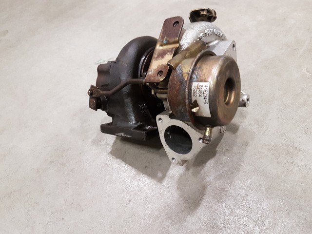

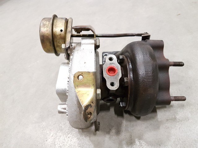

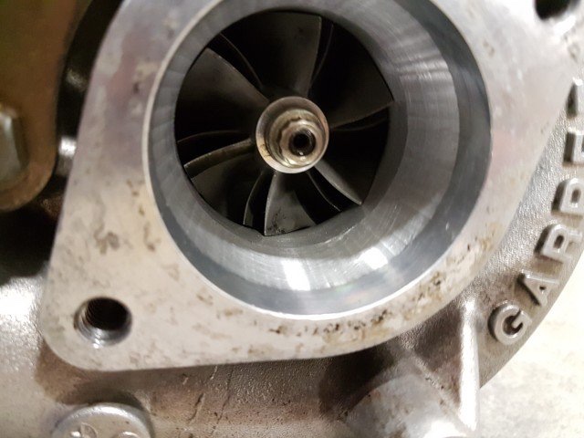

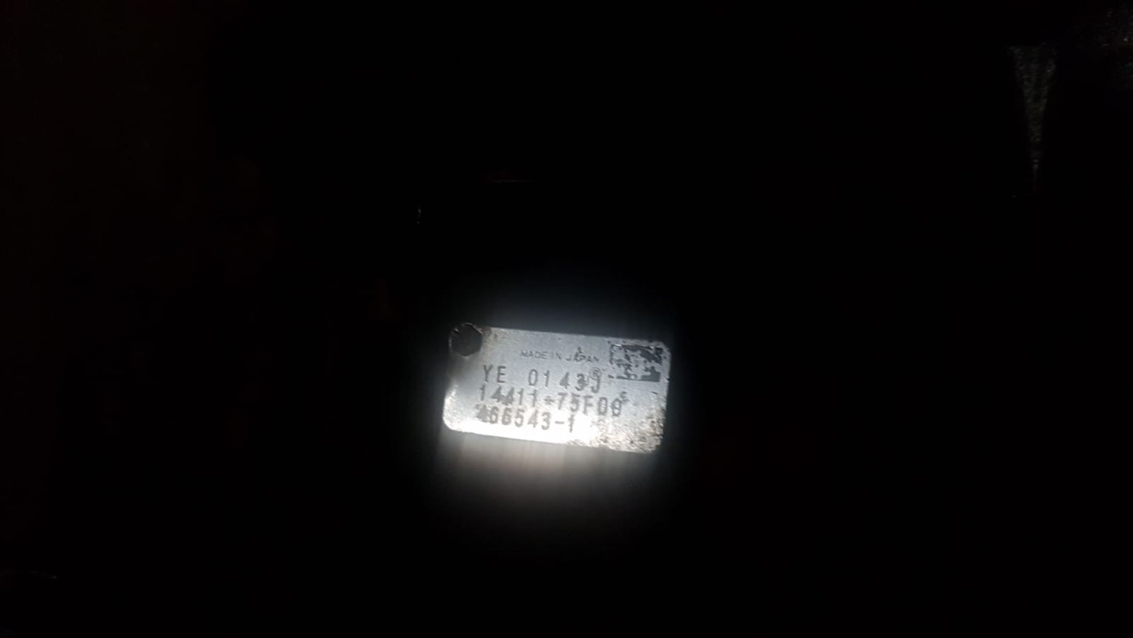

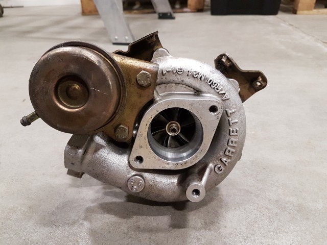

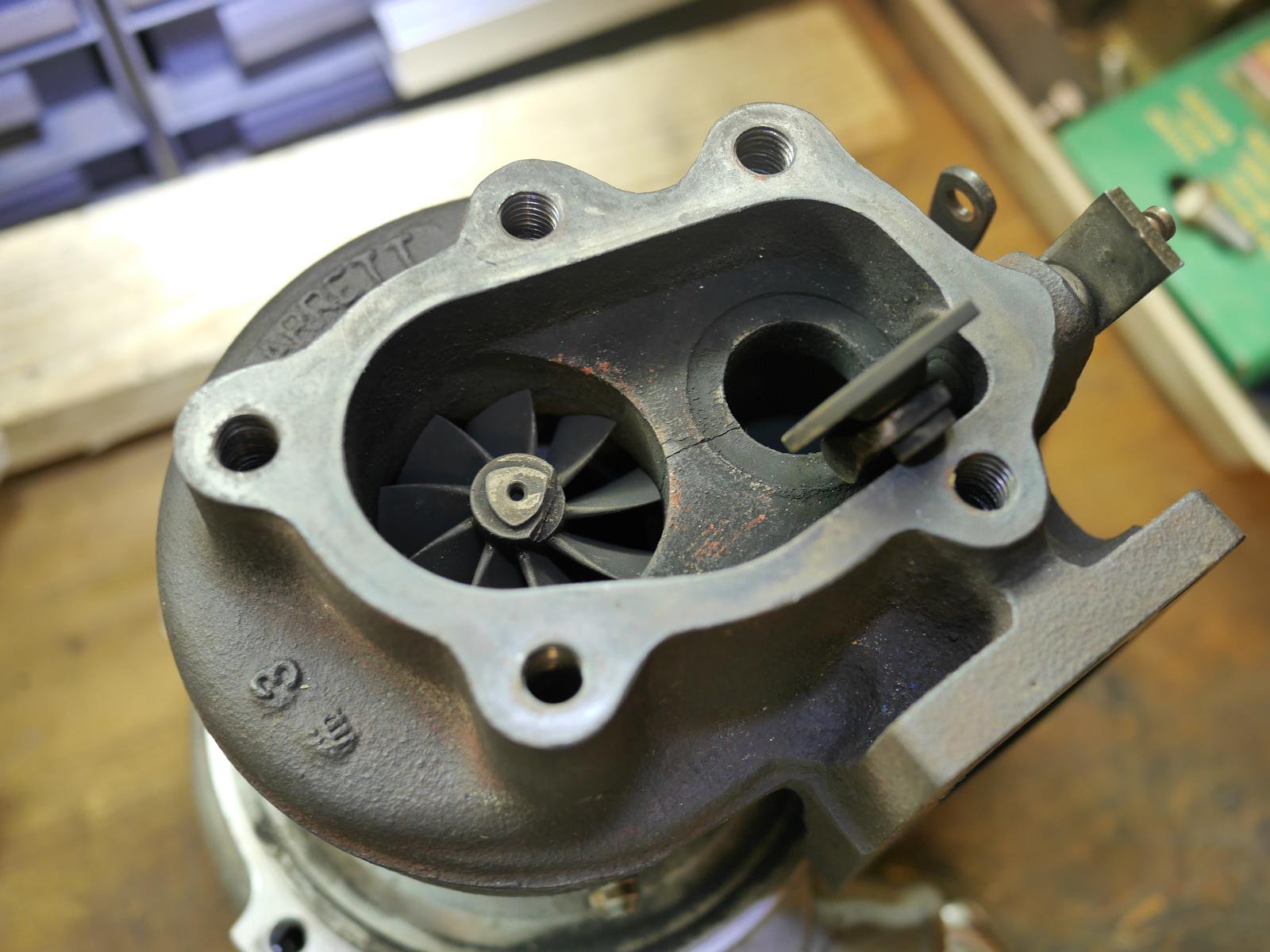

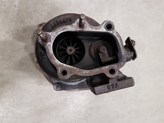

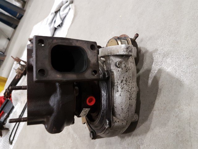

Finally found a new turbo got what I hope is a god deal from one of the chaps from drift-works it’s a Garret gt2860 from what I believe.anages to pick it up for £135 pics below[emoji51]
R3k1355
Absolute wetter.
It's got a tag and serial number, double check them cos the GT2560 and GT2860 look almost identical and people often get the two confused.

Will deffo need a map, the T28 is abit smaller than the 2871R (copy) you had been running.
On the SR20 engine these make 290-300bhp at full puff
Do you have an intake snout for it?

That looks a bit oily on the exhaust wheel from the pics mate, check that carefully it might be a smoker..
  Clio 172 ph2
The turbo is getting sent to bloke on here to get a look over so if it needs sorting he will let me know but still for £135 a good buy in my eyes lol

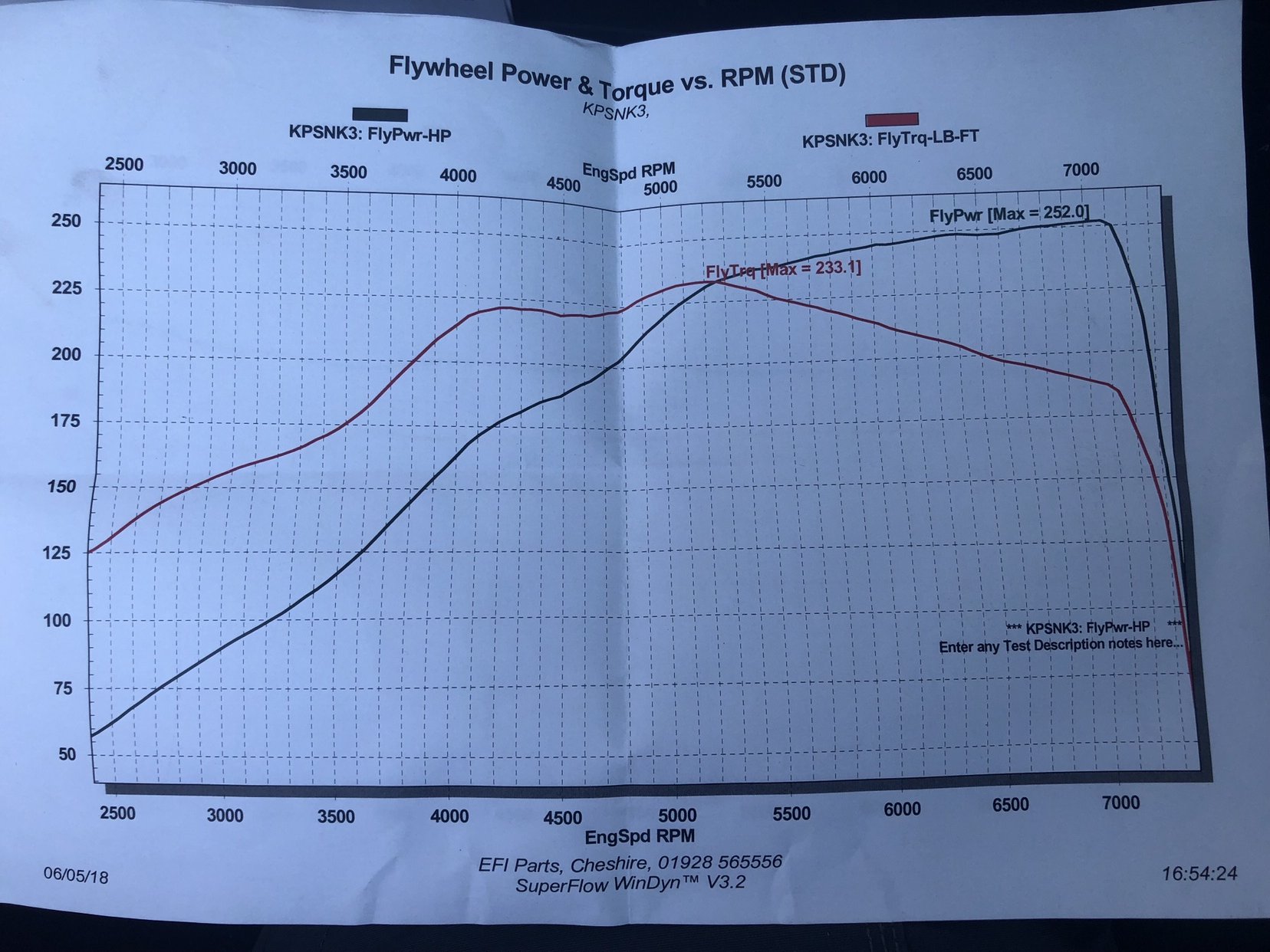

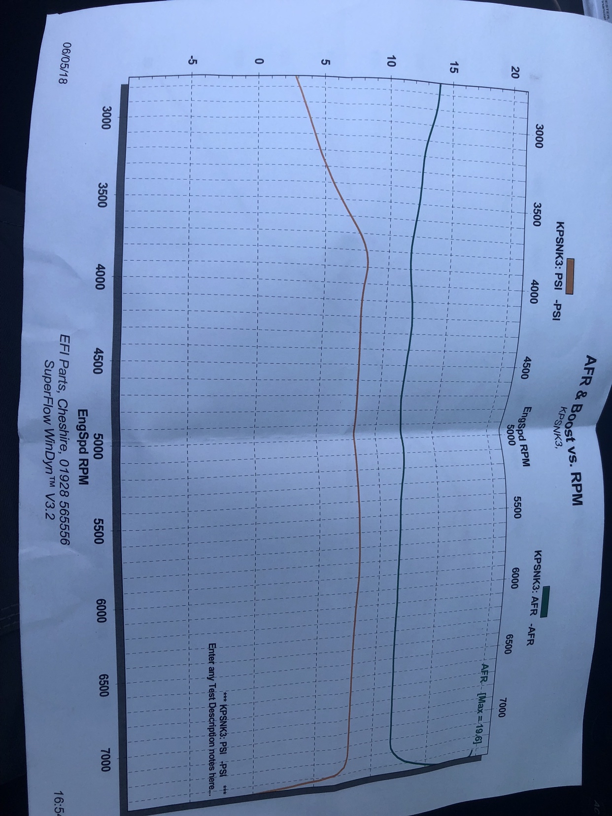

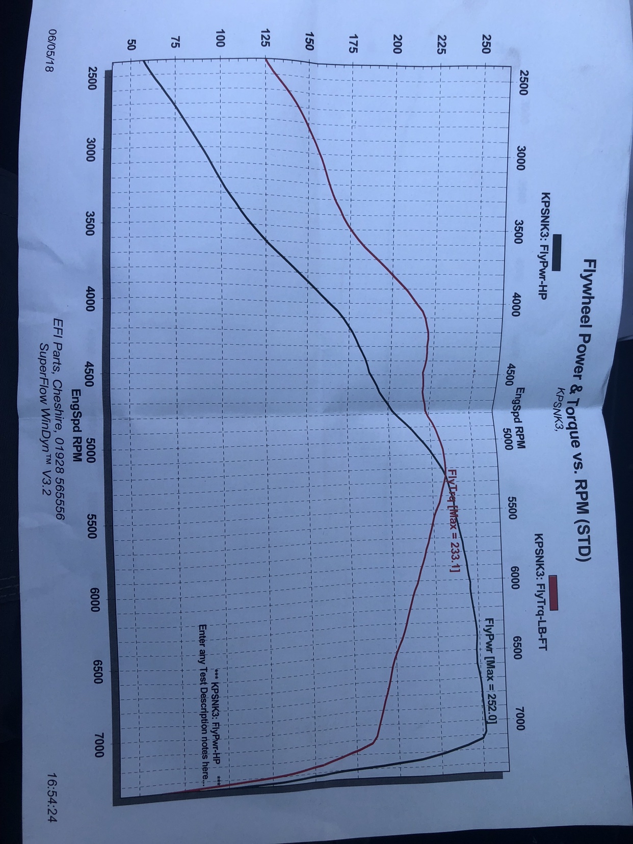

does the efi boost module have a boost solenoid and able to alter boost levels? or was you running 252 bhp on the wastegate pressure on that 2871 chinese turbo?
  182 Turbo
neat.
Garya88 do you have a dyno graph for that 252 bhp , im interested in how the powers delivered on the 2871 rep
  Clio 172 ph2
Pretty nice powerband actually, nothing to aggressive and quite linear almost like a very powerful n/a
Yeah was a joy to drive with that turbo to be honest never drove anything quite like it. It’s nothing like a n/a Clio 172/182 at all. Even the sound from it it’s not screaming at 7k. Very smooth power delivery but at the same time you can tell that it’s shifting.
Can’t wait to get this new turbo on then get it down to Chris for mapping.
Long term plans will be forged engine oil cooler full suspension set up. And try to make it lighter than it is lol. 300 is the aim tbh but with 252 it’s one hell of a car and it not much can touch it.
