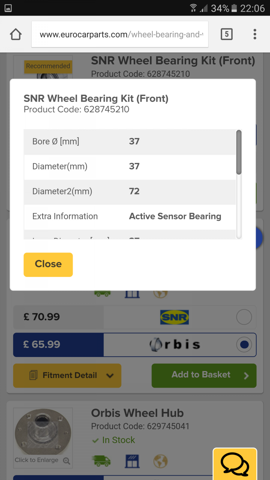

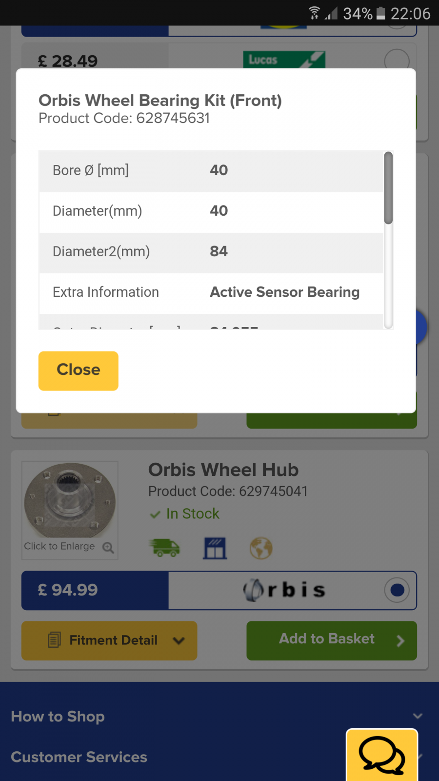

Hi, i hope this isnt a totally stupid question, but I need a wheel baring and there are two different types on EuroCarParts. How do i know which one to get? I searched with my reg. I've got a 2004 182
Theyre different sizes;

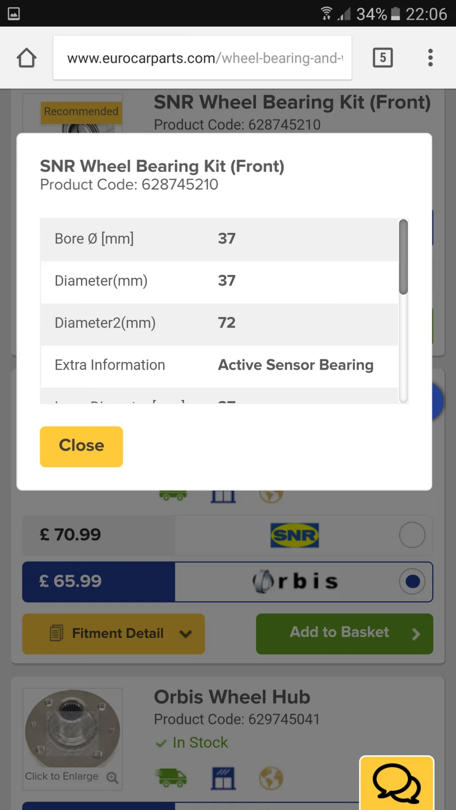

37x37x72 mate.
Measure it before fitting, I've had s 35x37x72 previously from a couple of places... Annoyingly I didn't check the depth before getting it pushed into the hub!!
don't bother with orbis. need to check if you've got cup suspension or not. measure bolt spacing on front uprights.
