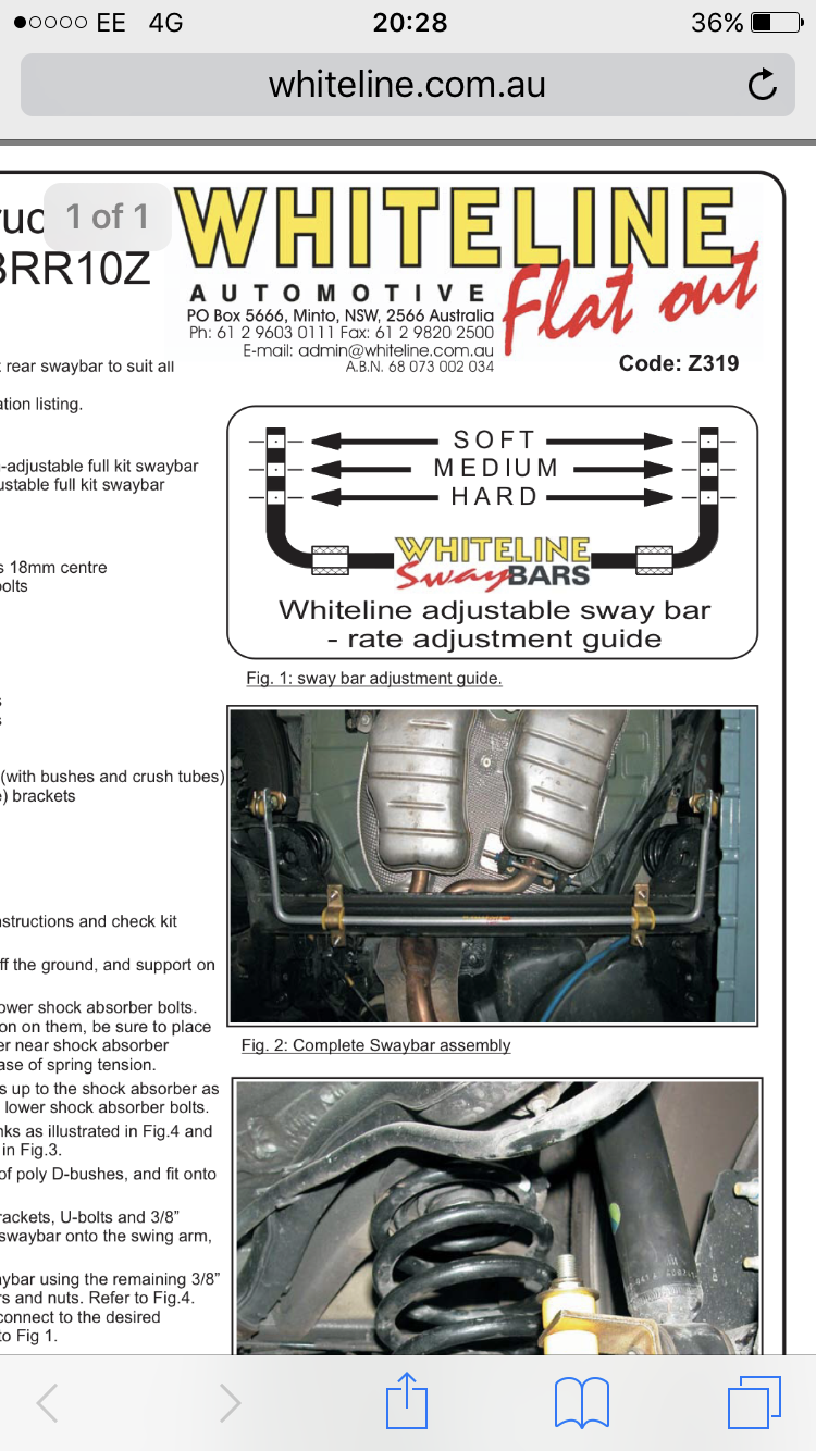

I don't mind being a tad more sensible in the wet if it greatly improved handling in the dryWhitelone used to be 3way adjustment, i had one on my old CUP 4yrs ago and that was 3 way.. improved the car loads in the dry but i found the back end awful when it was damp/wet so took it off and sold it
