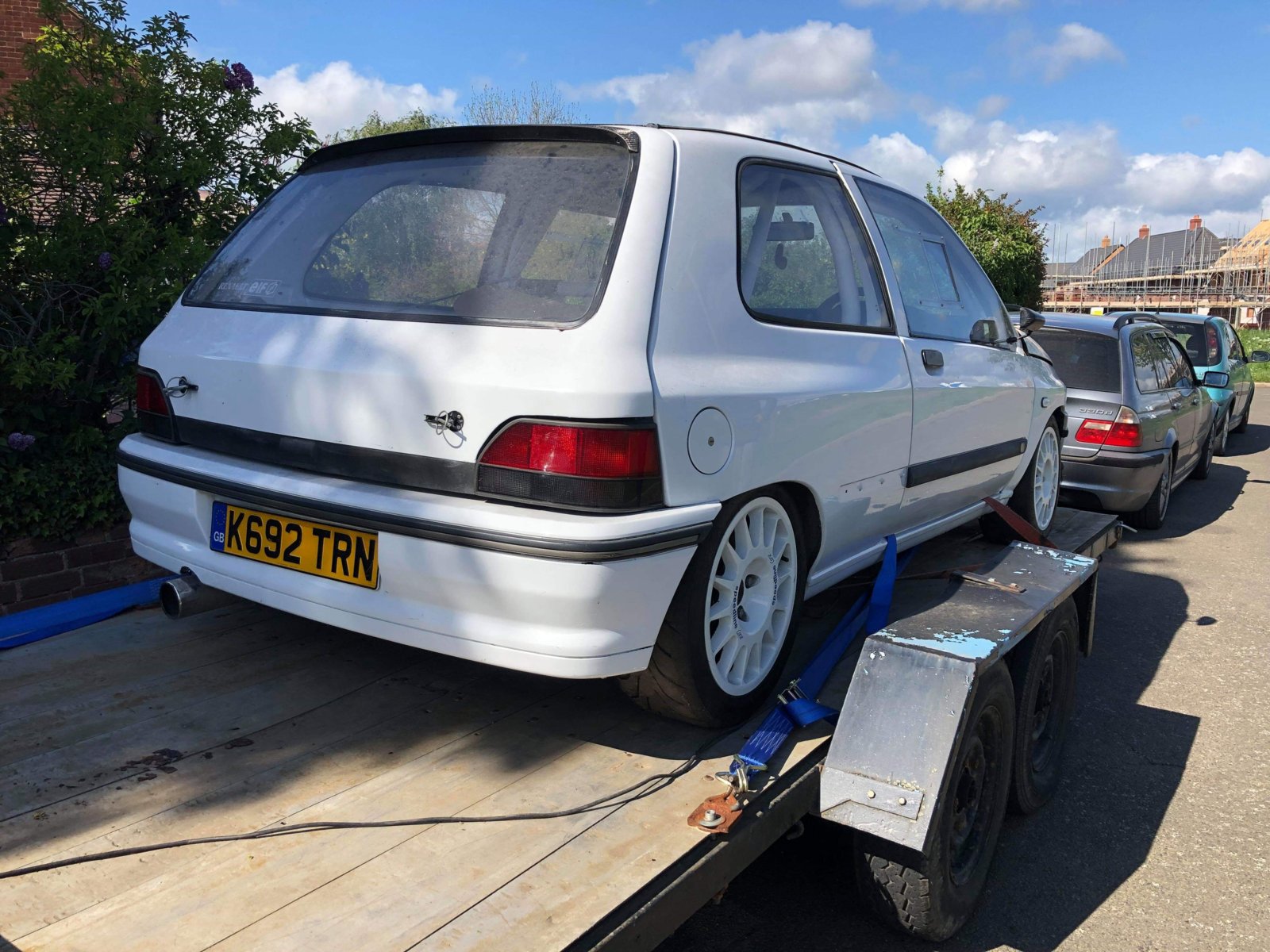

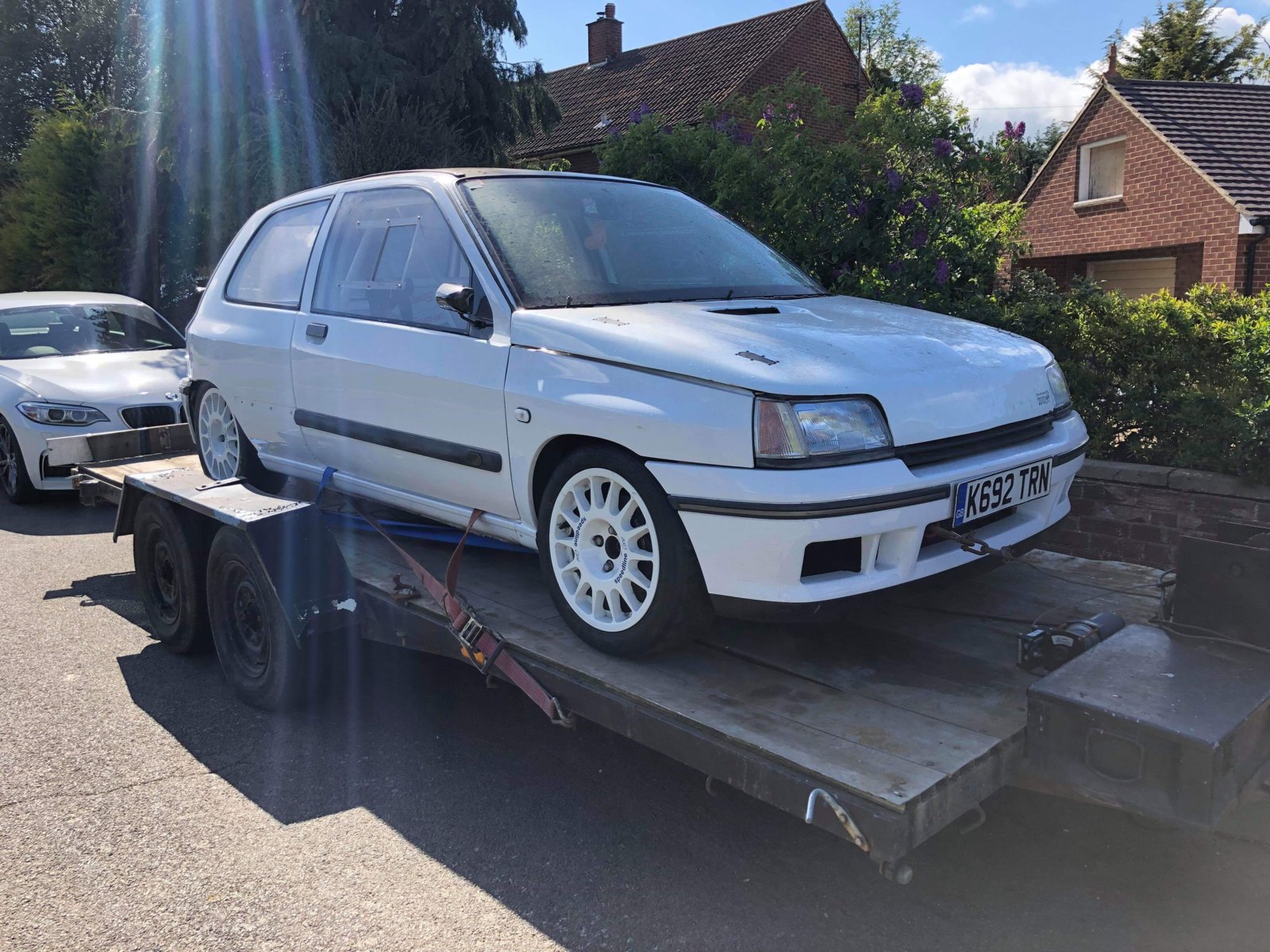

I'm sure many will recognise this car (Chris from beaniesports old car) , it came up for sale very local and me and my mate have always wanted a Mk1 so decided to go halves on the project.
Brought as a shell without an engine, fuel tank or seats and going to put all the spare parts we have laying about from messing around with mk2 clios to hopefully get this going in the next few months and take to some shows and do some track days in it.

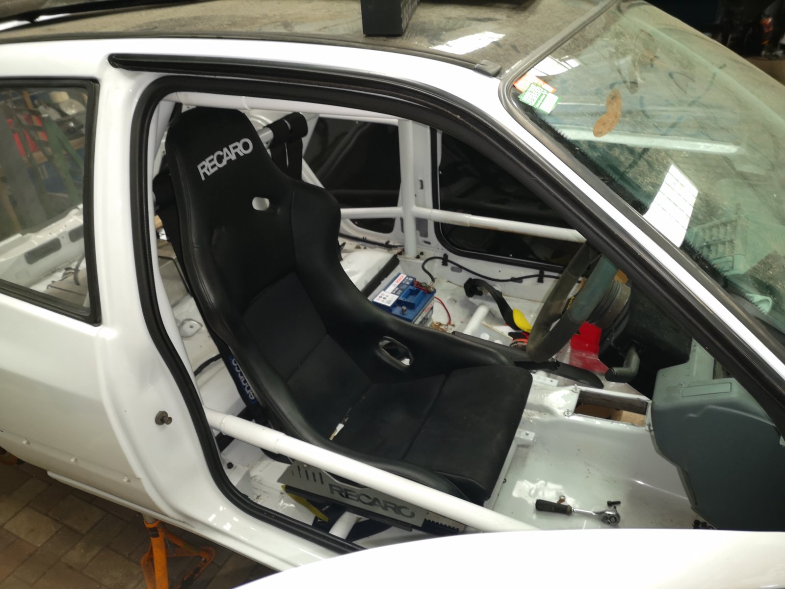

Trail fitted the recaro seat on rails to get the seating position further back (we're both over 6")

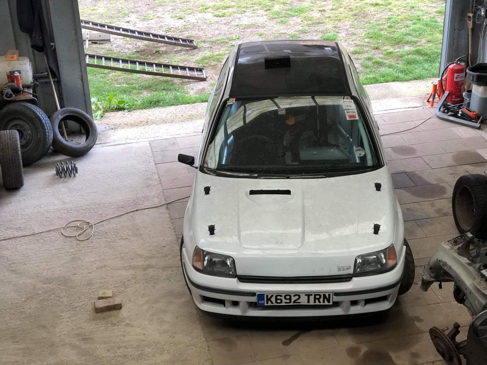

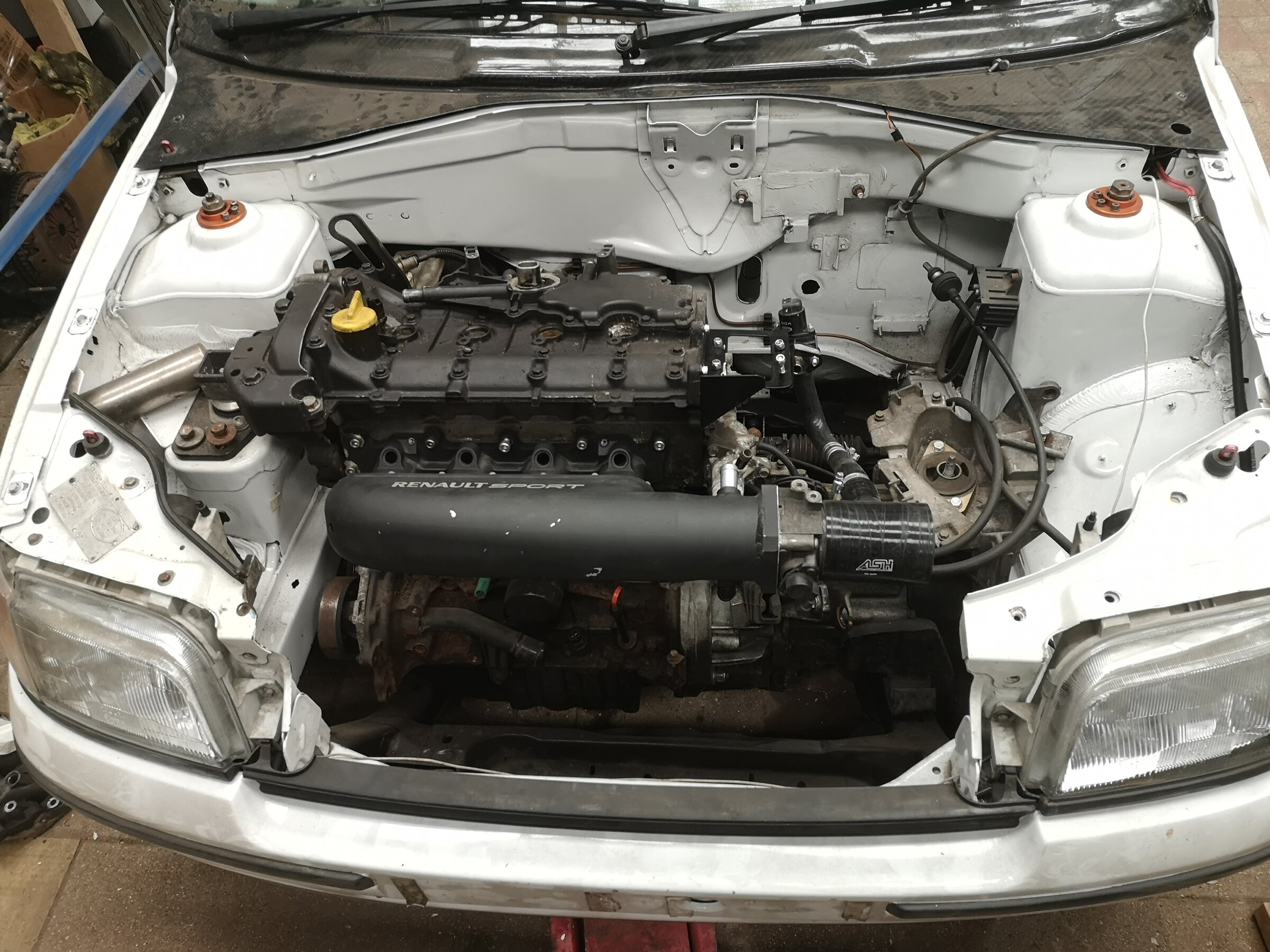

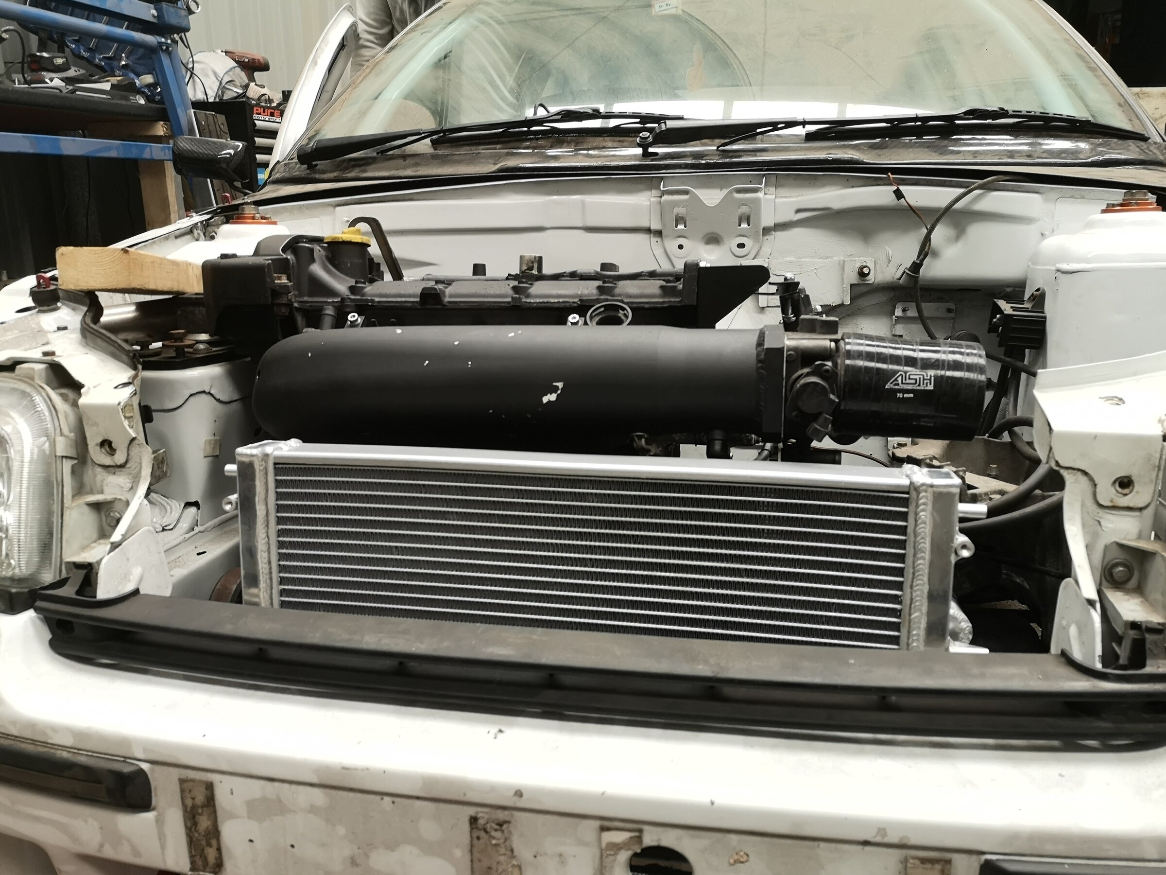

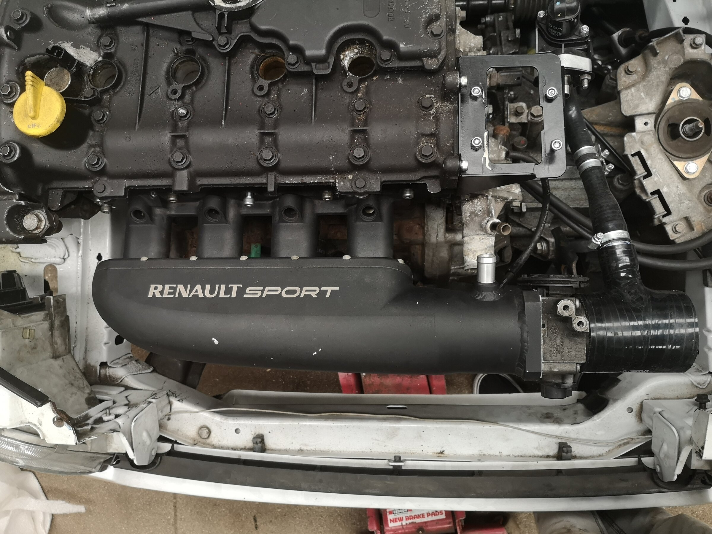

Wow can't belive we've had this over a year! Not a great deal has happened unfortunately! just haven't had the time but we've stripped all the underseal from the underneath and there are a few little patches to sort out but nothing major!
Got a 172 engine in and bolted up, couldn't get the bonnet to fit with a standard inlet which resulted in getting a SM inlet and some 197 cams and arp rod bolts.. Hopefully get near to 200bhp with megane injectors and running off the adaptronic ecu as the actual engine were going to use is coming out of my blue ph1 which is a very strong engine!
Also totally stripped it now so the dash board has gone and we've brought a race technology 2 dash which will interface with the ecu with minimal wiring.
Will also most likely get carried away and get a PDM for it to really cut down on the wiring.
Cars going into our new unit next weekend so progress should pick up abit in the next few months, but will most likely end up getting finished over the winter ready for some track days next year!
