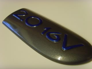

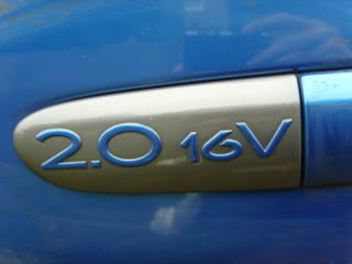

Mish has done a few.... I've done a few but I prefer doing them in the Summer as the paint and I prefer the conditions
Example of mine -
and a Set I did for another Member -
Example of mine -
Thats a nice job youve done there coby, just wondering hows the best way to paint the lettering? masking off as neatly as possible or with a steady hand and a brush? I sprayed mine completely silver a while back but wouldnt mine painting the lettering the colour of the car, justr wondered what the best tecnique is to do it.
Cheers.
Could you not just spray the whole thing the colour of the lettering, then when dry, mask over the letters and spray the background. Painting by hand wouldn't look the best.
All over Spray of Background Colour and a Tiny Art Brush is my Technique.... Patience is the Key
Primer x2/3 - Leave a Day
Background Colour x3 - Leave a Day
Latters x 1 Good Coat - Leave 2 Days
Lacquer x4/5 Light Coats - Leave 2 Days
Fit.... DONE!!
exactly as "clio-coby" has said, best way, and good results, realy isnt worth tryin to mask up and do them that way. just a fine paint brush, local art shop will have a few. Steady hand, and away you go. Just a job to be patient and not rush, otherwise the results will be sh** to say the least.
