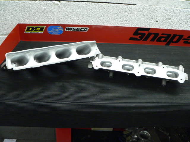

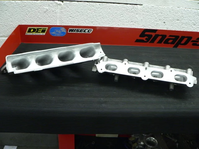

the plenham/manifold is drastically moddified!
look

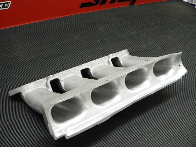

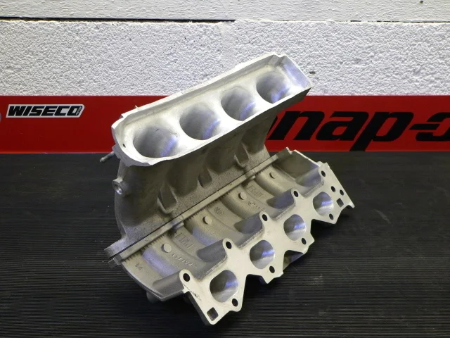

The stage 2 manifold is a frankenstein unit!

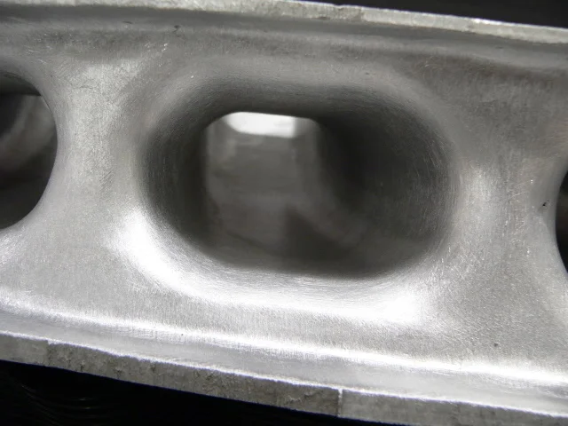

It is cut open and welded up to the hilt to fill the plenham, then i spend far too many of my hours grinding and grinding, shaping and smoothing to make the entries as efficient as they can be within the space available.
Then the FULL runners are reworked, opened up, reshaped, matched and flow substantially more than any std type inlet ever done.
Took a long time and was alot of work, so if anybody wants it being done again, it will require alot of pestering lol.
