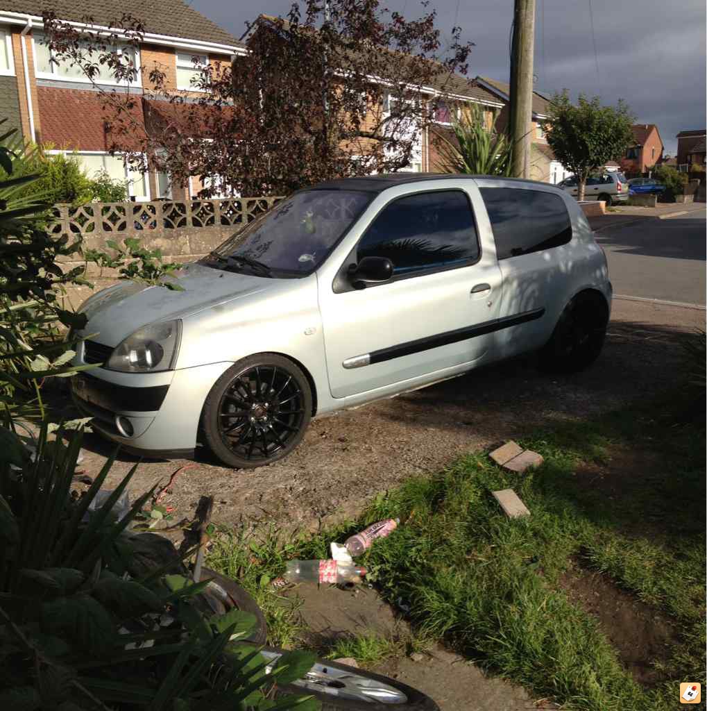

  PB Clio 172
yeah I agree with that just things on CS sometimes get taken as general facts
i.e 17's look gash, 17's wont fit, 17's wreck arch liners, 17's are expensive, 17's handle crap etc.
of course 17's are 'more likely to rub' yes its common sense. But a normal 1*2 you can lower it and 17's will be fine

I remember those days...
my 'random' wheels came from Wheelbase, get the correct fitment, offset etc. and Bobs your uncle
of course buying random 17's off e bay is asking for trouble

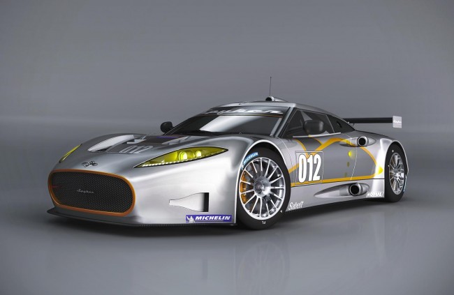

FFS Chip.
As it happens, F1 teams dont want to go up to 18s, as it will mean a whole new suspension philosophy as 90% of their compliance would be lost.
But, back to the point, massive wheels are great for concept cars.
concept.
