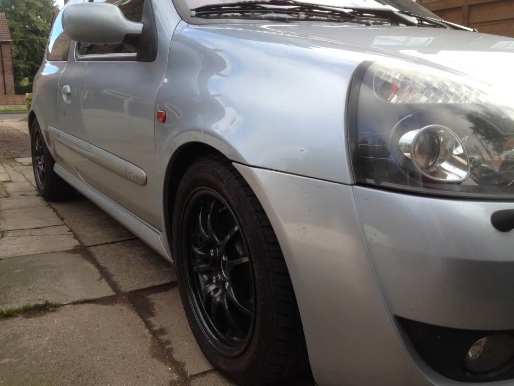

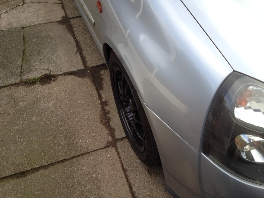

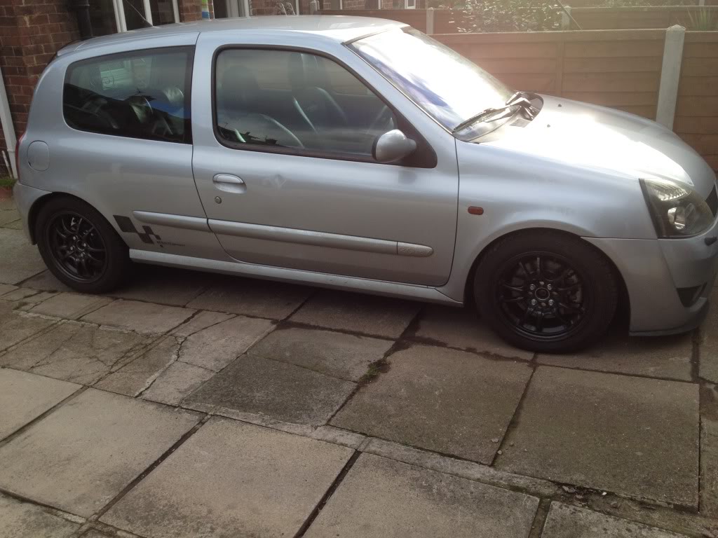

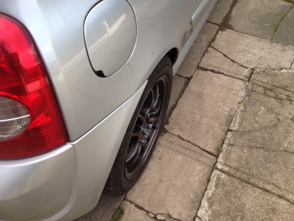

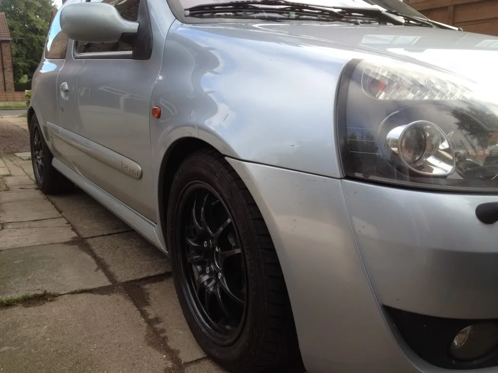

Well I've fitted my spacers/wheels and all is ok, no obvious rubbing or problems and drive ok, but haven't been far or long enough to fully test but I'm pretty confident it's ok.
And my god the 172 wheels weigh a bloody ton.
Few pics
As you know the stock wheels sit in quite far, so I'm pleased with how it's turned out, just right IMO.
